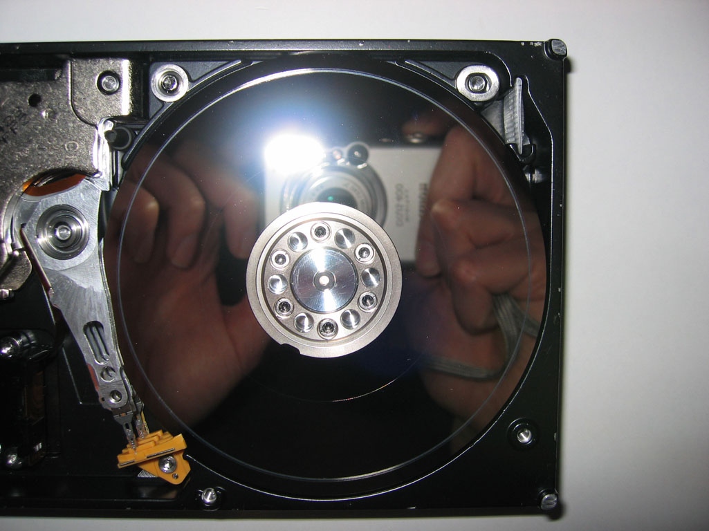

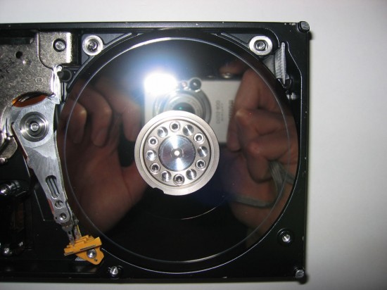

Ok I’ll get straight to the point.
We normally do PC repairs and don’t really know anything about hard drives other than the right ones to choose etc .
So when this came in with two scratches on the platter, I started searching the net for advice.
Is there anybody out there willing to have a go at recovering this for me? Ideally we need the whole drive imaging minus the scratched areas of course......
The customer told me it was dropped while running. He took the lid off and on seeing the scratches, decided to bring it to me. He’s a good customer of ours so I said I’d get some advice for him.
My concern is where you will get the parts from. Searching this forum I see somebody has already tried to obtain this same model of drive without success. Is there a shortage of spares?
He is cagey on the budget. He just said that I was to get some prices and let him know.
WD2500AAJS-41RYA0 250GB

There is always a chance to recover big chunk of data from such drive.
How much dust is on that white filter in top-right conner of that drive?

well looks like big problems, with that head crash could be dust inside HDA, from a MR Sensor crashed wich could be dirty all platters, check dust, inside, if has , wich surely has and would be magnetic dust, could be unrecoverable unfortunely ,

I pulled the filter at the time and it's clean so far as I can tell. Looking around the forum I see drives that have very deep scratches on them. The scratches on this are not very deep. In fact the inner mark was quite difficult to photograph as it was so fine.
I don't know anything about SA apart from it being either on the outside or inside. I can't imagine the SA uses much room on the disc surface and given that the drive was running at the time, maybe this area escaped damage?

For me: drive opened - alignmemt needed - scratches - other intervention needed : it is in the 2500$ range. And no guarantee to recover everything.

In the hands of a Pro and from what can be seen in the photo, and forgetting the posibility of more media damage on the unseen sides of the platter, what are the percentage chances of a successful recovery?
Also if there really is more unseen damage how might that affect the chances of a successful recovery in percentage terms?

Problem 1: Hard disk opened by customer under unknown conditions.
Problem 2: Top platter is badly scored.
Problem 3: Photographer is not wearing gloves, so further contamination will have occurred during photo session.
If your customer needs this data then give this to someone that knows what they are doing.
BlackST is correct. We will help you, but will will not disclose proprietry information or procedures.
There are places where you can go on courses, but what is needed here takes years of training and experience to accomplish without breaking into a sweat.
