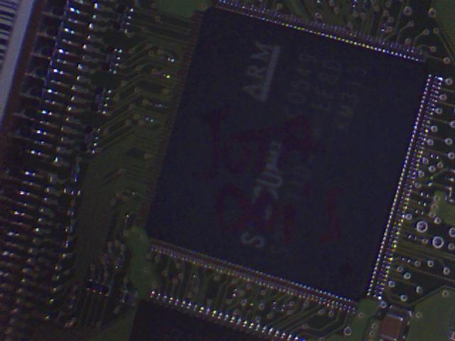

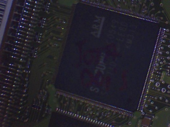

 Post subject: Re: SANSUNG SP0822N
PostPosted: October 22nd, 2008, 18:40
It is in BOOTCODE !! Likely, Rom code invalid or Mcu/ram failure - Check with another PCB same model same FW - is it Tk100/TK200 ?
PostPosted: October 23rd, 2008, 20:11
Joined: June 7th, 2008, 16:08
Posts: 39
Location: Brasil
Neither of the two TK this hard disk is manufactured in Korea I am sending a picture of the main chip starting to believe that being hard disk False
