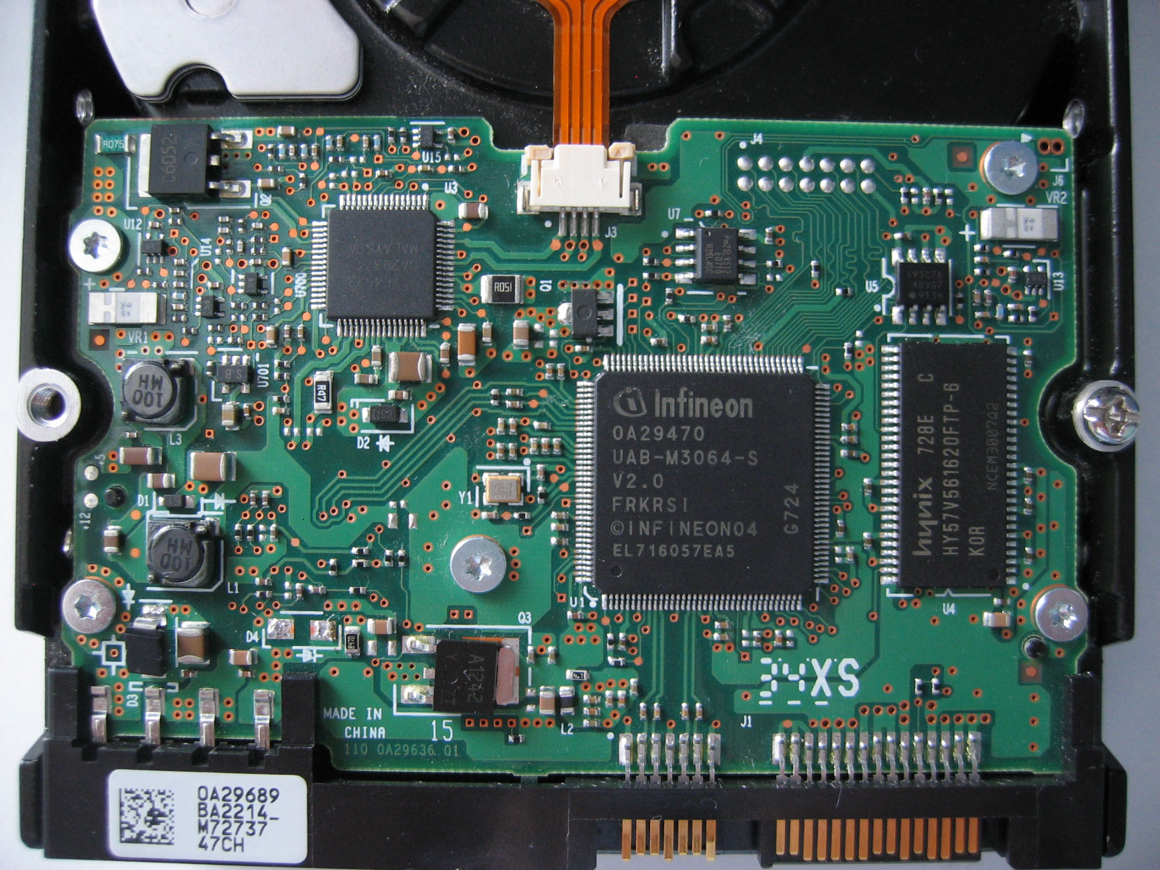

Hi
Can anyone tell me the location of the Nvram and Rom chip on this board. I know what I think but thinking isn't good enough; I want to know :wink:
Drive is a Hitachi HDS721010KLA330 1TB

U7 - ROM
U5- NVRAM
and somebody did try to fix that PCB :)

Certainly looks like it. One TVS/diode removed, another one played with!

I know the history of the board. The missing TVS was pretty much blown in half, the other has just been lifted. I know a soldering pro who's got all the hot air stations and stuff. We are going to move these chips to an identical donor board that I have already obtained. The data is not that important so we may as well have a go.
