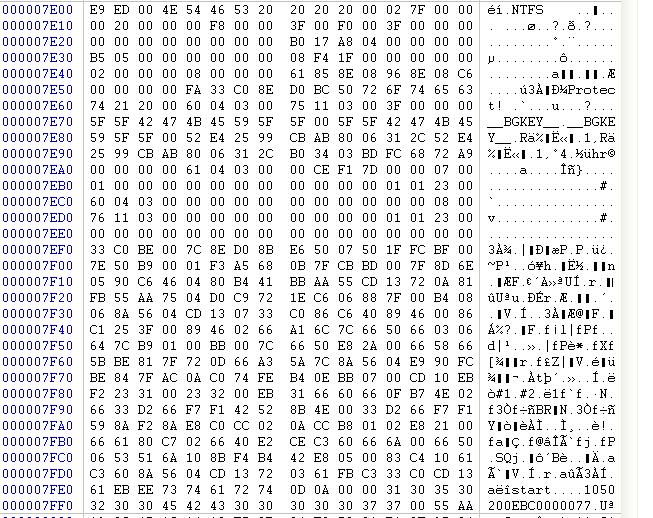

 Post subject: Re: PGP imaged data locked by password
PostPosted: December 5th, 2008, 22:01
Joined: October 6th, 2005, 3:00
Posts: 657
i got the same with TerraNove
here is the 3FH
maybe somebody have an idea..
Спасибо
СУТИОНО / АПИНГ
PostPosted: December 6th, 2008, 4:22
Really sure? Pgp is documented. Oh, by the way, quad core pcs are cheaper today, so... (it is a clue)

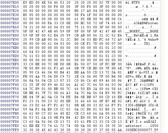

PostPosted: December 6th, 2008, 7:56
Posts: 791
I think this is pointsec rather than PGP the _BGKEY_ signature indicates this.
You will need to get a boot floppy from the customer with the key. When you run this you will be asked for a login and password and then a final confirmation. then the drive will decrpyt..
pointsec T Support are usually very good and will explain how it is done. But you will need the boot floppy from the customer. Pointsec uses AES (probably 256).
https://www.mjm.co.uk/
