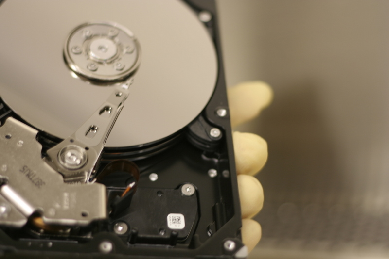

I have one of these drives and after unscrewing two screws on the preamp module it wouldn't budge.
I see that the flexible cable appears to be loosely connected.
What is the trick to removing MHA on this drive? Is it to remove the flexible cable from the black base?
I attached a picture where you can see 2 screws (and those damned plastic spacers...) and the triangle connector. Is there a screw under the barcode sticker?
Thanks :)

I would recommend removing the PCB first. There is a screw from the other side that attaches the connector through the PCB. Then there is a rubber seal that is a little difficult to get off but isn't too bad.

Yes u need to remove screw under the PCB from the preamp flex cable to the PCB, if u dont do that and tried to lift up, could broken up

Thanks for the advice! These things are like puzzle boxes with such gems as my "beloved" T6 screw on the side of a Hitachi headstack next to a powerful magnet. I will look into this further tomorrow. I am familiar with other species of Seagate, but not with this particular one. I already saved its firmware (for the most part, 2 modules unreadable, donor's firmware is perfect, of course), dumped its ROM, identified the cause as potentially bad heads, and see no scratches on the surface or any traces in the filter. Should be a fairly simple 6-head MHA swap. It's part of an external RAID0 stripe, so the donor is identical in every way.
I had a choice - take one of my working 7200.10 drives apart to figure out how to remove the preamp module or ask the experts who have already done that. Thanks for the help. :)
