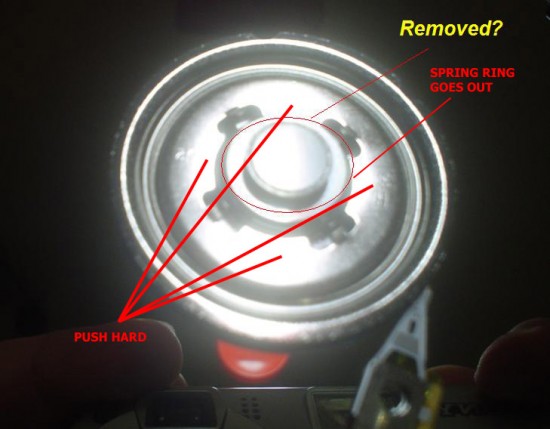

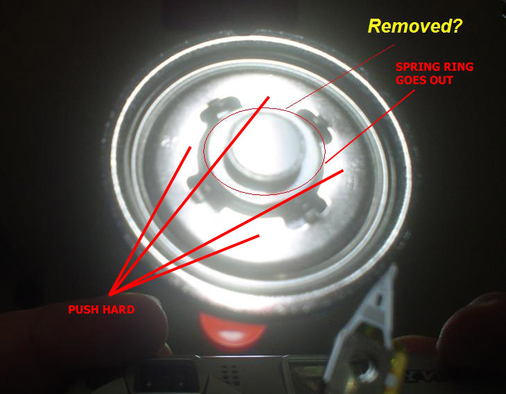

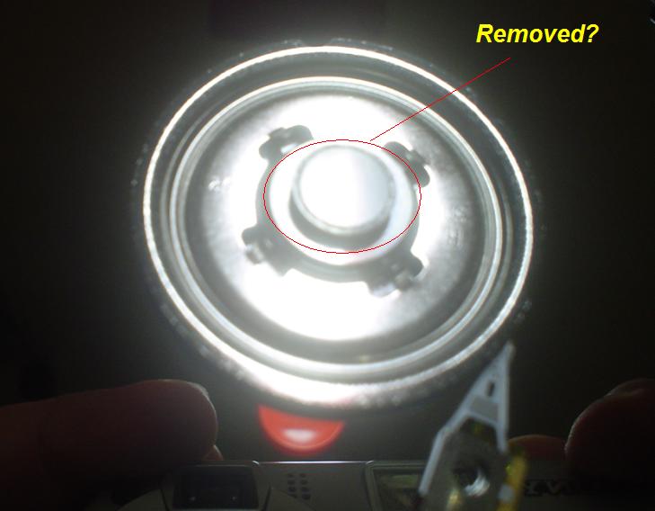

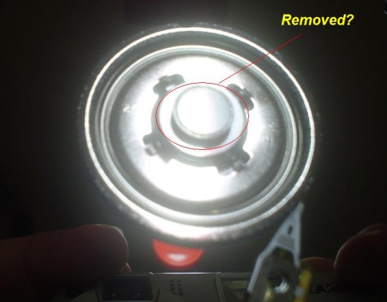

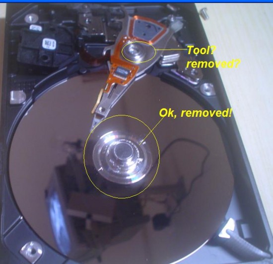

My hdd blocked motor.
pcb ok, stopped engine. How I can unlocks it in this model? therefore and different of all others that I unlocked

If you want that kind of sex - see picture :mrgreen:
I go to make with informed!
Thanks!! :mrgreen:
Platter swap? :shock:
me it seems almost impossible….
Case yes as to make? e later as to fix new platter in hdd?
PM....

sempre wrote:
PM....

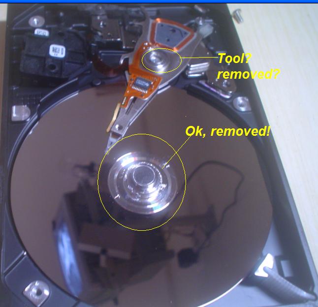

TRAINING....

lift HSA up it's not fastened
ok, platter removed!!
PM

Data Recovery Sucess!!!
:mrgreen: :mrgreen:
Thanks all helps!!
