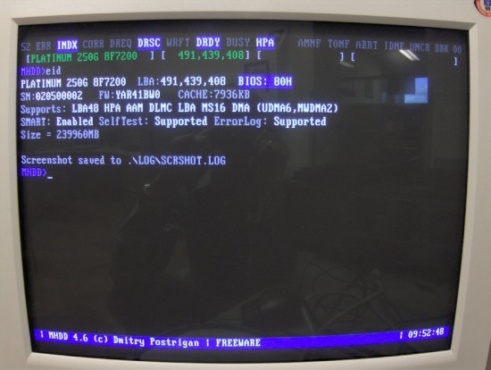

I run MHDD, and it gave me the same error all the way through - >500ms.
I IDed it, and the only additional info was
SN 020500002
BIOS 80H
Any ideas?
Thanks.

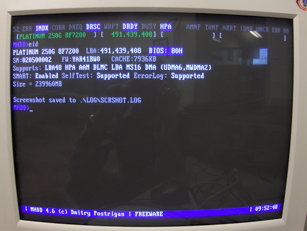

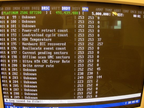

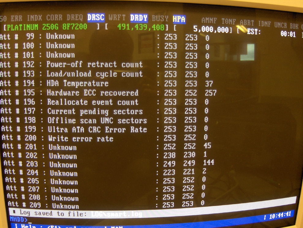

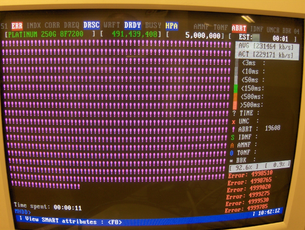

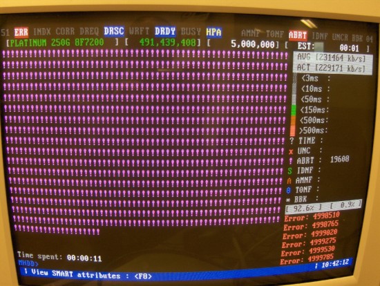

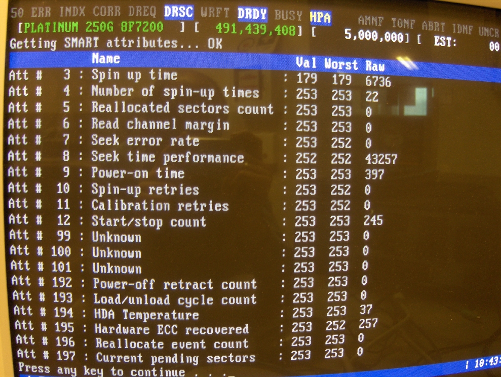

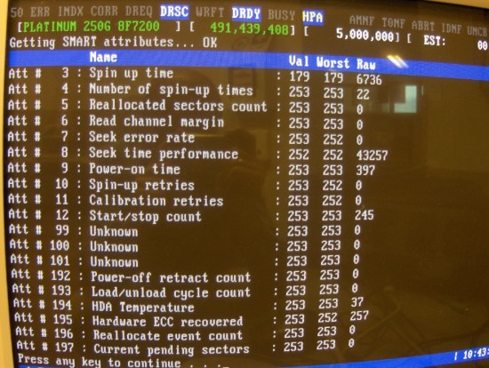

As requested, I took some screenshots. Wasn't sure how to transfer MHDD screenshots, so I used digicam instead :oops:
Not that I cannot do full disk scan because it fills out the memory at about 20% within the scan (it says "Cannot write log file, disk is full").
File comment: EID
File comment: SCAN
File comment: SMART1
File comment: SMART2
Anyone?

Yes....SMART looks OK .....only translator problem...

So, the verdict is translator? Do I need to change the PCB?

 Post subject: Re: Platinum (Maxtor?) hdd data recovery
PostPosted: November 12th, 2008, 14:53
Posts: 1517
Location: Mexico
Like Doomer and all people told u looks like a SA problem, by this reason u got ABRT error at all sectors registers FW stored in platters at zone reserved area negative cilinders, wich had modules corrupted,to solved u need tools wich could access -cyl , works with vendor tracks & vendor commands and of course knowledgment about the structure of SA at this model to repair it and get data back , or send to a DR company near to u country
