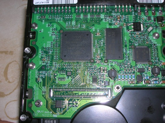

The bottom left corner chip on the PCB has fried so drive will not boot up. I would like to get the data off.
Can I just replace the board to resolve this or do I need the whole drive. I see a lot of similar drives on ebay but I'm unsure how closer match I need? Do I need the same drive, same board and same firmware? Which info from below do I need to match?

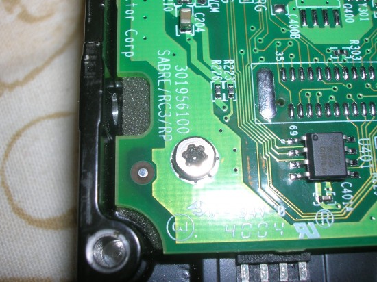

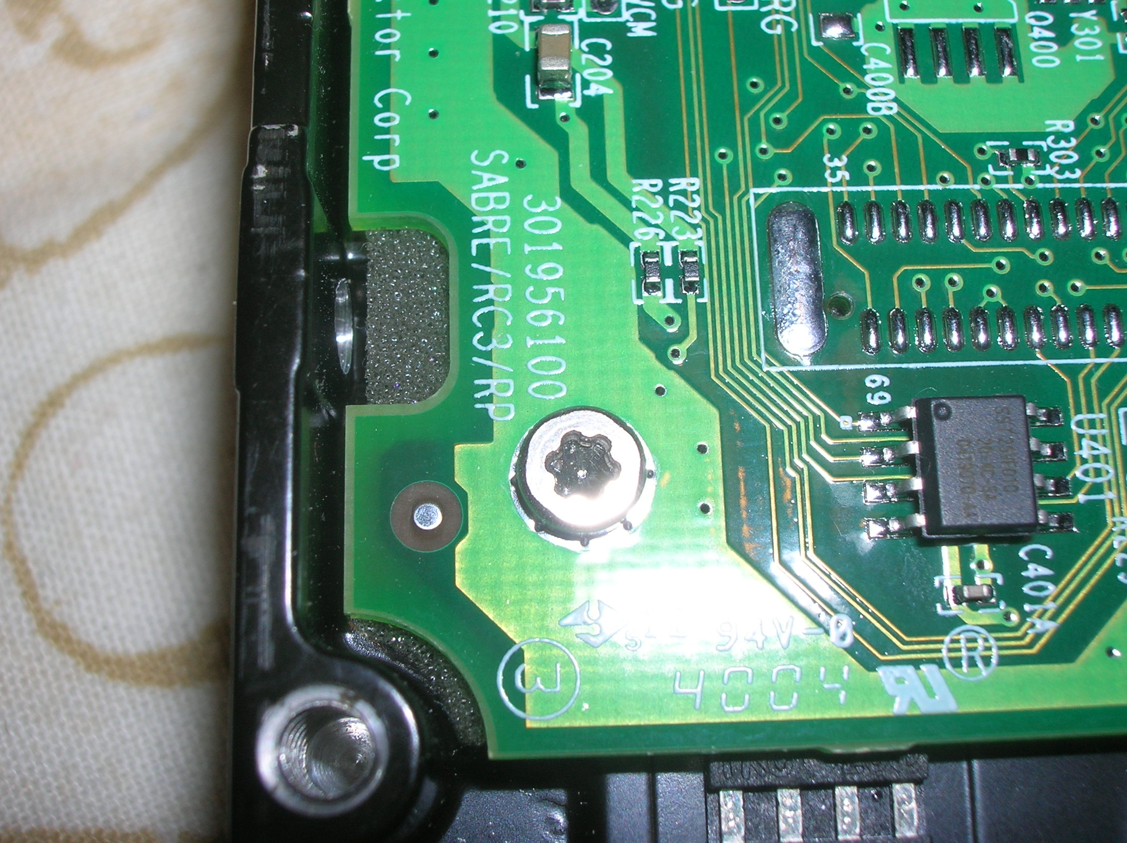

Thanks hddguy, the number on top of pcb appears to be 4004. Is this all I need to match?
 Post subject: Re: Maxtor DiamondMax 10 120Gb PATA133 PCB fried
PostPosted: November 14th, 2008, 11:56
Posts: 2984
4004? IT should read M8FYB or similar

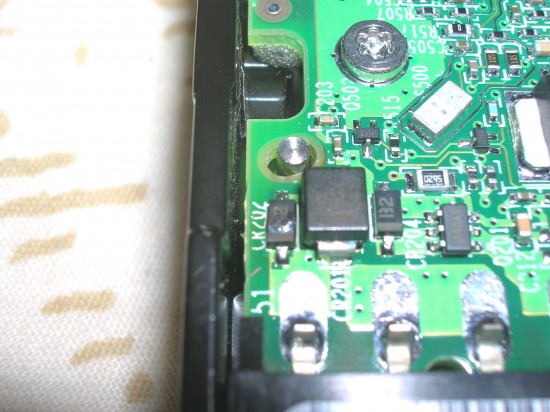

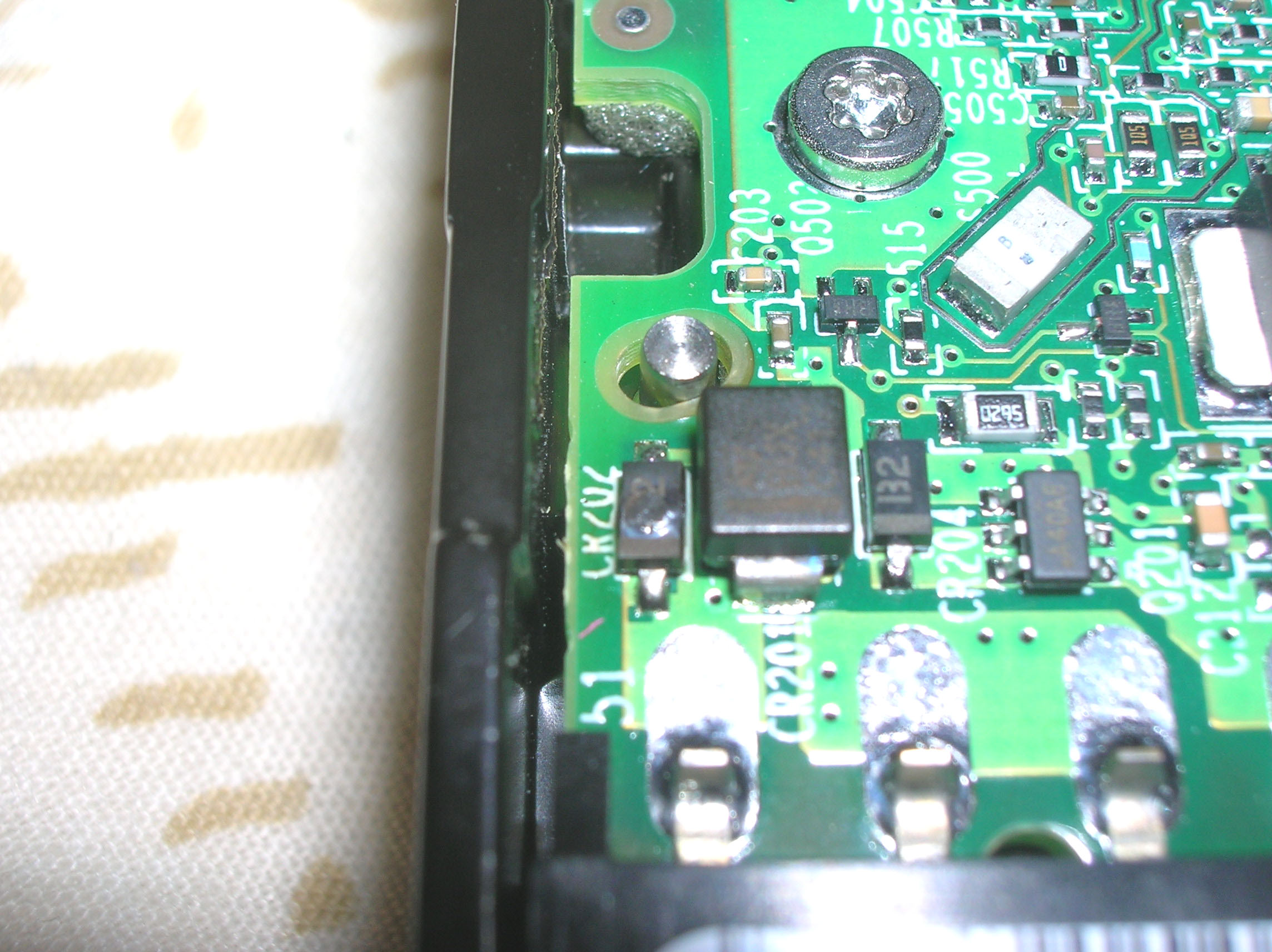

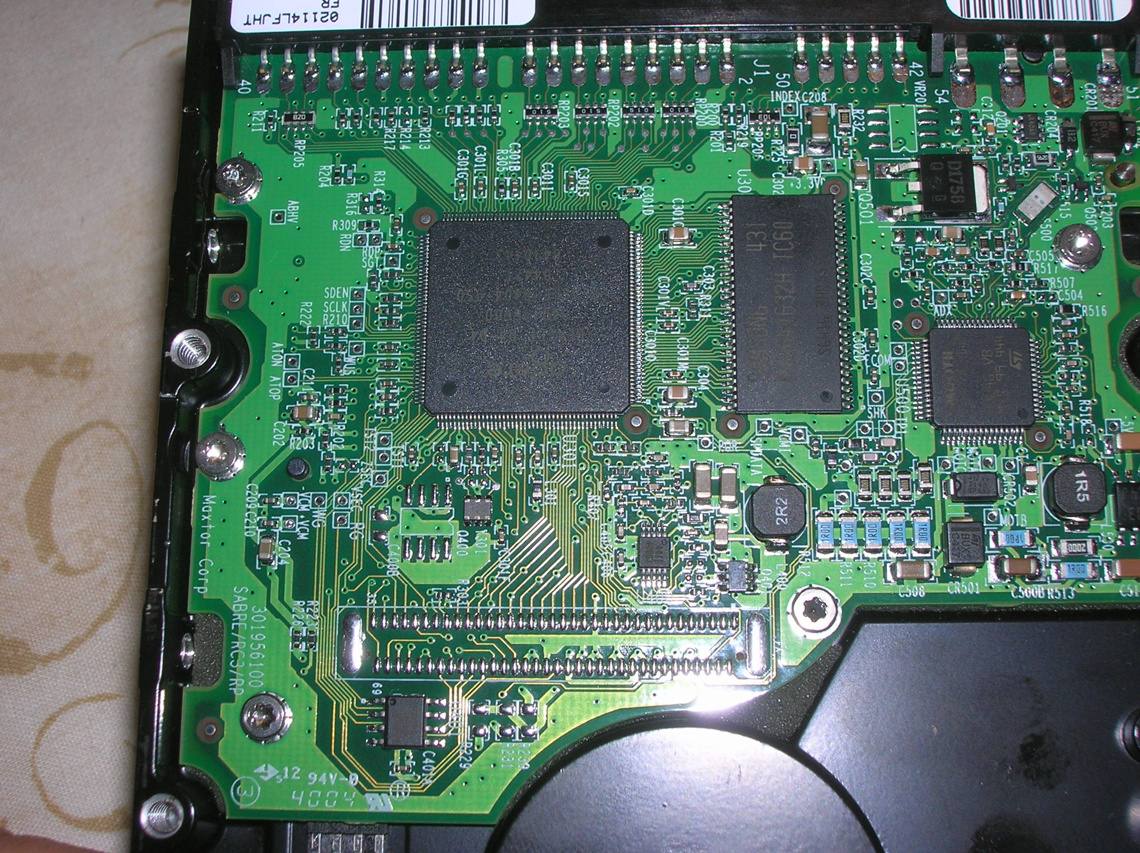

Can't find any other numbers on the PCB. I've attached some photos.
cheers
staro

The code you are looking for is on the stickers that are half in your first picture there.

One sticker reads JABLNKJQ
The other reads B2GBA 02114LFJHT ER
The last pic above shows the fried chip, I think? The one on the left.
Could someone please confirm which of the above details I need in order to get hold of a replacement PCB, where to puchase and if a replacement pcb would solve the problem?
Many thanks
Staro

You need to match the B2GBA for the PCB order
