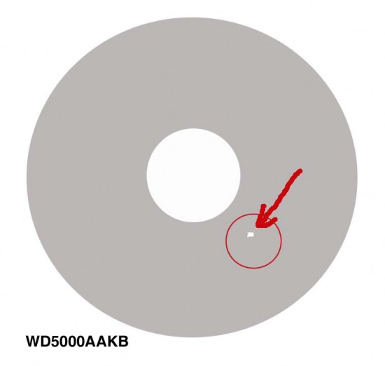

I have the same problem, mine WD5000AAKB the scrtach is located middle close to center hub (see the attached picture)
The drive is trying to calibrate but after few attempts , it shut off the power.
Any ideas?

The strange thing is i manage to do head exchange and could see the files, but when trying to copy it failed, now it wont calibrate. and another head exchange attempt failed as well.

sounds like the head broke because of the scratch in the surface.
You could try to image each head individually and see how far you can get.
Is it just a small scratch or an entire track?
