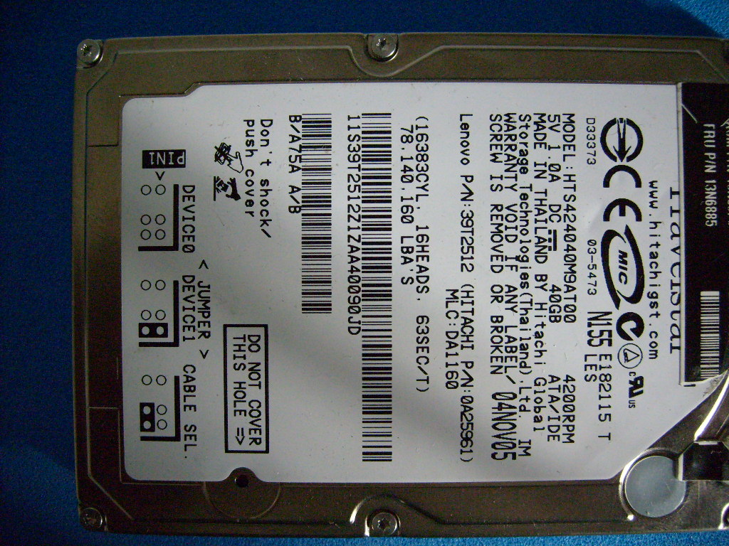

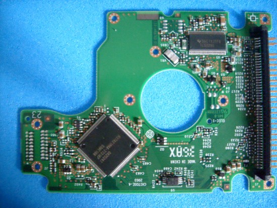

Somebody can give a tip to me is with a problem in a Hard Disk Hitachi HTS424040M9AT00, when on it makes small racket later for, apparently the PCB is normal somebody can give a tip to me of what it could be.
Engine does not turn

Failed motor or heads stuck to platter. Do not open it if data is important.

I would agree with spaz, likely heads parked incorrectly on platter preventing motor from turning. Send for professional diagnostic and/or recovery

when the HDD is powered, what noise can you hear? does spindle motor start or not? Is BSY LED lit on MHDD/PC3K?

When it is connected emits one takes care of well low, as (tec tec) after one 4 seconds for, not recognized for the PC3000 and the engine always stopped

sounds like you have a case of stiction. Top cover needs to be removed, and heads need to be parked correctly by you. Be warned though, if done incorrectly or not carefully enough, you will damage the heads, and maybe even cause damage to the media surface.
Is data important from this HDD? do you need data recovery, or is this simply research for you?

you can check when give power for the PCB. have volatage or not on pin that which pin connect motor. and you see the UDMA state also. :D
