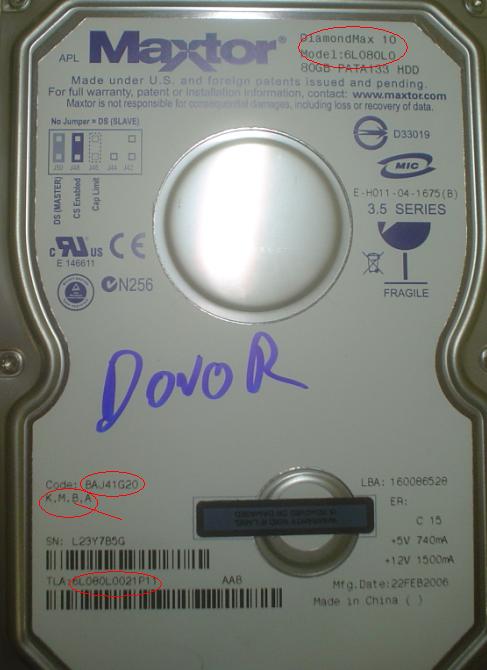

 Post subject: Heads Maxtor 6L080L0
PostPosted: November 21st, 2008, 15:14
Posts: 1060
Hi to all! :lol:
Head compatible for this model is the same enough to be of model?
or it must have the third equal letter?
Or fw and same manufacture contry?
:mrgreen:

You need to match these:
DM 10
KMBA
6L080L0021P11
Regards,
Janos

Hi N.C.! Thanks for reply!
My hdd bad is:
NMBA is donor KMBA =>It can give certain? :mrgreen:

hello sempre, to u will be sure check, preamplifier, i had check at this models, u can got a sorprise if u dont check preamplifier and u only based on codes

Heads swap, clicking, head donor is 100% ok!

Did u check preamp?
Same chip?

Yes check!!
The first line is identical :mrgreen:
