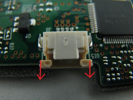

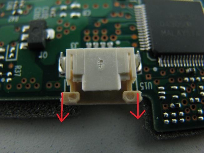

Guys I'm hoping you can help. I am swapping the PCB board on two IBM Deskstar drives because of broken pins. I've removed the screws but stopped there as I wasn't sure how to remove the thin cable that attaches the drive to the board. Before I experimented and risked damaging it could you share with me how to remove it.
and sorry for reviving an old post but there was not much out there on the topic.
 Post subject: Re: deskstar pcb swapping
PostPosted: December 11th, 2008, 8:30
Posts: 872
Location: Dublin
very easy to remove the cable.......just observe ESD precautions and be gentle...
