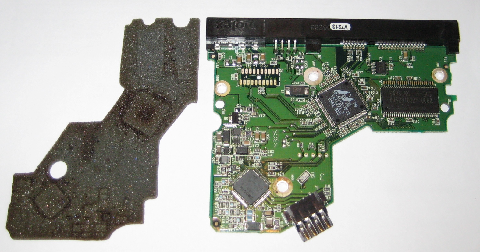

Here's a photo of the PCB. I don't see any parts that are clearly burned out but there are several that have definitely seen some heat (as you can also see from the foam pad). The drive has been in use for 3 years now so I suppose those could just be heat stains from normal use.

Big heat mark on the main processor. I think there's a reasonable chance that it is dead. Fortunately for you adaptives are stored in in the EEPROM at location U12 which could be moved to your other PCB if necessary.

It’s nothing out of the ordinary that I see every day. It would melt the foam and stick to the Marvel chip if it truly got too hot. I can't see it clearly in the photo but the top right side of the Smooth chip looks like contamination or something.
