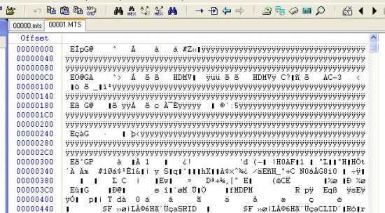

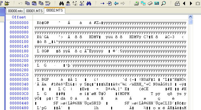

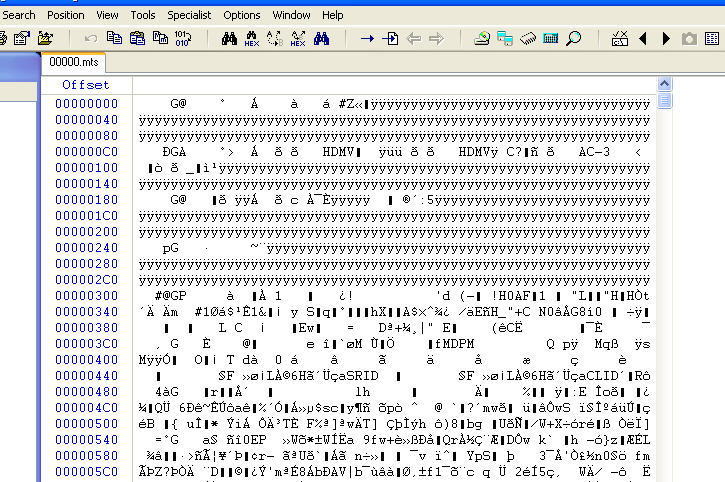

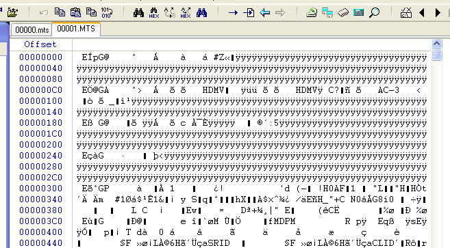

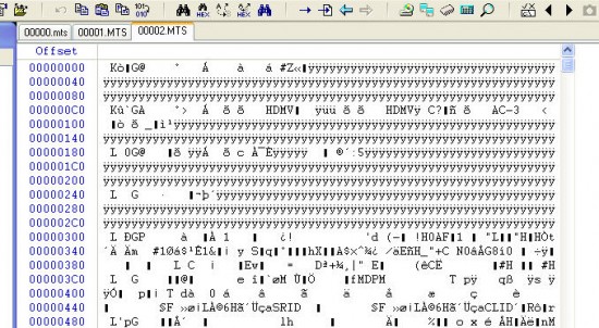

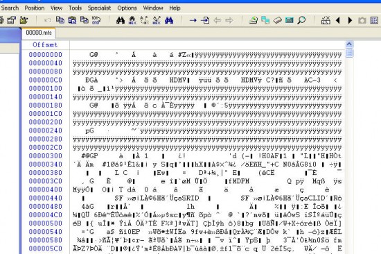

I am trying to determine the header but I dont know how to locate the mts file's header. Please see the attached JPGs.
I have 3 mts file but all beginning of the header files are different.

hex view would probably be more helpful to look at

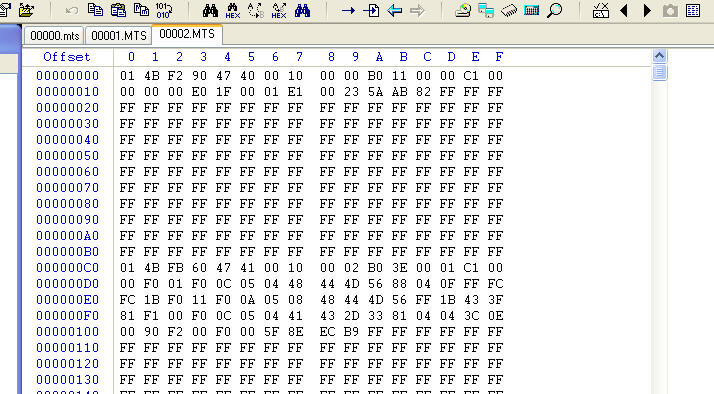

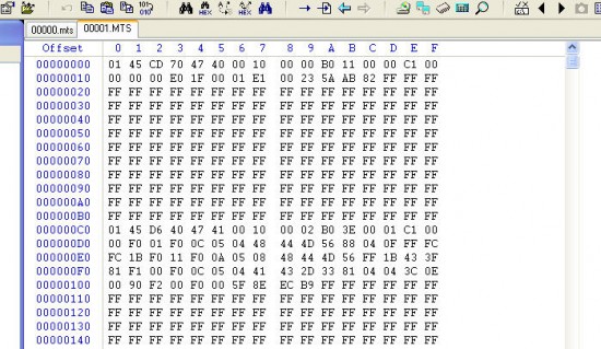

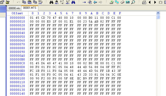

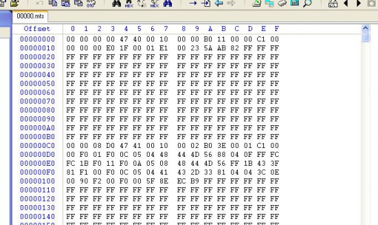

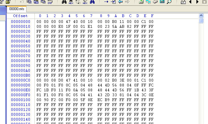

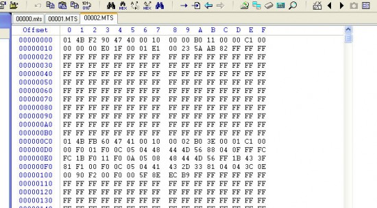

Here you go, thanks

so aside from the first four bytes the rest looks the same in all three
some googling turned up this "MTS has 192-byte-sized packets, of which the first four bytes are a big
endian counter (some kind of time stamp, like pcr)"
looks like first packet starts 47 40 and next packet starts with 47 41 etc
also it appears that the extension is usually .m2ts after the file has been transferred off of the camera
guy here thinks he has figured out the header http://www.highdefforum.com/high-defini ... o-one.html

doesnt work on 0x13ff and 4740h , anyone have a clue? thanks
