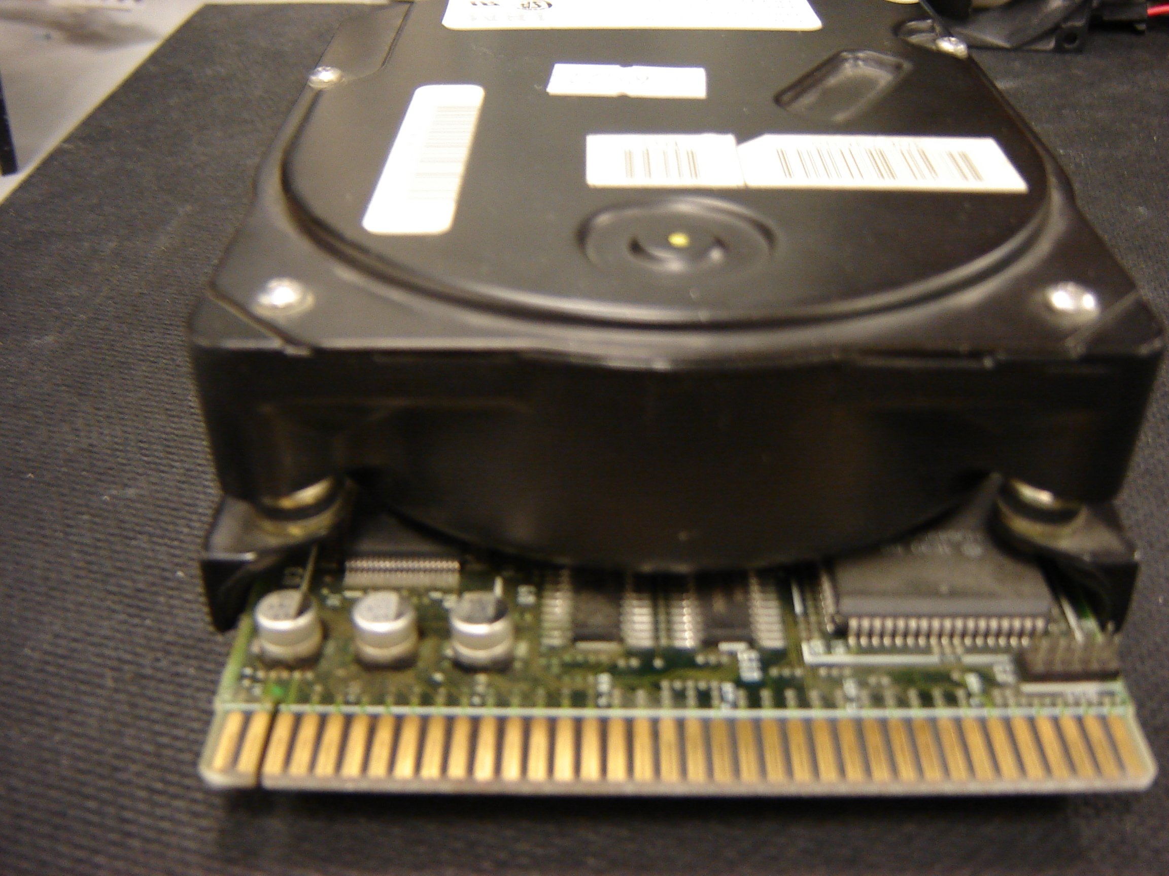

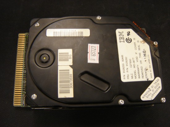

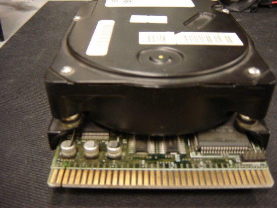

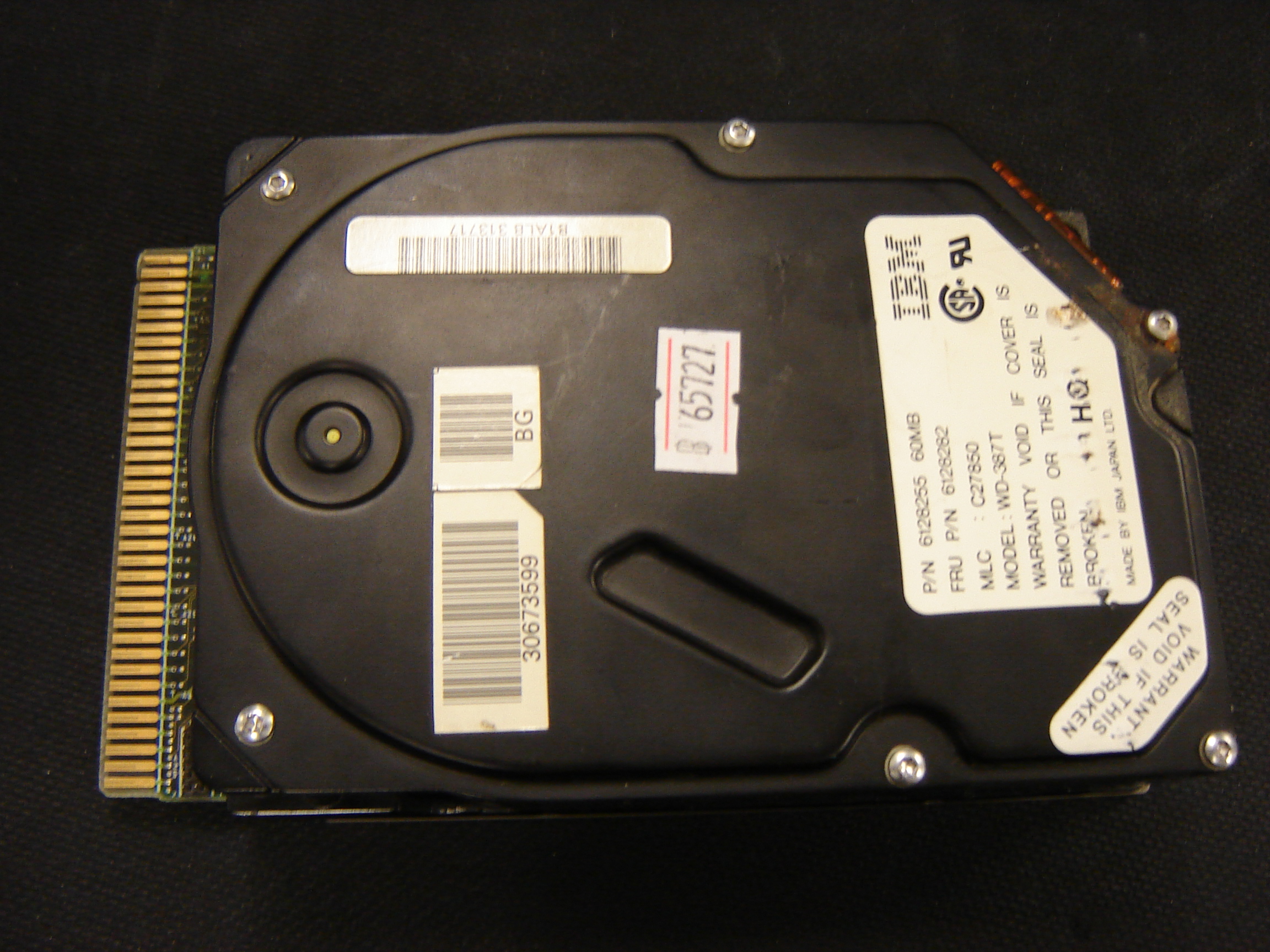

Hi guys, does anyone here recognize this drive. What I want to know is what kind of connector do I need to even plug this drive with motherboard? Any help or suggestion would be appreciated. see attached pics.

I think that is a ESDI connector.
http://www.vp-webdesigns.com/vpe/TSU/HAR.htm
Good Luck!
 Post subject: Re: Help!!! need to recover from old WD-387T 60MB drive
PostPosted: December 4th, 2008, 20:53
Posts: 3235
Location: USA
Yep, ESDI... You'll need a special controller for it. I see some old ISA ESDI controllers on ebay for pretty cheap.
PostPosted: December 5th, 2008, 3:43
Joined: May 5th, 2004, 20:06
Posts: 2782
if it hasn't been used for a long time it will probably have stiction (Heads stuck to platter inside), quite typical on these old beasts
Hope all goes well
