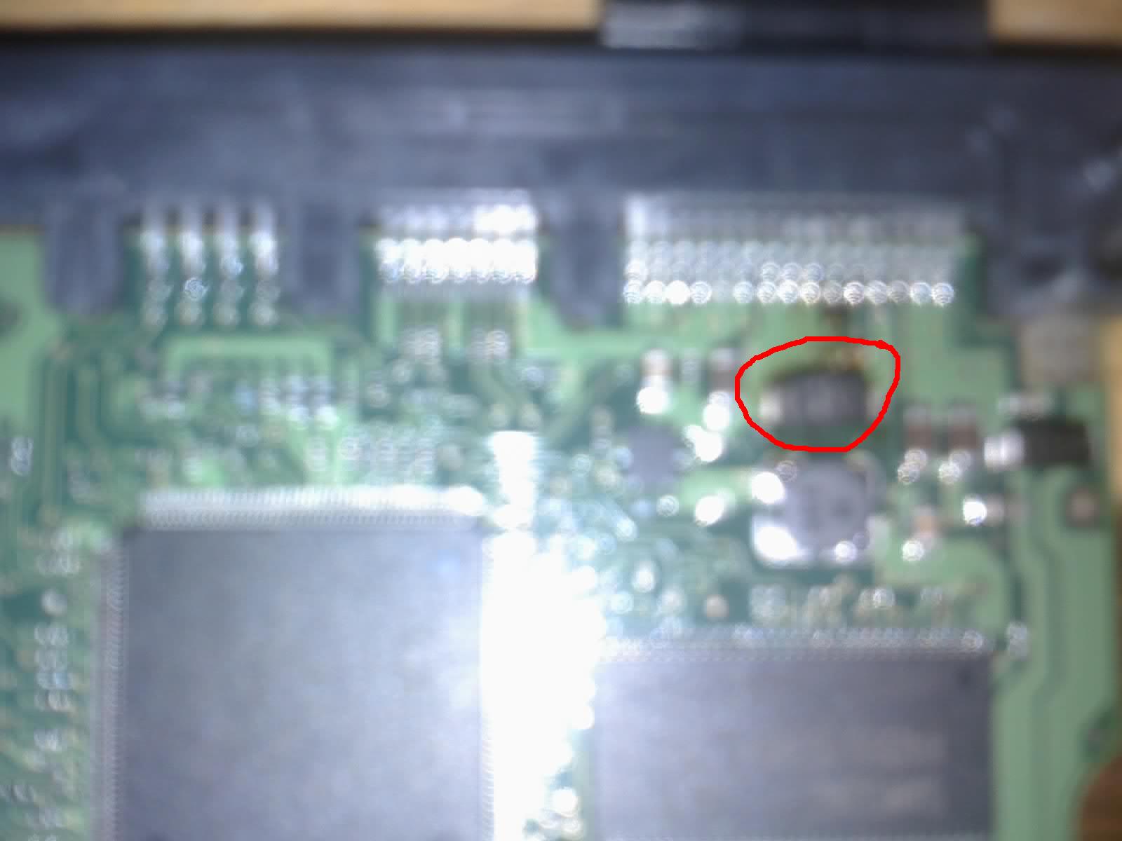

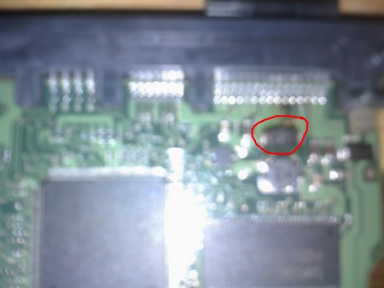

I have a Maxtor 500Gb HDD STM3500320AS Dimonmax 22 yesterday it make some smoke I dont know why may be PSU or bad power connection !!
I discovered that the diode (if Im right) is damaged , see pic
so can anyone here gimme information about that diod or have PCB datasheet so I can replace it or is there any other solutions ?

your picture is very difficult to see but if that is the TVS (and I think it probably is) then you should be able to get your drive running by removing it.

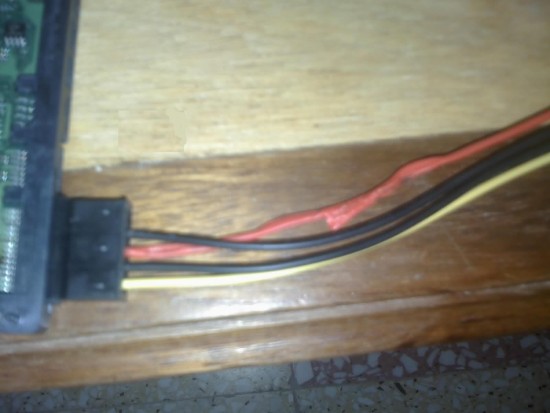

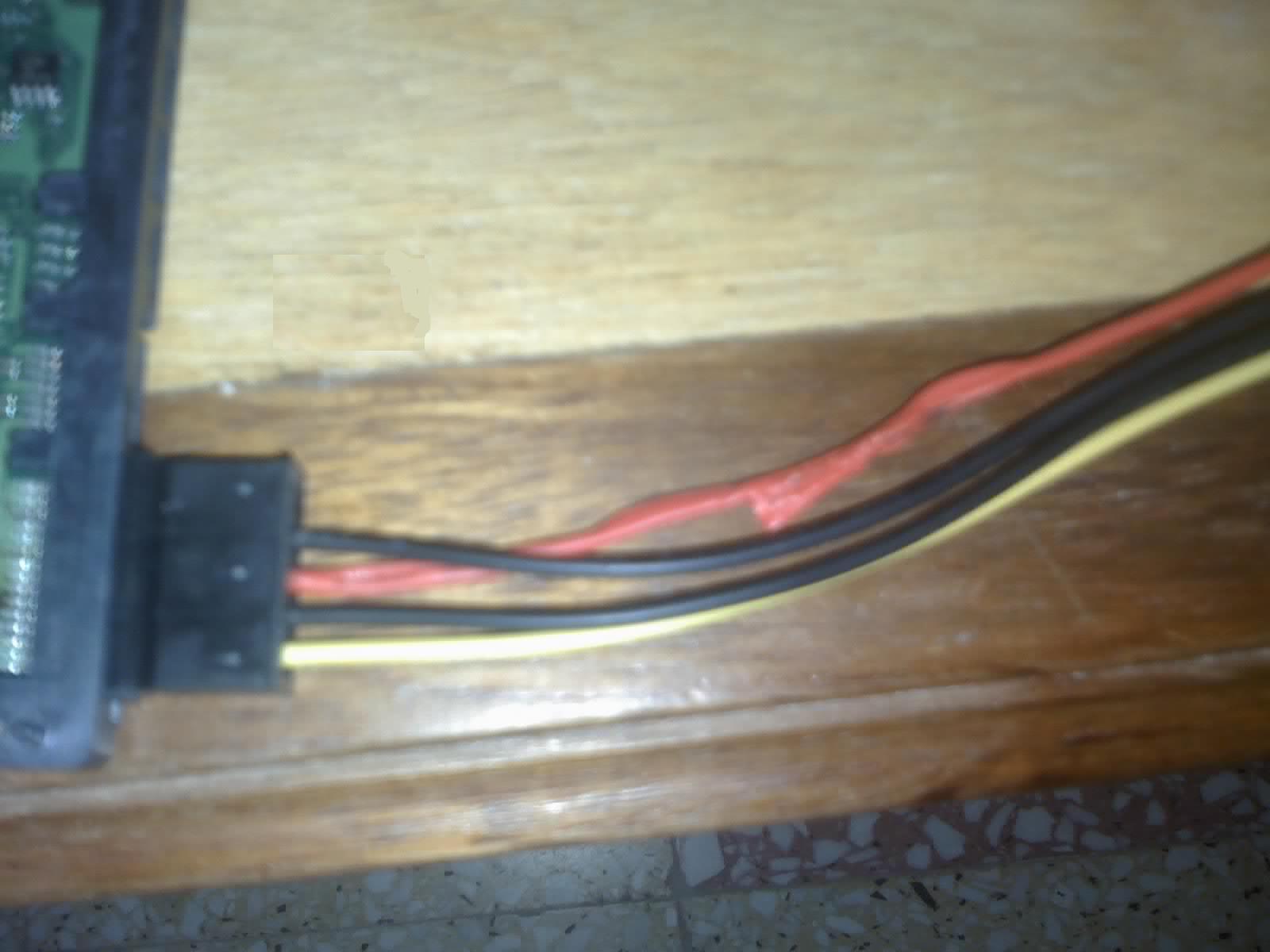

another thing after damage I try to connect my HDD and the red power cable burned and PSU didnt cut power down untill I do that !!! (see pic) is that normal ?

The answer to your next question: Yes, just remove it.
If you want to know the full story, search for TVS on here. Been discussed many times before...

Right, the TVS is shorted to ground. A good power supply would shut right off or even refuse to turn on, but yours dumped enough current through the shorted line that it melted the wiring.
Don't use that power supply anymore.

the TVS protects more important circuitry. while your drive will work okay without it, provided it did its job correctly and protected everything else, running without it means running without protection.

Based on which wire melted that should be your 5V tvs.

It's not like we're talking about a ROM chip or something. If it's the 5V TVS, you need a replacement 5V TVS. With a few minutes with a good set of eyes, and/or a multimeter, you should be able to tell. Hint: The 5V TVS is across the incoming +5V line.
