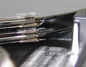

I have this disk and i see that head 2 , the little metal is touching the platte.
Anyone know what tool can i use to make the little metal right.

ESD safe tweezers, and a very steady hand.
Damage may already be done to that bottom platter though.
ZeBong
It verifies if it does not possess risks in platter and with very well-taken care of it tries to only come back toward next possible to the original position or so that it has not touched platter. This and mine opnion. I wait that it helps you.
Good luck! :mrgreen:

Thanks to all,
Afther change the heads i could get the data :)
