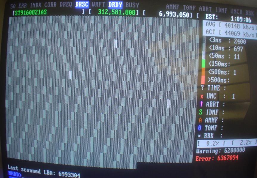

PATIENT IS ST9160821AS FW:3.BHE PN: 9S1134-022 SITE: WU (PCB 100398689 REV C)
DONOR IS ST9160821AS FW:3.BHE PN: 9S1134-022 SITE: WU (PCB 100398689 REV C)
pcb bad. I changed pcb with one good pcb.
RECOGNIZED HDD AND FOR THE MHDD, WHEN READING MEDIA (F2-SCAN) READ WITH SOME BADS BLOCKS
NOT READ (DE PCI) 2.21
IMG FOR COPYRDMA (VERY SLOW AND AFTER THE ERRORS (BUSY)
HELP-ME!! :oops:

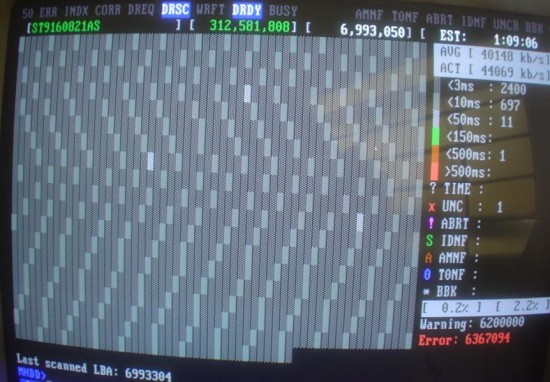

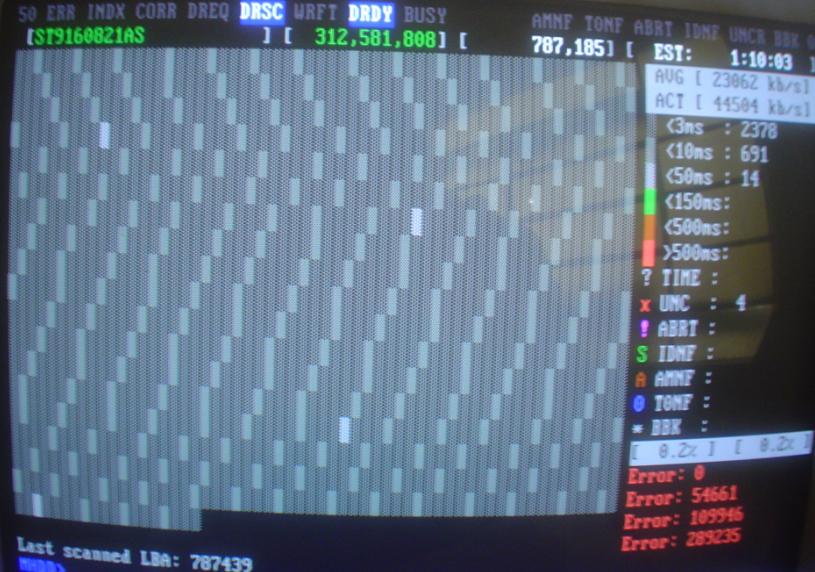

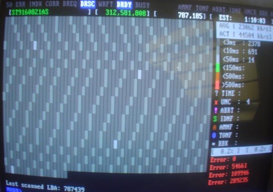

Hi to all!
With mhdd scan these lbas and has only some bads, already if I try to make clone saw tool not windows it starts very slow and after the errors (busy)…
head?
media?
preamp?
:mrgreen:

Have you tried a reverse clone?
You may get a good result.
Duncan

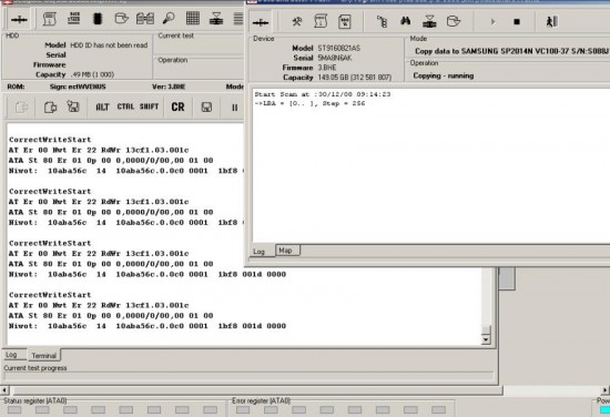

 Post subject: Re: PCB BAD ST9160821AS

sempre wrote:
Hi to all!! :mrgreen:
HELP-ME!! :oops:
HAPPY CHRISTMAS!!! :mrgreen: :mrgreen:

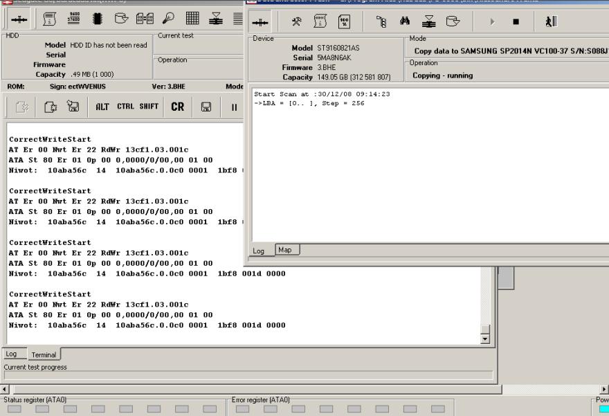

sempre wrote:
head?
media?
preamp?...
Firnware issue, the drive "do not know" how to manage bads. IMHO
I think it is solved in UDMA.

Hi to all!!! :mrgreen:
I after continue with this problem exchange of pcb I begin, it he is ready and it recognizes and soon after is busy, some help? :oops:

Modification of App Code or Intf Sys should solve the pending problem
Hmmmm...Modification of APP code seems risky but modification of Vendor is not a problem....but HOW to modify Vendor info in order to stop the pending problem?
