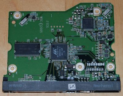

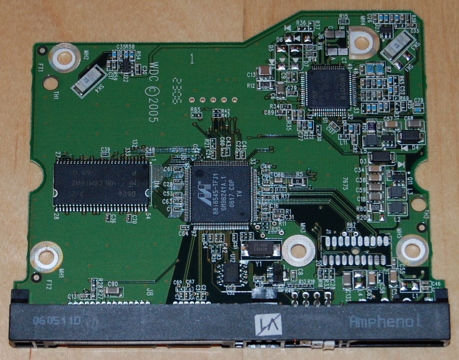

My WD5000KS developed clicking noise problem :(
Computer just hung one day and when I rebooted drive was not recognized by the BIOS.
When powered up drive spins-up and clicks few times and than turns off.
I am going to try to swap PCB. I hope it is the problem but I realize it could be heads.

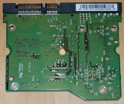

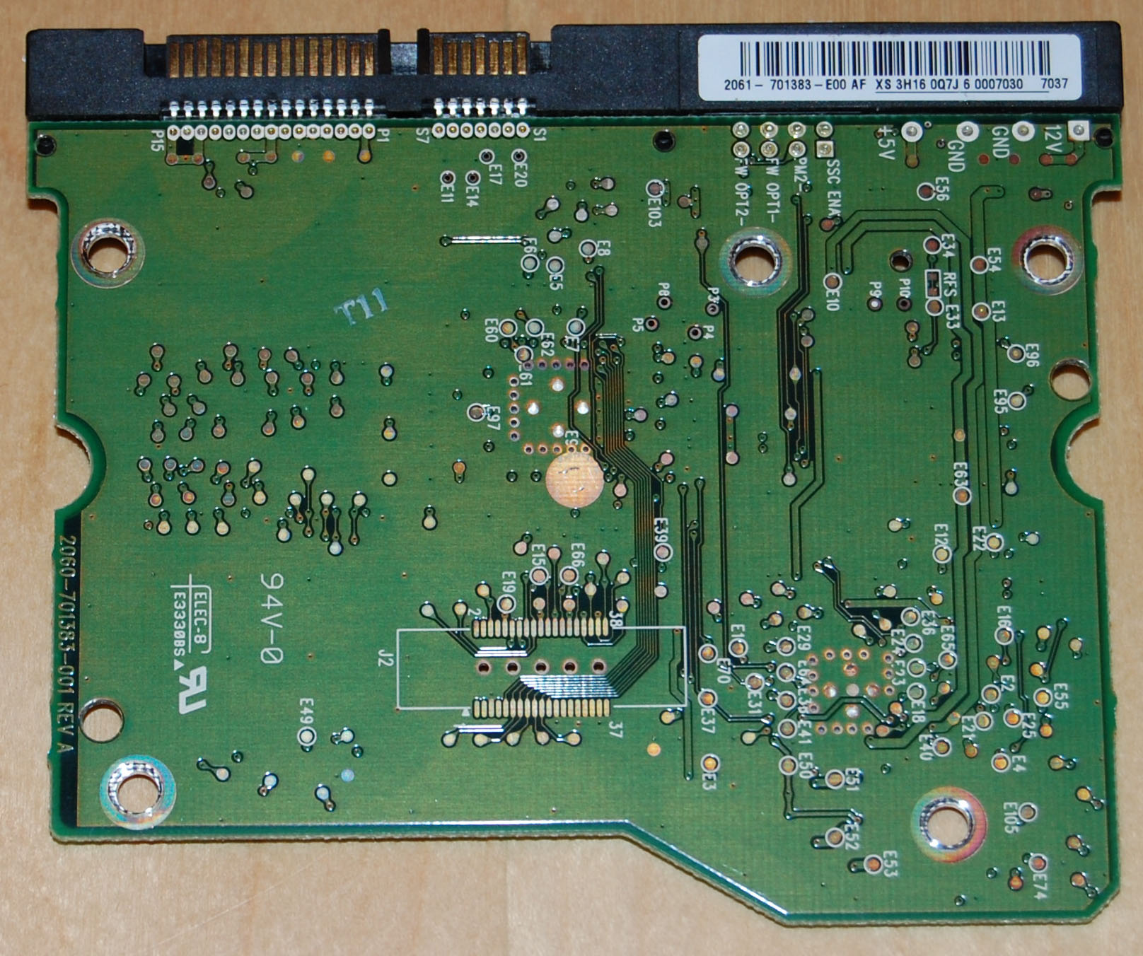

As you can see from my picture barcode number of PCB is:
2061 - 701383 - E00 AF XS 3H16 0Q7J 6 0007030 7037
Motor driver is: L6284 2.2
Serial flash: SST25VF020
I did identify possible donor for PCB.
Its number is:
2061 - 701383 - E00 AC XW 3H11 2027 1 0001360 6361
This is all the info I got at this moment. I do not have it physically yet.
The first part of it matches; do you think this one is will make a good donor?
I going to try re-program serial flash before swapping. Is there anything else I need to do?
What about firmware and how do I tell its version? Do I relly care?
Any help would be appreciated.

I don't think you have a board problem. I think the problem is with the HDA or firmware.

clicking being caused by the PCB is extremely unlikely. Although it is good to rule it out if you have access to a compatible pcb. As it's already been said clicking is predominantly caused by an issue with either the firmware, or a malfuntion with the HDA.
