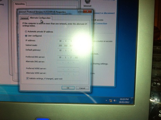

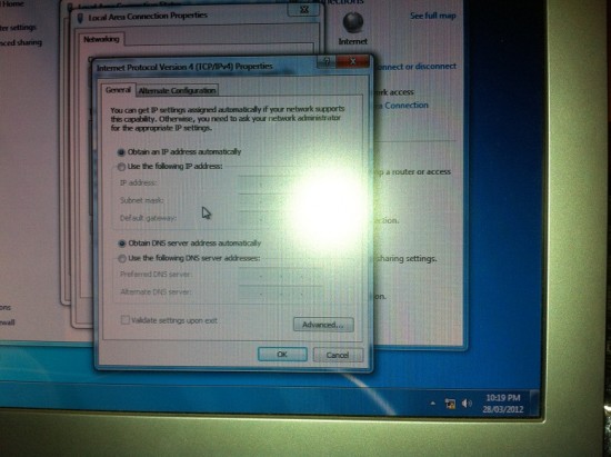

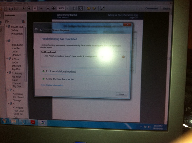

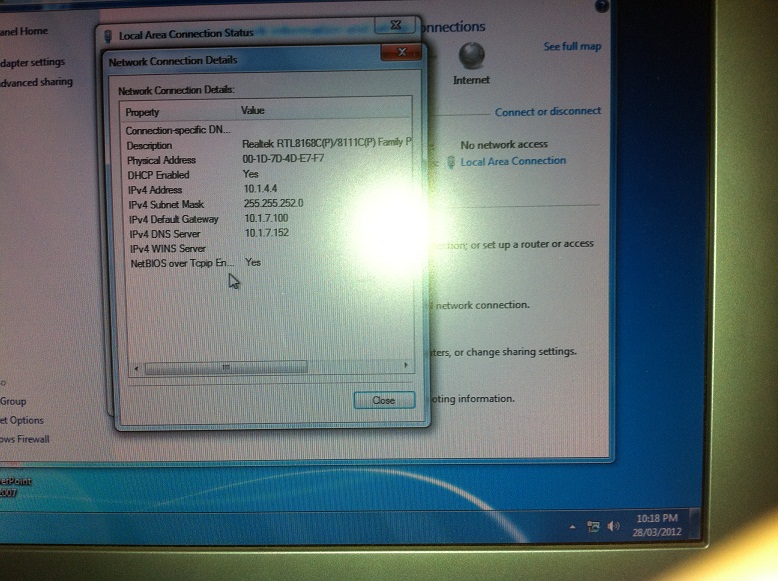

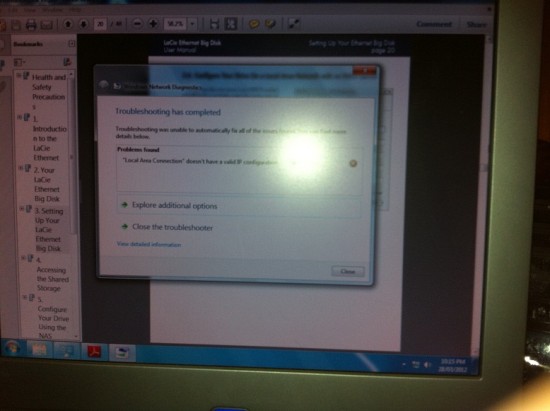

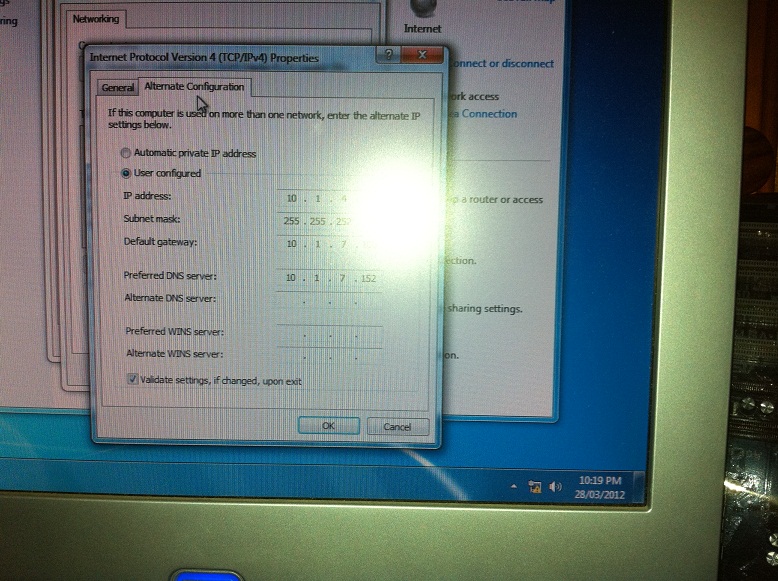

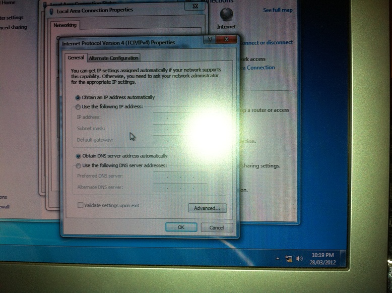

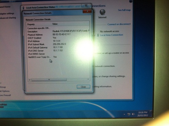

Now I have found out that you have to configure/initialize them in browser interface over the network & format them that way...
Now the only problem is I can't get them to connect in windows 7 network, they say ip address error that windows can't repair & when I try the manual IP V4 Settings from the manual still can't connect?
Would this be a windows7 issue or the controller on the LaCie device?
Thanks again for your time Grant

before you begin get the free app LaCie Network Assistant.exe - especially with windows 7! This will locate device, mount it, and allow you to set fixed ip from a simple user interface. It also bypasses need to alter registry in win 7 for unix security. good luck

Thanks for the replies,
Seems LaCie don't want to help as the product is too old, but will follow this up further!
I have taken photo's of the settings I have chosen(I know the flash has ruined some of the images).

I have tried the network assistant again as I'd already tried it, but tried again last night for another hour but still no luck!
Any further help would be appreciated!
Thanks Grant

 Post subject: Re: Lacie Ethernet Big Disk 2TB replace HDDs
PostPosted: March 29th, 2012, 5:03
Posts: 17232
You should be able to capture the screen contents via the PrintScreen key. That will send a screenshot to the clipboard, and you can then paste the clipboard contents into your preferred image editor/viewer (using Ctrl-V or Edit->Paste).
Have you tried typing 10.1.7.100 or 10.1.4.1 or 10.1.4.4 into the address bar in your browser?
I don't know if identifying the firmware IC would help, but the numbers "21801" and "G715" don't look useful. I suspect that "715" may be a YWW date code, ie week 15 of 2007. Could we see a detailed photo of the board?

Need to start at beginning setting aside cloning for the moment.....You are not communicating with the Lacie - start at the beginning. No idea what ip Lacie was on or if it is in automatic. I see you tries 3 LOCAL settings in an attempt to match it- first shot has erronious gateway and dns... or is it base ip... dont know how it WAS set up. Easiest to plug computer and lacie into router- get computer "to see internet- or be able to connect to other network devices" first. Back to Lacie Navigator- you may need to checkmark "use Legacy"- you are using latest as windows 7 didnt exist when you purchased your enclosier. With your ip set to automatic the utility fill typically discover the Lacie. It will give you its ip and if manual or automatic. There are reset procedures for Lacie to return it to defaults- suggest not altering except as last resort... it WAS working. Once working there are methods including using the built in mirror to grow your disk- once systems up! With orig mirror- remove one. Add second new drive- system errors and you can rebuild adding data to bigger drive. Rem orig. errors add new bigger blank, rebuild. VERY Clutsy but 'easy' way to migrate.

in most cases, those NAS as worst case scenario are set to DHCP, so u should have a router with enabled DHCP server
to know the ip address is very simple
there should be MAC address on each NAS written on sticker, and there are tools (freeware) scans your network and match the MAC address
and get u the IP this is where u should start easier n faster than guessing
