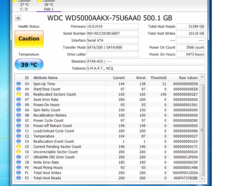

The hdd responding very slow to make partition in windows or windows installation

Probably slow responding problem. Can be solved with hddsupertool, but them you have to see if there are other problems around. You can check SMART and see what it says. Is your intention recover your data or re use your hdd?

you can use CristalDiskInfo to check SMART parameters and see if there are some on them close to threshold.

HERE CRISTALDISK INFO

I think you have an issue with rellocated sector count. Use hddsupertool to do a slow fix (you can seacrh in this forum for procedure) and then mhdd to check sectors.

If you need to recover data from the drive then you should use HDDSuperTool to apply the slow fix, and then HDDSuperClone to clone/image the drive. The drive has many bad sectors, maybe even a weak head. If you wish to try to reuse it, you can follow Spildit's information, but you will never be able to trust the drive, and it will likely not last long.
