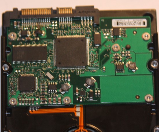

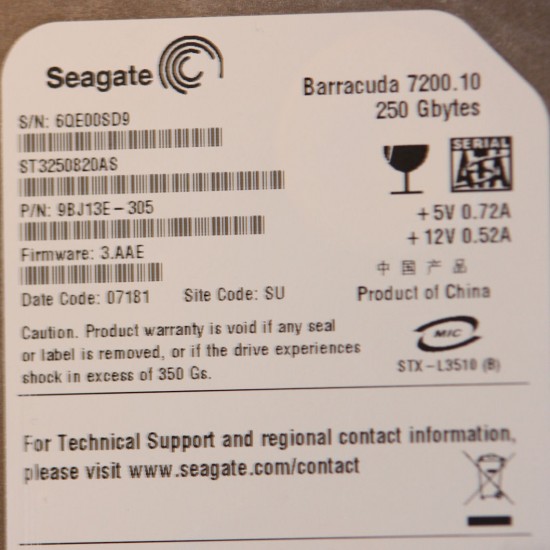

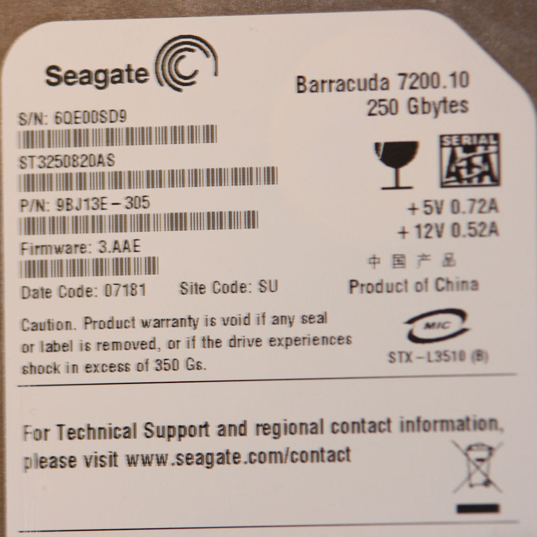

hi all, i am in need of a pcb board Firmware: 3.AAE Seagate Barracude .
if anyone has a hd with same firmware please contact me. will pay reasonable $$$

what is the reason for needing this? Is PCB damaged? Is ROM at U12 ok?

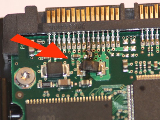

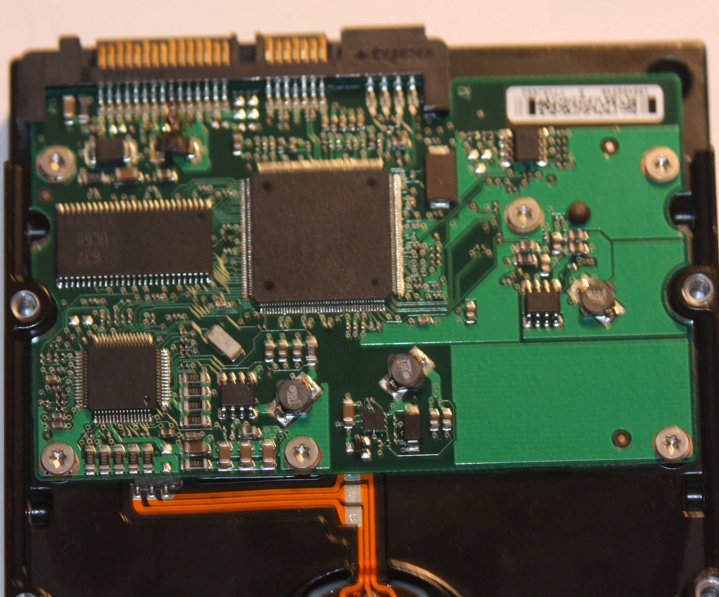

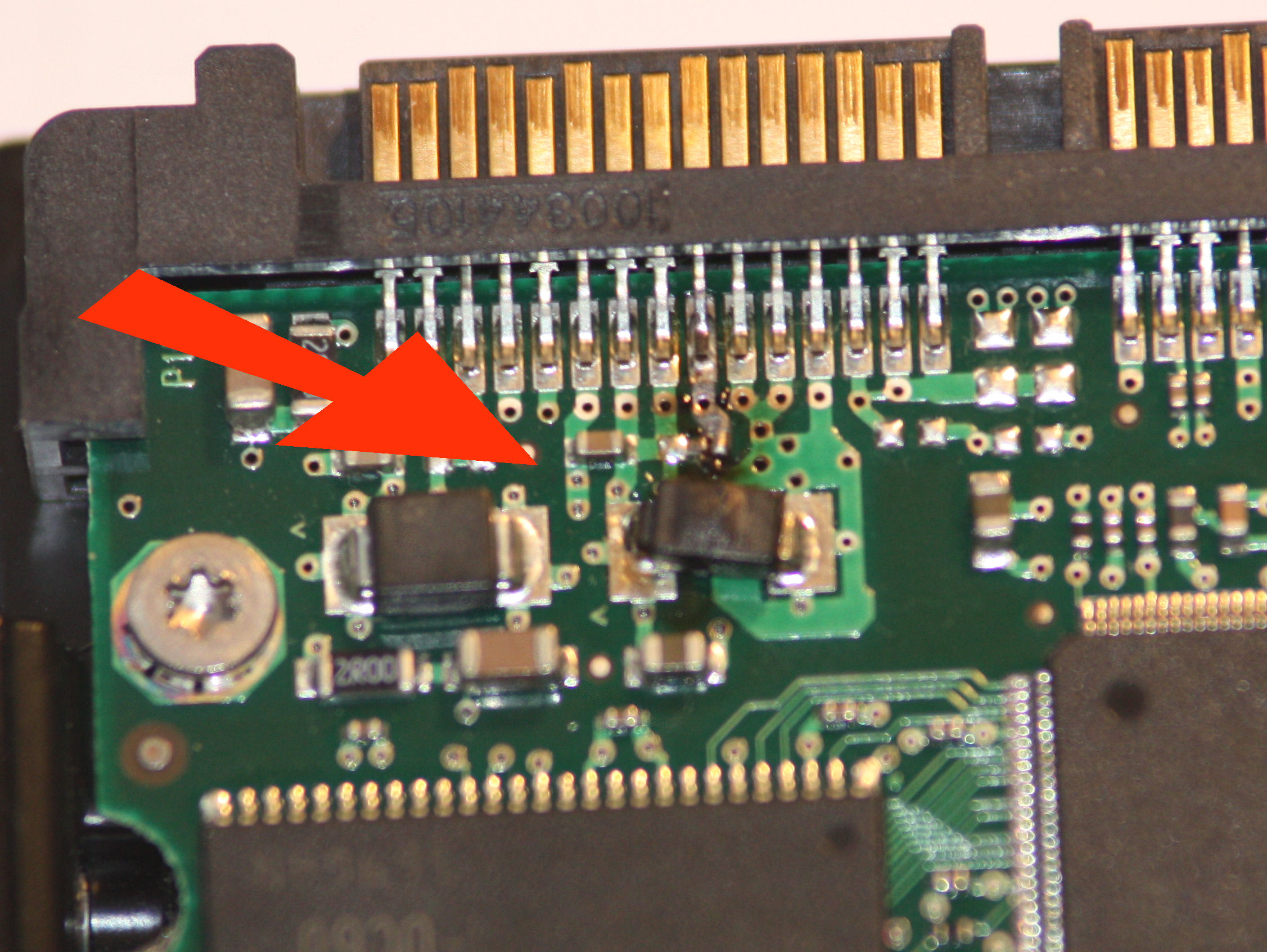

please refer to images i am not sure what they call it but its the bottom board with a burned out chip
[ orange arrow]
 Post subject: Re: Firmware: 3.AAE Seagate Barracude ST3250820AS
PostPosted: January 16th, 2009, 13:14
Posts: 2984
TVS damaged. You can get more info on this from previous posts and topics.
