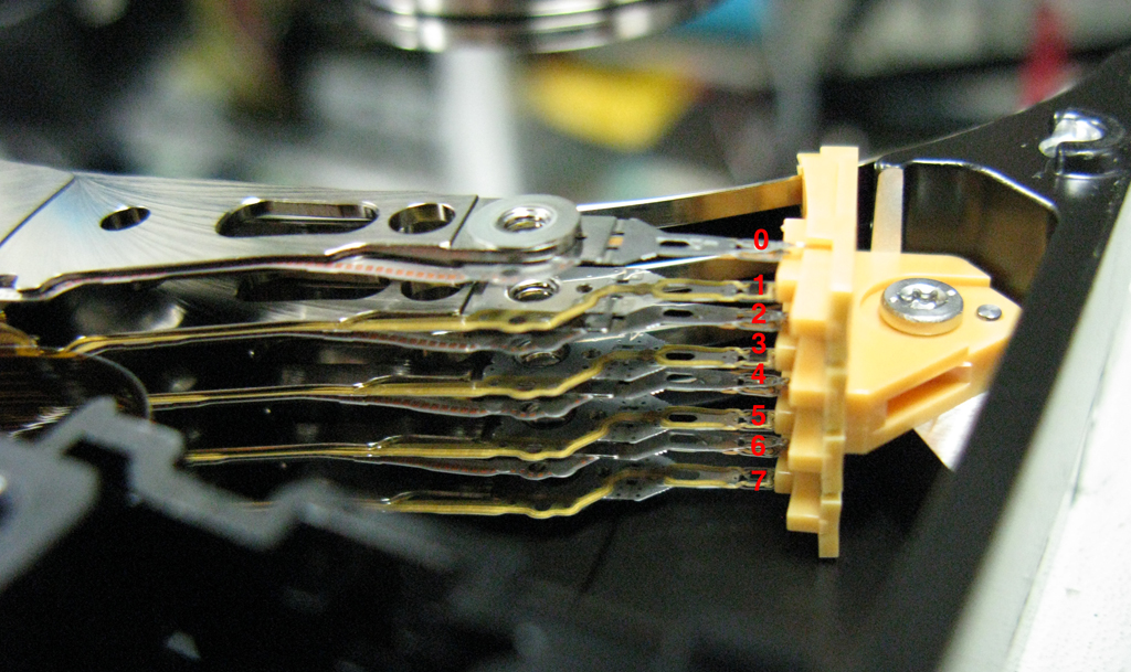

Hi guys
Are WD head arrangements start from the top platter as Head 0 all the way to Head n... at bottom? Please see the attached.
Thank you.

The ones that I've worked with start at the bottom. But I have not swapped this many heads in a WD drive.

WD heads always count from the bottom

Head 0,the bottom and so so its like 500gb or 1TB
