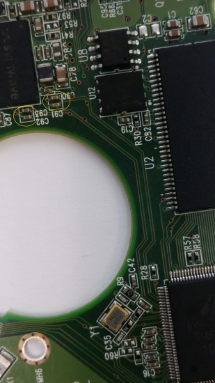

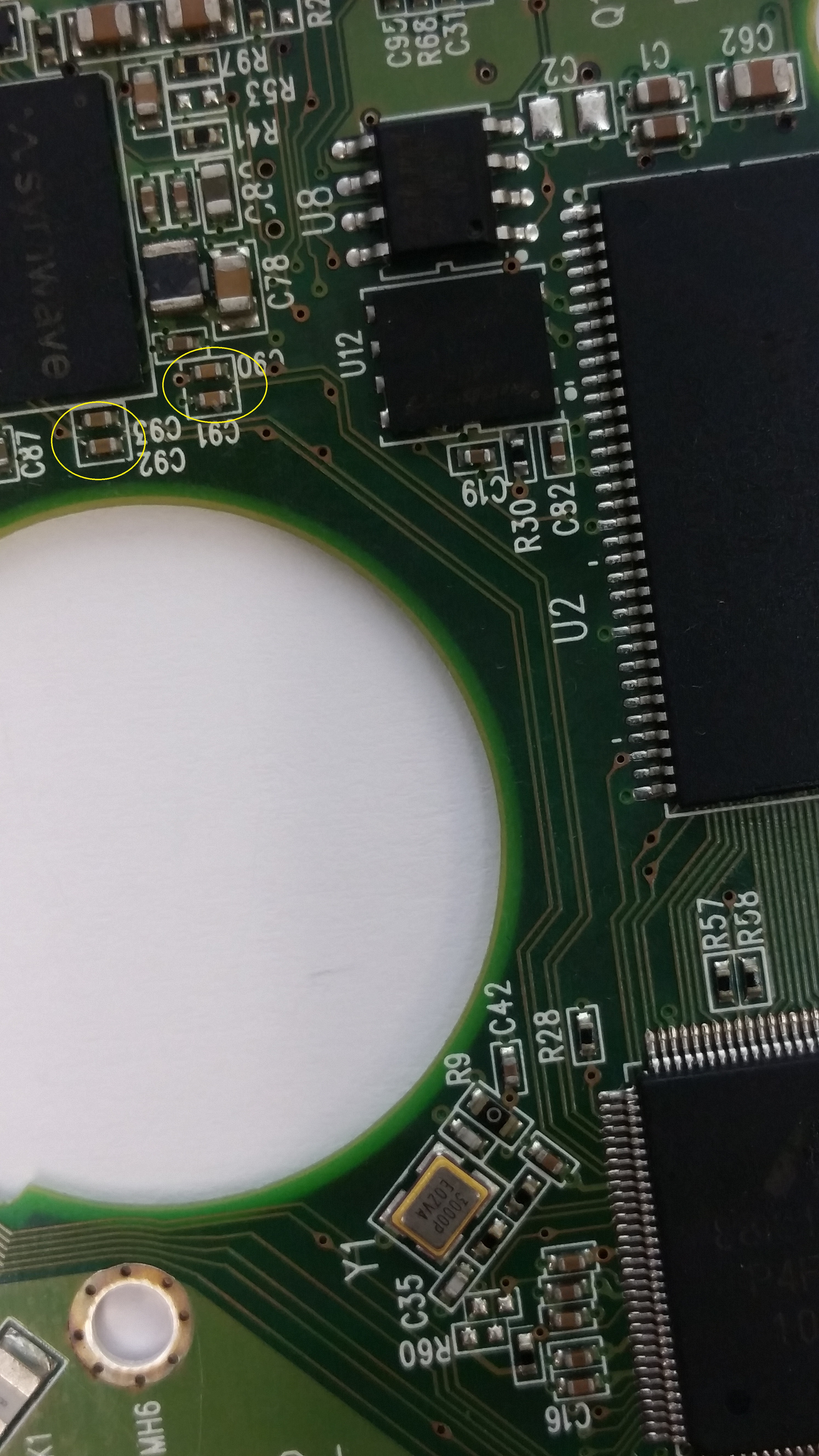

If I have to do this the old fashioned way and solder a SATA connector on, are these the right caps to remove? I presume I can test the solder points on the back of the board with continuity? Anyone know how to tell which is transmit and which is receive?

Find a photo of a SATA PCB with the same MCU.
Follow the SATA Tx/Rx traces from the MCU to the SATA data connector.
Locate the same MCU pins on the USB PCB. Same pins, same function.

Makes perfect sense when you explain it. Thanks. Got it.

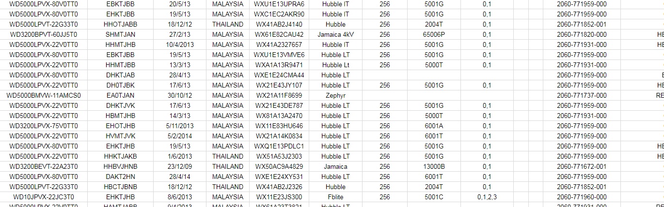

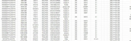

I have the stock well documented, so it's very fast to find this kind of stuff.

Checked my stock and they were all 256K. I like your way of cataloging them.
