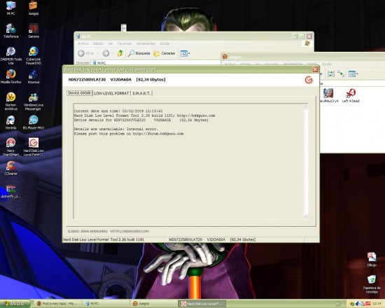

 Post subject: Details are unavailable: Internal error
PostPosted: February 3rd, 2009, 13:15
Joined: February 3rd, 2009, 12:55
Location: colombia
Hi all comunity --HDD-GURU-- i have a problem with my HDD Hitachi 80 GB
Model:HDS722580VLAT20 FIMWARE:V320A60A
to open the program I get
Details are unavailable: Internal error
I get everything else ok, the program allows me to train and let me give you a windows NTFS the problem is that I do not give information on the disk.
depending on what step I informasion and everything works normal but I know that is the problem, can someone help me?
IN probram:----------------------------------------------------------------------------------------------------------
Current date and time: 03/02/2009 12:10:16
Hard Disk Low Level Format Tool 2.36 build 1181; http://hddguru.com
Device details for HDS722580VLAT20 V32OA60A [82,34 Gbytes]
Details are unavailable: Internal error.
Please post this problem on http://forum.hddguru.com
I would say if I can use either disk or some time I was hurt?
File comment: photo program
Dibujo.JPG [ 136.9 KiB | Viewed 2974 times ]
