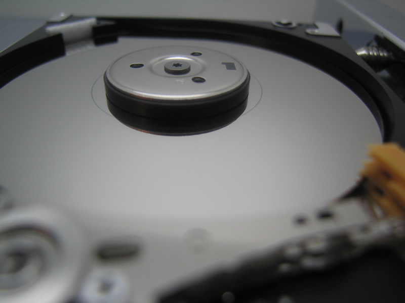

Hi to all,
Have this seagate that have this in the platte.
In terminal show this:
Reset
4096k x 16 DRAM
GALILEO - 1_Disk    S-0E   10-09-07_17:41
Buzz HM HM HM HM HM
It´s head problem, but is possible to get the data with that circle in the platte ?

yes. You have to prevent the head to reach that region. Then make a loader asap because you could need it afterwards.

Could be possible looks like land zone .

I did an old Fujitsu 10 GB in the past. Just used my finger to stop the drive from passing over it during recal :O) And that media was fked!
Also in some cases better start the drive via hot swap .. This may/can stop it from recalibrating on spin up.
