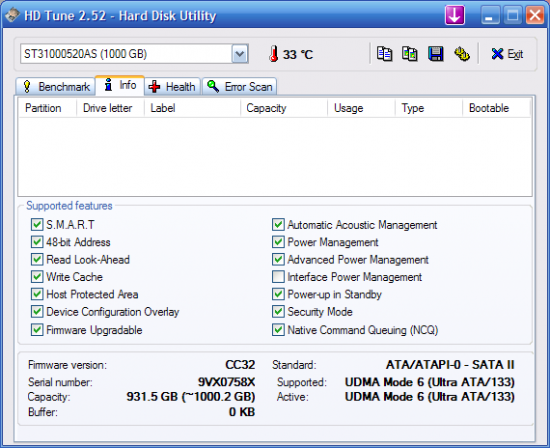

Hi Guru's!
I heave this 1 tb hard drve. In midsummer I put win on it, works fine 'till late december when encounteret some bsod's then pulled out for autopsy.
buffer size is ZERO, reoprted by HDtune, hitachi feature tool...it is there a solution to make the buffer just be there and hope to make the drive work better...I don't know, I just kan't figure out how...
thank you.

 Post subject: Re: ST31000520as Buffer size: ZERO
PostPosted: January 17th, 2012, 17:06
Posts: 17215
A drive reports its cache size via the ATA Identify Device command. The drive returns 512 bytes of information, including its model number, serial number, capacity, etc. The cache size was formerly reported in word 21. However, this word was long ago "retired" from the standard. Despite this, the HDD manufacturers have continued to use it, until recently.
The following article explains in detail why no drive can report a cache capacity in excess of (32MB - 512 bytes). In short, it is because this size equates to a maximum value of 0xFFFF for word 21 in the ATA Identify Device data block.
http://seagate.custkb.com/seagate/crm/s ... cId=203631

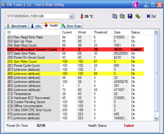

thank you
the hard drive was sold as a system part,seagate sez...so no rma. till now ,never tried a rma, maybe the price of shipping equals half the price of a new one,I wonder about...
bads...grouped and spread all togheder, a big mess,its a wrek
after somone see the smart attributes can tell something about its future and tring something, I see nothing left to do.
I do not want data recovery, just want a drive.
PostPosted: January 18th, 2012, 14:23
Joined: May 6th, 2008, 22:53
Posts: 2138
BOGDANB1 wrote:
just want a drive.
Forget it - the drive has an internal problem, so IMHO you are wasting your time, if you think you can make this drive reliable yourself.
As a minimum, erase the whole disk by wiping (not just deleting files) if you are considering giving / selling the drive to anyone else for spare parts - but a DR company or skilled amateur could read any personal data from the 4015 reallocated sectors, even if you wipe the user-accessible LBAs. If confidential data was ever stored on the disk, you may want to consider destroying/deforming the platters.
