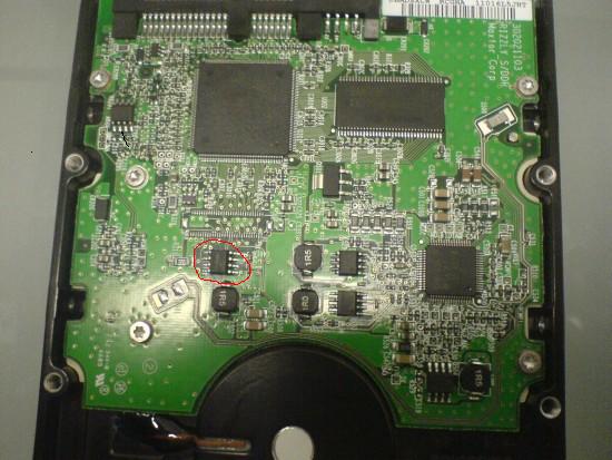

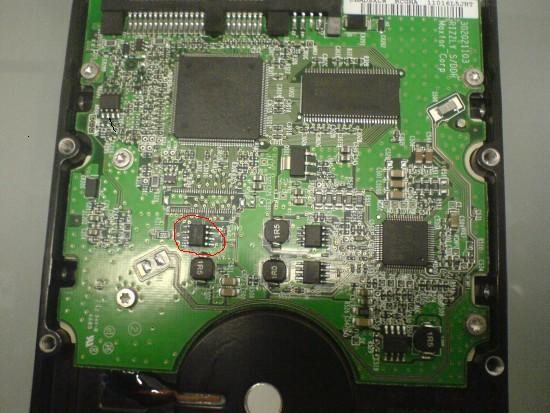

U can unsolder the serial ROM, and solder on un donnor , post us here the picture from u PCB HDD Spaz,
 Post subject: Re: Maxtor Grizzly Head Map in ROM?
PostPosted: February 26th, 2009, 12:01
Posts: 1493

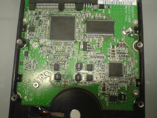

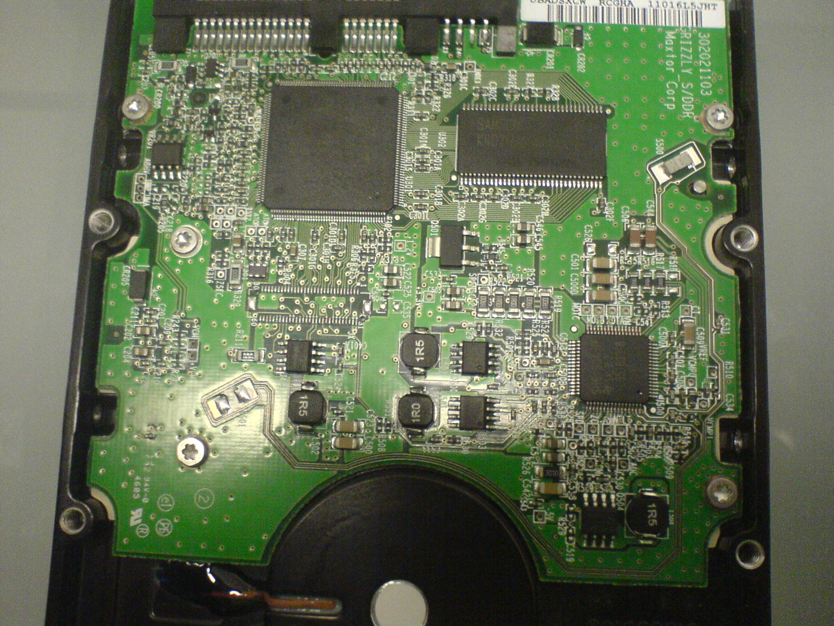

Sorry about the pic, just took it on my mob.
File comment: Grizzly PCB
PostPosted: February 26th, 2009, 12:12
Posts: 411
Location: Romania
I think this one is

HDD Spaz wrote:
Thanks. Everyone else agree?
I have no similar pcb in hand, but if you post the numbers, i can easily select for you.
Now i have 3 votes:
The one, wich was markbed by ccc, the closest to the Q501, and the one wich is on the MCU left side.
(The others can't be by the pcb's connections....)
Janos

Can you read the marking on the ICs and post ? Beside this (external ROM), there is code IN the MCU (the big one). External ROM is for patching. Way of working similar to serial Calypso for the drive itself.

I just got a similar drive in. That is indeed the ROM. The one on this drive is a 25VF010.

Confirmed 100% it's the external flash (SPI)
