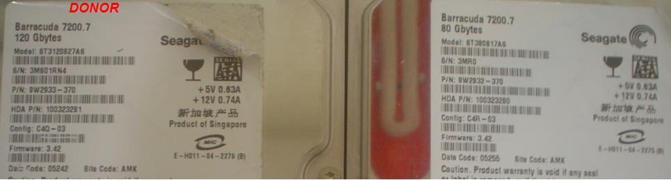

Hi gurus! :mrgreen:
PATIENT HD 80GB
DONOR HD 120GB
LOOK PHOTO...

Hello sempre donnor its 120gb,and u patient 80Gb (2Heads), the head map will be different, check that 80GB i had check that´s models has some tendence to head crash

Sempre, have you change heads for that model, can you post the results.

There will be a head hanging free, but it should work fine. :-)

Yep :wink: need delay time to initiate at first time when using DE

Yes, heads compatibles!!! :mrgreen:
DE PCI it read the data, to put I am with problems to read the folder my documents…. :shock:
Help?

When making the exchange of heads I perceived superficial risks in platter side 1 next to the center to the platter. Ready HD I started date recovery and after one twenty minutes, clicking started… now sees log of the terminal

I think that heads are gone.
Have you try on / off and wait some time.

I waited and I bound today continues the same with log in the terminal… :|
possible e through some command in the terminal to decide this again or alone changing heads? :?: :mrgreen:
