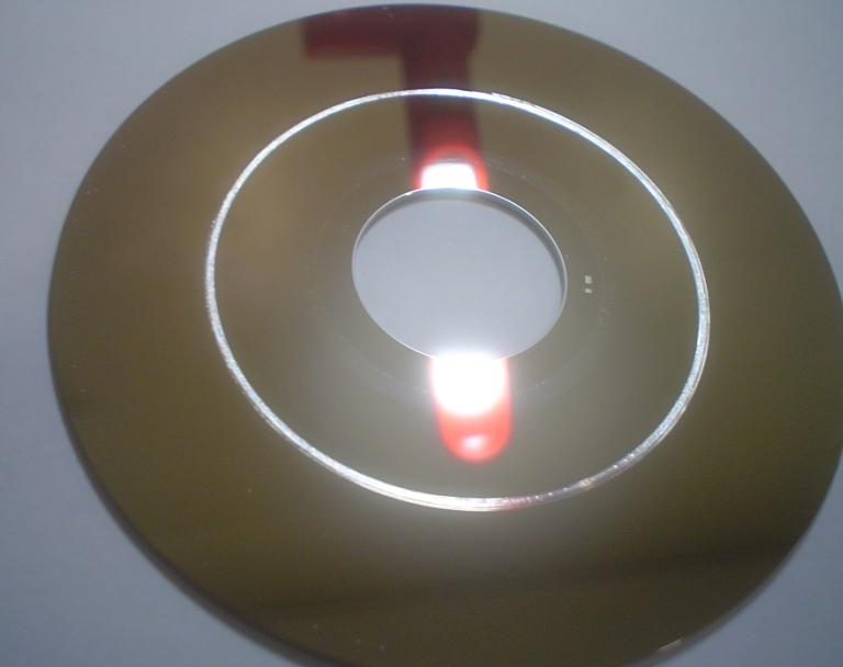

Hi to all!! :mrgreen:
Log terminal
T>Interface task reset
4096k x 16 buffer detected
PUMA - 1_Disk 0.07 09-26-04 14:00
Head Mask FFFF - Switch to full int.
Spin Ready
3.42 09-26-04 14:03
(P)SATA Reset
AutoRd Err 43 at ffffffff.00.0002
$Switch to full int.
AM Reacquired
AutoRd Err 43 at ffffffff.01.0002
12
Initializing SMART Sectors$Switch to full int.
AM Reacquired
AM Reacquired
AM Reacquired
NIWOT TIME OUT
AutoRd Err 43 at ffffffff.00.0110
Read Ver Retrys
AM Reacquired
AM Reacquired
NIWOT TIME OUT
AM Reacquired
AM Reacquired
NIWOT TIME OUT
AM Reacquired
$Switch to full in
BUSY and clicking
Heads good

 Post subject: Re: ST LOG ERROR
PostPosted: March 9th, 2009, 15:11
Posts: 1060
Case end. :cry:
Platter bad... :!:

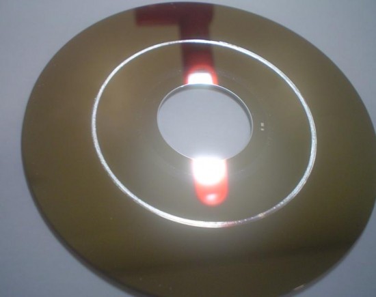

zebong wrote:
Sempre,
Did you open and see the plate ?
Thanks all replys!! :!:
In the first exchange of heads recvery 45 files jpg and gave the error that this in this post. In the second exchange (heads) when having access way DE PCI to folder to recovery started to beat and made a strange to open hdd look the damage when platter… and possible racket? here it is the question that does not want to be silent…. :?:
Look platter(head0 crash)
