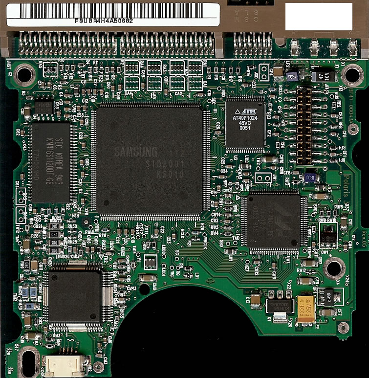

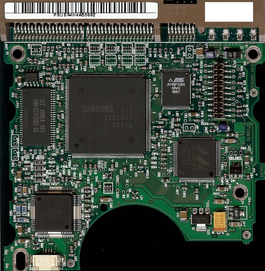

Hi to all,
Need some help in this disk.
The disk came to me but dont spin, i change the pcb with a looking pcb and connect the disk, i can see that disk now spin, but i just can have DRD, in terminal appear this:
U H:  +00000
H:  +00001
H:  +00002
H:  +00003
H:  +00000
H:  +00001
In there anyhting i can do this pcb "remove chip" for have the disk working?

I am not "fully" familiar with samsungs....Dont get to many of them.
I cant read the number on the chip, but i think the 8 legged chip in the top left above the RAM may need to be transferred.

No, the U3 is the good choice. ;)
Additionally, better to measure the preamp before trying another pcb!

Completely wrong : the code is in part in the SID chip , the main code is in the AT49F1024. There is no SPI external rom to be transferred.
Problem #1 : do the PCB belong to the same drive and code revision (SP4004 / xxxxx-yy) ? This PCB, with different main code, works on many drives.
Check the revision of the main code. If have no tools, the ROM should be read/reprogrammed externally (desolder it).
When I see the screws have been removed, I assume that some "Wile E. Coyote" engineering has done by end user or other so-called "expert".
Problem #2 : has the MC been poked or any FW 'fix' attempted ?
Note that main code AND overlays (on platter) must match for the drive to get ready AND eventually accept command !
Just in case , you know I can do EVERYTHING with Samsungs... ring me on IM.

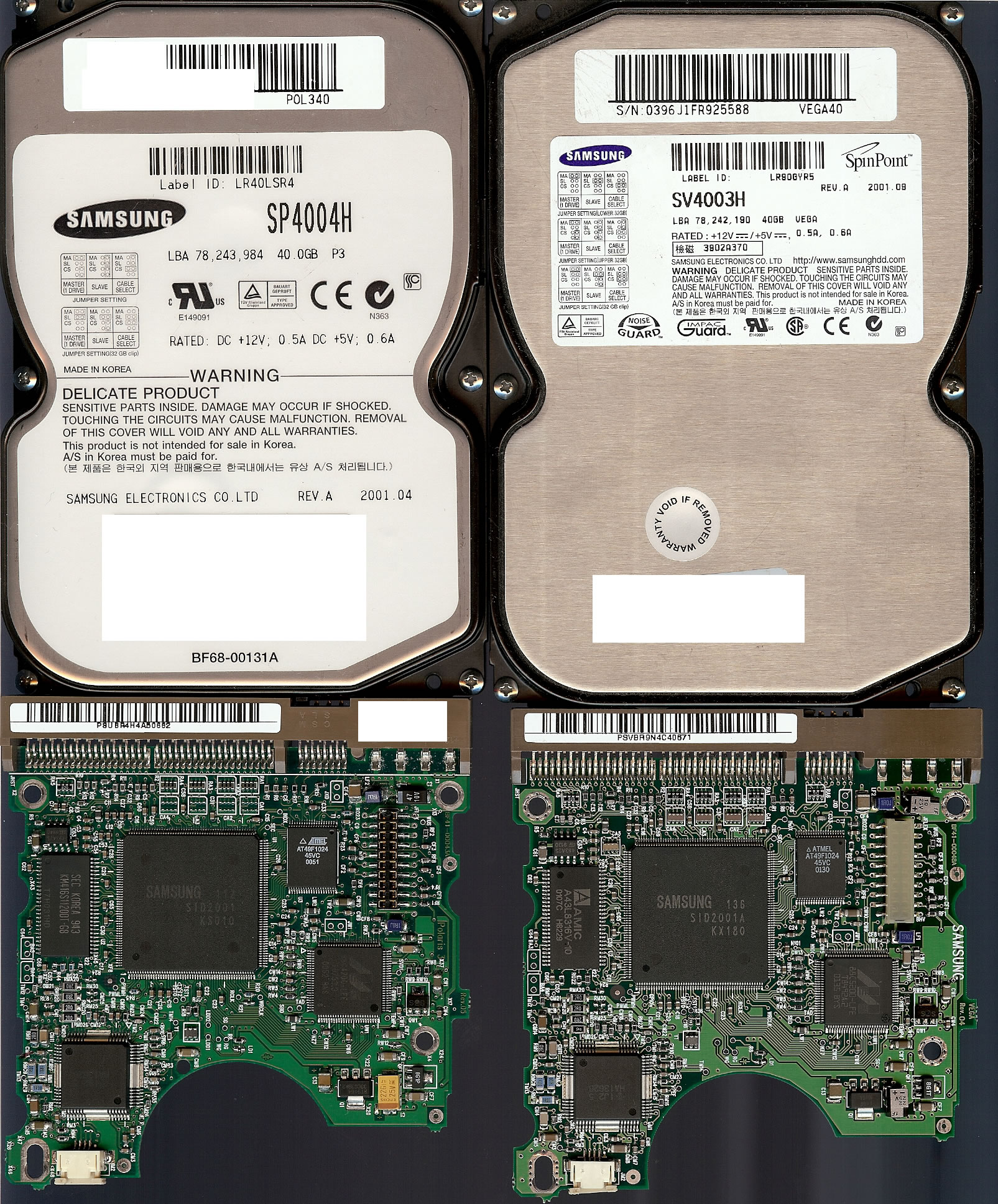

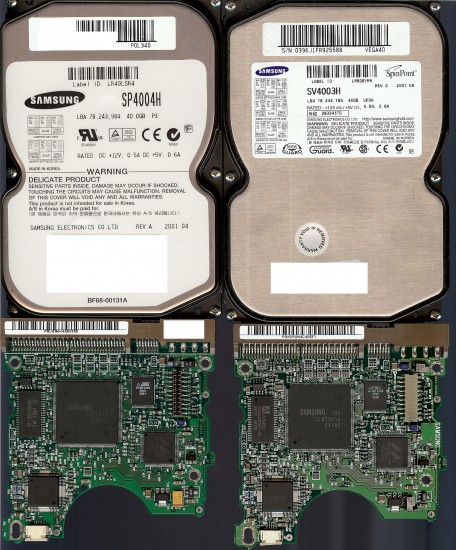

Thanks ,
I have scanner the disk with the pcb.
Since i dont have the same disk, i found a similiar looking PCB to try.
in this case it looks like the code revision is not the same.

The PCBs are somwhat different, but the problem IS definitely the main code.
