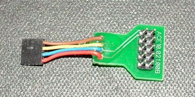

Well, I'm back from surgery and have been able to work on this project again.
Laura kindly provided a "clarification" of the terse instruction that Bruce sent to me. I have tried to reply to Laura before I did to this group, but her server is not accepting my e-mails at the moment.
After I initially installed the software, I had .DLL conflicts on start-up.
I figured out what to do with the firmware CD in the meantime.
While working with the device, I find that it is astonishingly easy to
freeze and crash the entire system . . . .
I saved the firmware from the donor drive. I then tried to upload the app code from the good drive to the bad one. Other than noting the flashing lights on the device, there is nothing on the PC screen that shows that there is work in progress, until the step is done and it says "OK."
I then tried to "Fix Firmware" after I uploaded the app code. Neither Bruce or Laura mentioned this step, but the manual did.
I then repowered the device as instructed and there was no improvement. I connected the "repaired" drive to the PC3000 and got the exact same message -- can't read app code. OK Laura or Bruce, what should I do next?

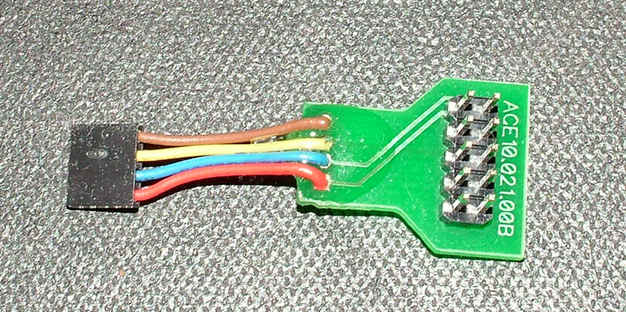

Other impressions thus far:
1. The 4 pin inline header that connects to the serial port of the Seagate drive is fragile and flimsy -- the plastic piece that surrounds the pins separates from the row of pins invariably becomes lodged in the drive -- you have to dig it out with tweezers to use it again, only to have it get stuck in the next drive. Attached is my solution (Ace has a similar adapter with the same tendency)
2. Apparently, the default location for saving the firmware is inside of the Program (application) folder. However, when I went to retrieve the file for uploading, the default location is the "My Documents" folder.
3. It's all in the details, folks. There are a lot of little things that need fixing to make it professional quality.
I await further instructions on this recovery project with earnest.
Jon
File comment: Connector fix

Hi Jon
Nice improvement for the serial adapter,this will help all members.It will improve salvationdata products as well.
Hddbug

Thanks, HDD bug. I wanted to point out -- it's hard to see -- a big drop of epoxy where the wires go into the board, to keep them from breaking. This step makes them last much longer.
Jon
