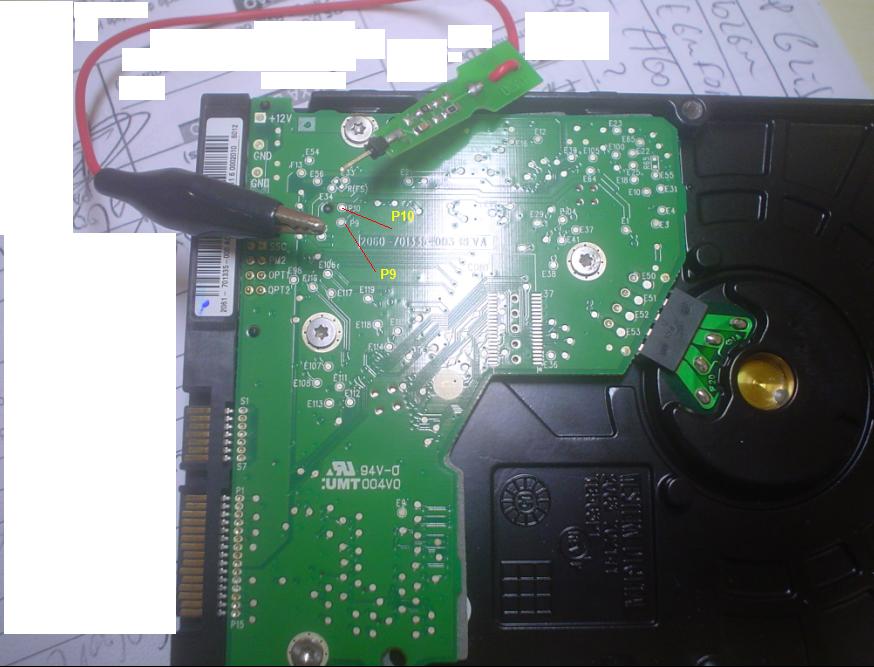

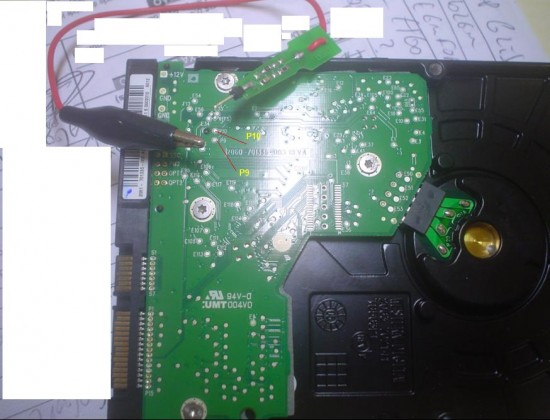

Hi to all! :mrgreen:
Please infos all gurus... (short circuit wd a knocking )
In P10? :?:
Look model WD400BD

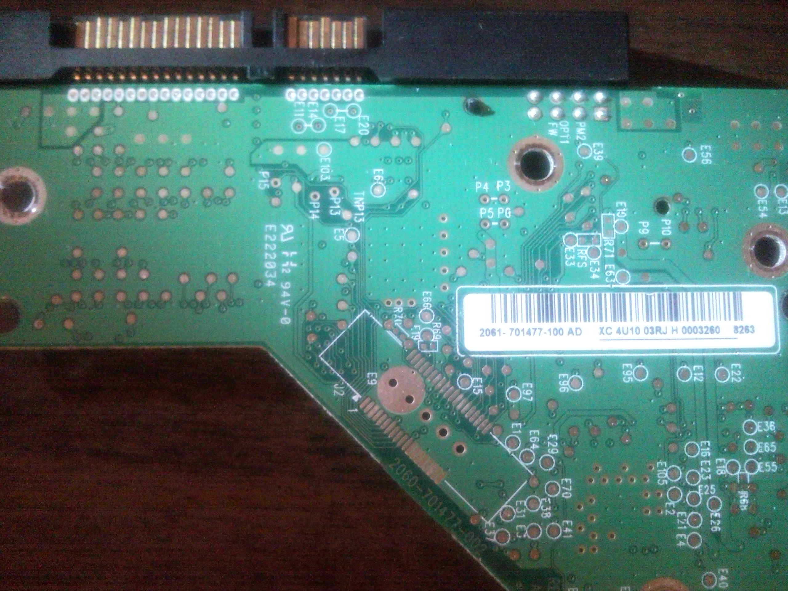

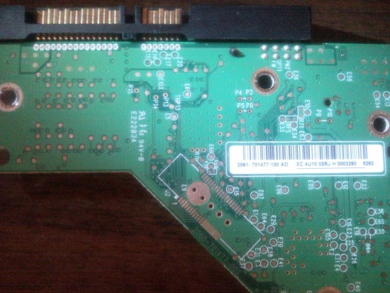

Shortcircuiting P9-P10 is supposed to reset the EPROM or what does it exactly do?
I have a few WD5000AAJS drives and I think this would help for a few of them...
Is P9-P10 on this board the same as on yours?
Thanks and Best Regards,
Tetris
File comment: PCB
 Post subject: Re: SHORT CIRCUIT WD
PostPosted: March 29th, 2009, 6:30
Posts: 2288
Location: In ur HDD !
It is to destroy Read/write channel data.
PostPosted: March 29th, 2009, 7:47
Joined: July 19th, 2008, 17:42
Posts: 64
What you are using to 'short' the pins out is an RC bridge and not a short.
PostPosted: March 29th, 2009, 9:32
Joined: July 8th, 2006, 6:18
Posts: 222
What's the purpose of using the probe on the photo, which obviously contains the said resistors and capacitors?
Does it belong to one of the big $$$ systems? I'm quite curious on this one :)
PostPosted: March 29th, 2009, 10:11
Posts: 791
It was used on Hitachi drives as a part of the method of password removal, but advances in understanding of microcode in the NV-RAM make the probes redundant.
the probe in the photos looks like it is one for the Hitachi 3.5 inch drives as issued with PC3000 so yes, it is the $$$ equipment .
https://www.mjm.co.uk/
PostPosted: March 30th, 2009, 7:56
Posts: 1060
This method has explanation in the manual of pc3000, but it does not have for the model that necessary, only this information that I need. This and the reason of first post.
Thanks advanced!!
