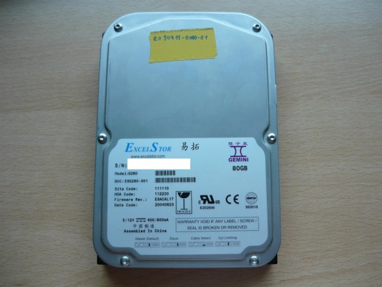

Hello gurus,
I have this drive with translator problem.
As far as i know, none of the "usual" tools supports this model/family.
Somebody know about any solution for this drive?
(A simple hotswap is too bad for productive result.)
Thanks,
Janos

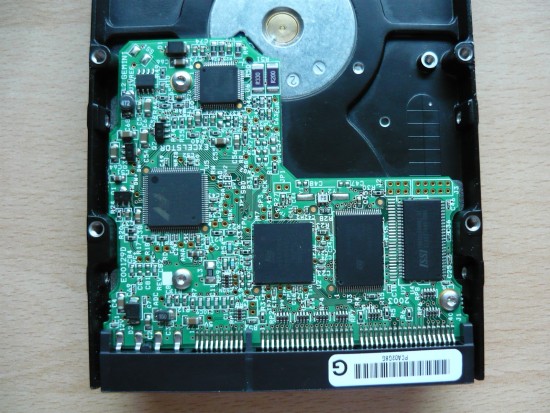

These are actually Hitachi Drives, well the ones I've come across anyway.
Just find out which series it really is, and use that tool, with manual entry to the utility.
Look at the PCB, that'll give you a good idea what family it is.

Thanks for reply.
I have seen some Excelstor drives wich was a refurbished hitachi, but this is the original excelstore!
The PCB is L shaped, and a little more looks like to maxtor than hitachi. :(
(Based on the pcb design, and used chips, components...)
Thanks,
Janos

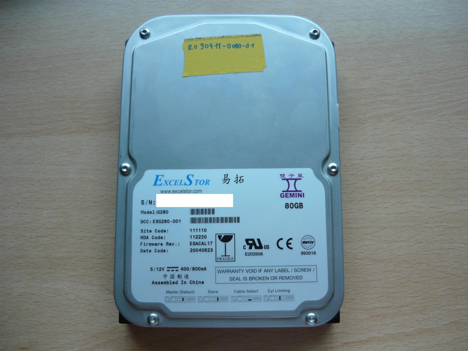

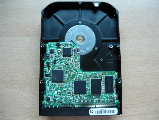

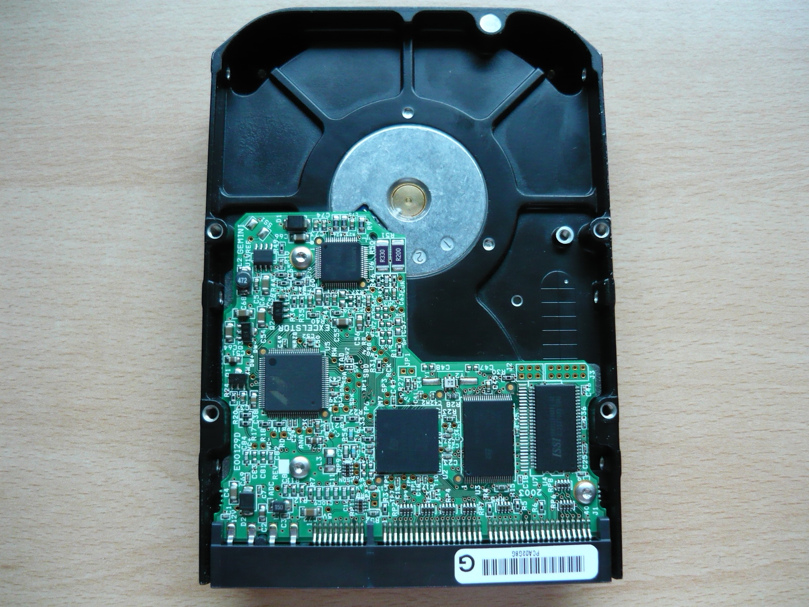

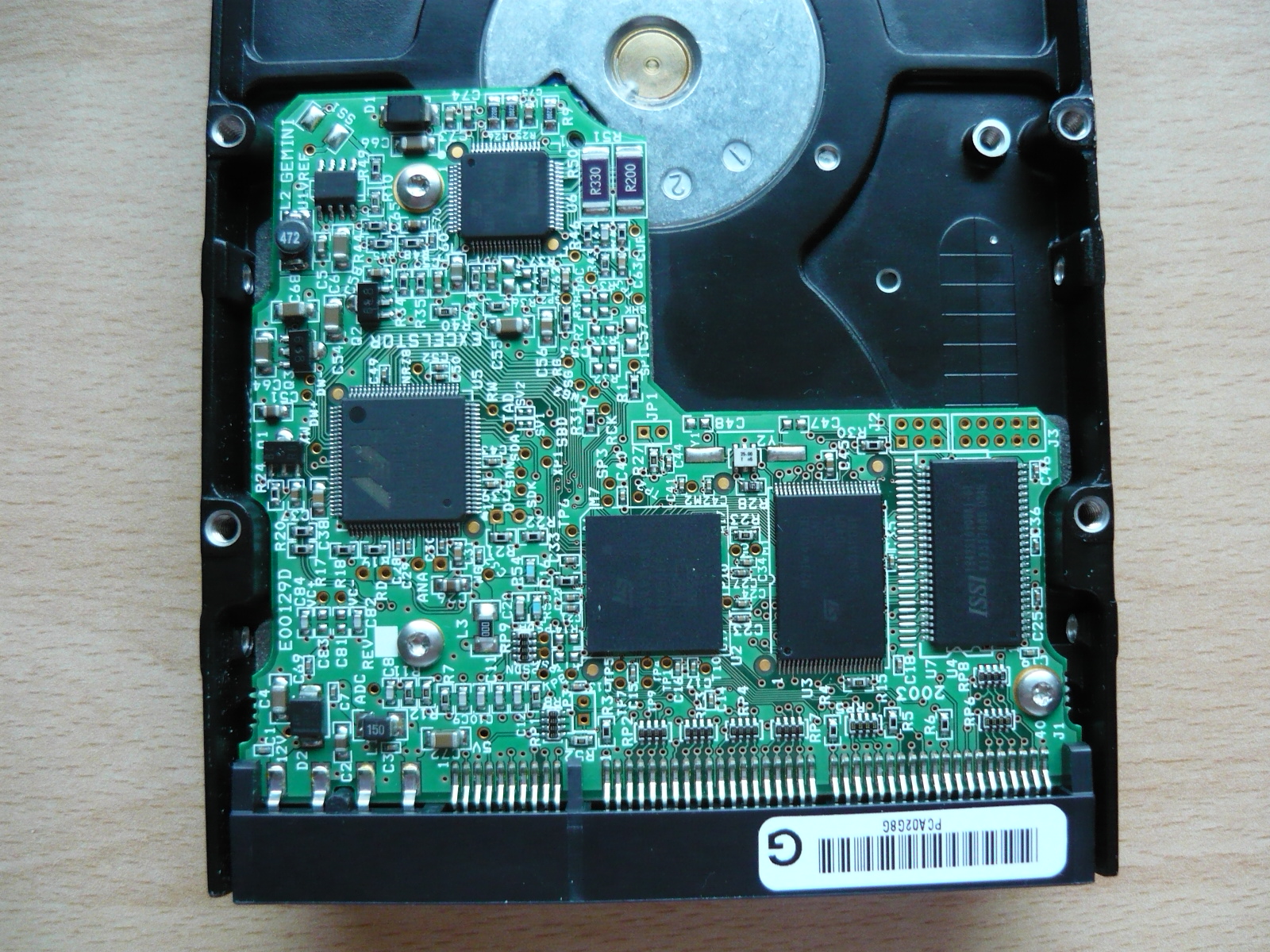

No, guys, this is not one of the hitachies.
this is a unique one.
Janos, please post herre some pictures to prove :)
 Post subject: Re: ExcelStor ESG280-001 With translator problem
PostPosted: April 14th, 2009, 12:29
Posts: 1466
Location: Europe, Hungary
Pepe,
Here is the picture. :)
