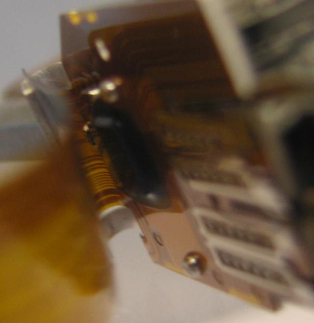

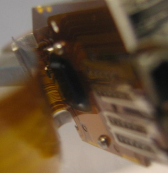

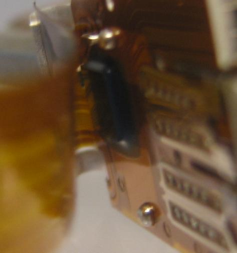

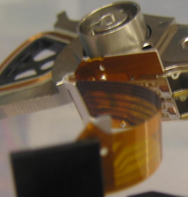

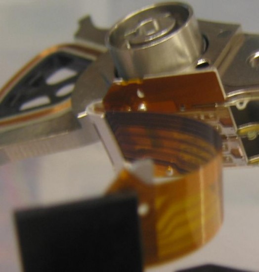

Take pics of the little PCB's inside the drive (that connects the head stack to the PCB, through the drive).
Re: Seagate Terminal
May 6th, 2009, 8:44
pcimage wrote:Take pics of the little PCB's inside the drive (that connects the head stack to the PCB, through the drive).
Hi sean,
DONOR:
GL4-T
AGA2-B
PATIENT:
GL4-B
TI-B
I think that the first do not match by a letter
Dont know is this have to macth all?
ZeBong
