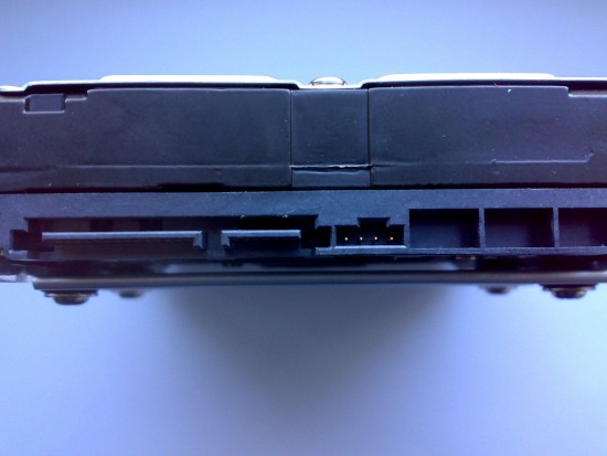

Does anyone of you here know what the size or dimensions are for those small pins found in the jumper-block area of a HDD?
You see I have this SATA HDD from Seagate that I need to repair and to do that I need to wire it's TX and RX pins. I can't possibly solder the wires to these pins, it's practically impossible to carry out, and if you do manage to do it, it will leave marks on the pins or even destroy them. So the best way is to use some jumper wire which has a small pin header on it, but I can't figure out what dimension those headers would need to be. Any ideas?
This is a SATA HDD, and not a PATA which means it does not have many pins in the jumper-block area and the surrounding plastic is very close to the pins which is why it's hard to do any soldering in that tight space. I'm not so familiar with this, but I would guess that the pins on a SATA disk are the same dimensions as on PATA disks. But does anyone know what those dimensions are? I'm pretty sure it's some standard dimension, so anyone familiar with electronics in general should know it.

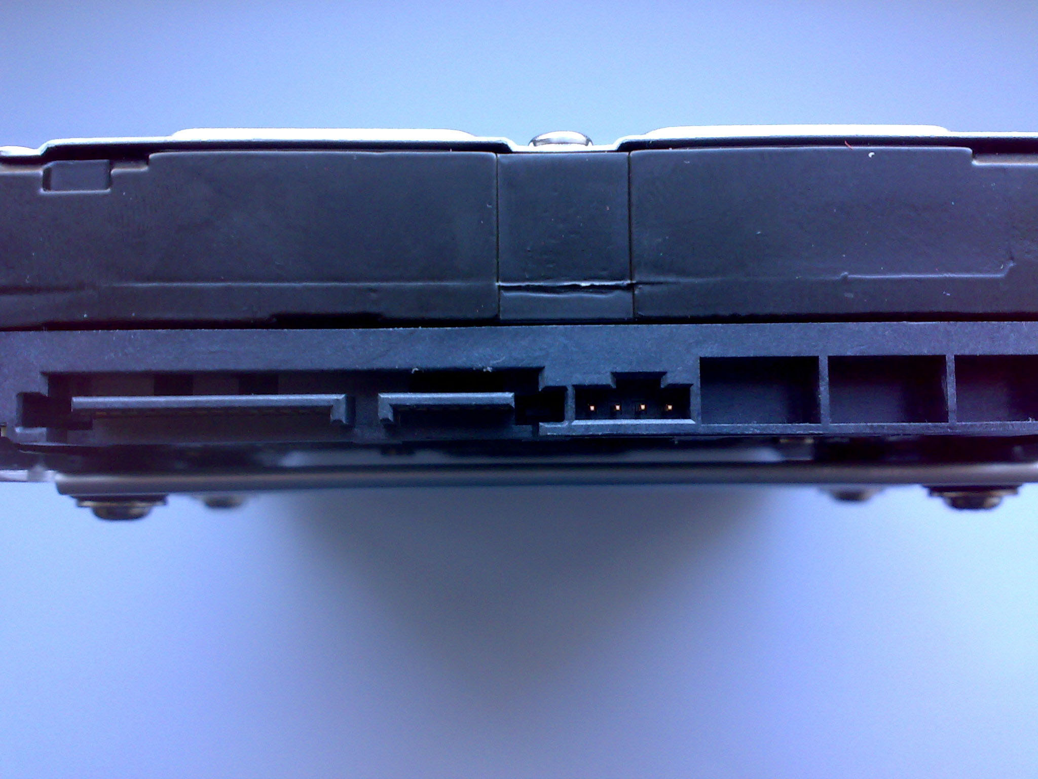

Now, this is my SATA HDD:

I think this is easy to solder in 2 wires in this place. :D
It depends only in the soldering tool and the skills....
Anyway, if you have only one drive to fix, i suggest to use one old ATA-33 cable's wire, simple cut out 2 line, and without blanking it, simple push them into the pins.... :)
This can do what you want.

No offense but this is probably the easiest part of trying to repair your hard drive. If you're not able to make it happen then I don't know what your plan is for the rest of it.

I just stopped by here again to update you all on the progress of my repair work. I'm proud to report that my Barracuda HDD has been successfully restored! 8) FYI, it's a Seagate Barracuda 7200.11 HDD with 500 GB capacity and the SD15 FW. Model number is ST3500320AS. FWIW!
The main problem
The problem with it was that it was locked in the BSY state. I think the problem occurred at some point when I was reading a normal about 40-page PDF file in Adobe Acrobat Pro. Except for the uTorrent client which was bandwidth-limited to about 300 KB/s up-/downspeed, I didn't have any heavy applications running in the background when the Acrobat suddenly started to lag. Since this is not normal on my computer (it's a pretty powerful computer with C2D CPU) I was not so patient with it so I shut it down. When I launched Acrobat Pro again with the same PDF file I had no problem with it. But after reading my PDF and closing down Acrobat, I noticed in Windows Explorer that some or none of the partitions were visible that belong to this particular HDD. This used to happen to me on some rare occasions but was usually re-solved by power cycling the computer. So I re-started my computer just to find out BIOS couldn't see this HDD anymore. I remembered reading some news at some Tech site about Barracuda 7200.11 issues, and after hours of searching the Web that day I soon realized that mine HDD had all the common symptoms of a BSY error case. Talk about destroyed by a PDF file!
The parts and materials needed
Except for few 0.5 mm2 crimp sockets which I purchased at Kjell&Co, I had ordered all the materials and electronic parts I would need for the whole repair work from an online Web shop called Electrokit. For those of you resident in Sweden who stumble upon this thread and who are having this HDD problem, I'm sure you will find Electrokit as a good place to start your quest for the parts and materials. The most hardest thing to find is probably the TTL to RS232 adapter module, or an adapter cable of the same type. Electrokit has the original TTL adapter module by Sparkfun Electronics - the same model that Gradius2 at MSFN used in his recovery guide titled "The Solution for Seagate 7200.11 HDDs, How-to fix 0 LBA and BSY errors". ELFA (one of northern Europe's biggest electronics supplier) also has TTL to RS232 adapters in the form of adapter cables by FTDI. The most commonly used model for this kind of repair work is the TTL-232R-3V3. There is also a 5 Volt version of it, but I recommend using this 3.3 Volt version if you decide to buy this. They also have other TTL parts, just visit ELFA's website and search for TTL. English speaking visitors can use the ELFA website for international visitors.
As for the jumper pin dimensions on SATA HDD's which this thread should be dealing with, I had ordered some jumper wires (a.k.a. patch cords a.k.a. test leads) to use for connecting the TX/RX/GND pins on the jumper-block area of the HDD with the TTL adapter module's TX/RX/GND pins. Both the jumper wires and the TTL adapter module were ordered from Electrokit and made by Sparkfun Electronics (link 1, link2) of US of A.
The jumper wires had female sockets on both ends, but I also ordered a version which had female socket on one end and a stripped wire on the other, and I have ordered a 4-pole screw terminal and a 4-pole pin header terminal for PCB mounting to use with these. I didn't have to use both thou, I only used the screw terminal and soldered it to the TTL module. However, none of the female sockets would fit on the small pins of the HDD. The surrounding plastic was in the way. So in the end I didn't use many or none of these. They only fitted well in the jumper-block area on my PATA HDD. I have remove the plastic from the socket of the jumpers so I could attach them to the SATA HDD. But they were not fitted tightly on the pins, they were very loose so I didn't use them. Instead I made my own jumper wires and the crimp sockets (JST branded) I got fitted perfectly on the HDD pins.
The hardware setup and recovery
    Here is what I did.
  1. I soldered the 4-pole screw terminal to the TTL adapter module.
  2. I cut and stripped two short pieces of regular mounting wire and screwed one to the GND pin and the other to the Vcc pin on the TTL module.
  3. I cut two longer wires for the TX and RX and attached regular 0.5 mm2 crimp sockets on one of the stripped ends.
  4. Then I isolated the crimp sockets with electrical tape before connecting them to the TX and RX of HDD, and then I screwed the other stripped ends to the TX and RX of the TTL module.
  5. I attached two of the female socket to stripped wire type of jumpers to the CR2032 battery holder in one end and then connected the stripped end with the stripped end of the two short wires for Vcc and GND I previously had made. I used two test leads with crocky clips to connect these to avoid unnecessary electric shots. Twisting them together will work fine too just remember not to put in the battery yet or attaching the power supply (which is even worst from the safety point of view). I just used this simple setup with a battery to power the TTL circuitry.
  6. I placed the battery into the holder and connected everything and it was ready for use.
The aftermath
The only issue in this whole procedure was that the RX and TX wires were flipped (RX to RX and TX to TX) so I didn't get any response in the terminal. But after swapping them I got to the command prompt in terminal ans successfully recovered the HDD and it was recognized in BIOS. I upgraded the FW from SD15 to SD1A successfully. This HDD problem occurred exactly on Wednesday of April the first (2009-04-01), and I had it all solved on Monday of April the 20th (2009-04-20). So it was all solved within about three weeks. That's not so bad I think. If I had to send the HDD to i365 UK (a Seagate company) as Seagate Technical Support has suggested I might have lost my data forever. I don't care much about the HDD as much as I care about the data - that's the part that matters to people. I have spent 716 SEK (~64 EUR or 83 USD) on parts, materials and tools for recovering my HDD. But to me, it was worth it. I don't think I would have gotten away cheaper if I had went to a "professional" DR company, it would probably be at least eight times the price, in best case. I base this on the information from the user called Alexx at the MSFN thread above who lives in Sweden and had called around to local DR companies to ask for prices. But even if it would have been cheaper to go to a DR company, I still wouldn't do it. I enjoyed doing it myself, and what's more I have gained knowledge in the process.
The HDD jumper pin dimensions
I probably didn't need to be this paranoid about the jumper pin dimensions, but I didn't want to risk anything. Since I have recovered my HDD I have done some research and I also chatted with Seagate Technical Support. According to Quincy T who I chatted with, the pin pitch should be 2 mm for SATA HDD's. He was unsure of the thickness, but he said that all 2 mm jumpers are uniform so there's only one thickness. He linked me to an Knowledge Base article at Seagate's site.
Seagate and Maxtor ATA drives normally require only one jumper size, 4 mm. Seagate and Maxtor SATA hard drives sometimes require a jumper to modify the transfer rate at which the drive will operate, and this jumper is 2 mm.
Source: What are jumpers and where can I get them? What size jumper do I need?
