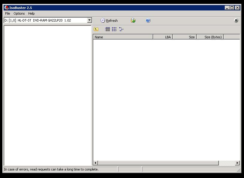

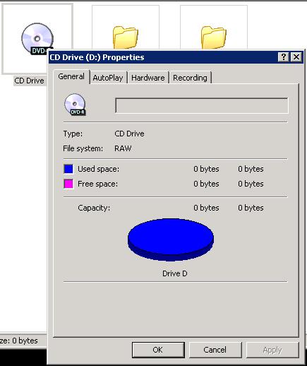

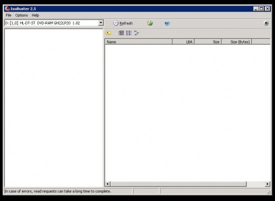

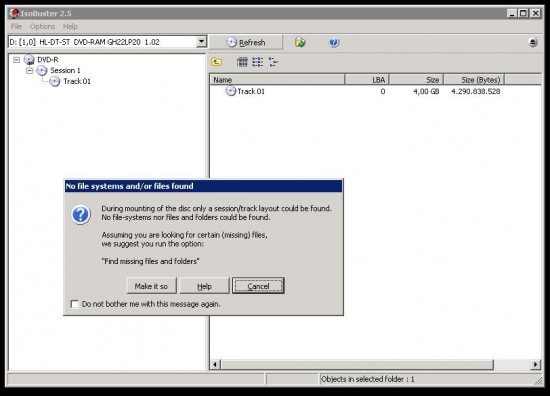

Thanks for the Help,
But the problem is this:
I think the cd is BAD
ZeBong
" Россия еще раз"

If it asks for a password, then it is likely to be password protected :shock: . Have you tried creating an image of the drive with Winhex or X-Ways? Can you post a screenshot of the password dialog box that you see?

I would also be interested in the sector view.... is it all zeros?

I can not edit, any sector, it take a lot off time, and it appear as BAD SECTOR
Will try to read it in a MAC to see the result, maybe the CD is not reading!
Will post them the result.
Thanks to all

That does sound like read errors.... I would suggest using ImgBurn on the PC to make an image of the disc. It will tell you if its having read errors or whatever the problem is.

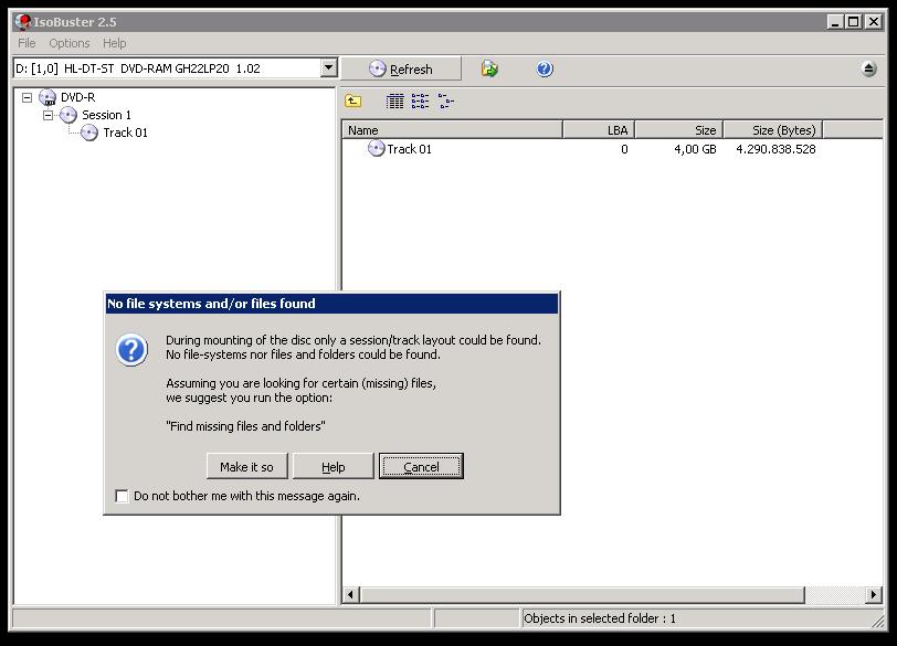

Hi Again,
I try to read the dvd on the MAC, but the problem is not password protect .....
No the client say´s that can not read the CD :evil:
i try in the PC with other ODD and now i could get 1 track with ISOBUSTER, but nothing there.

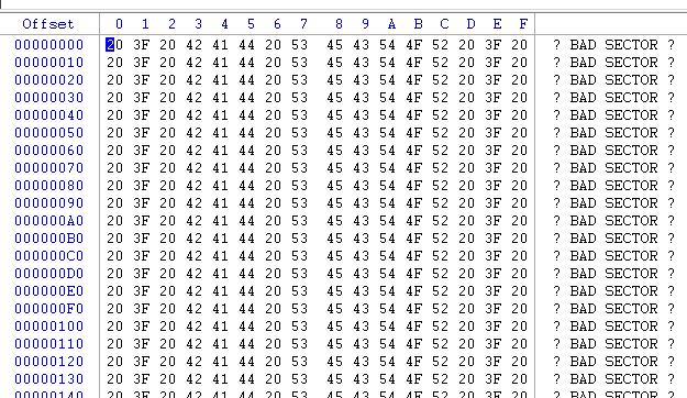

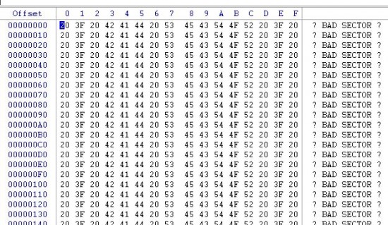

i try to edit the sector with winhex and it give error in sector 0.
ZeBong

It's a closed DVD, noyt a hard drive !!! Why did you think that you could "edit" something on a DVD that is already written ?
when i say "edit" off course i can not edit/write a CD/DVD, but i can see the sectors.
ZeBong

Did you try to image it with imgburn or something else?
