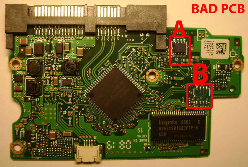

The PCB on my Hitachi DeskStar hard drive went into smokes after connecting it to a newly purchased SATA to USB adapter. So I replaced my fried PCB with an identical board and now the drive spins but is not recognized by the BIOS. After doing a little research I found out that I was suppose to solder a chip (NVRAM/Rom) off of my fried PCB and onto my new PCB. But I am confused about which chip this is.
Here is the image of the bad PCB:
The section that I have labeled as A reads;
S93C76
ADVH4
8476
And the section that I have labeled as B has no visible chip.

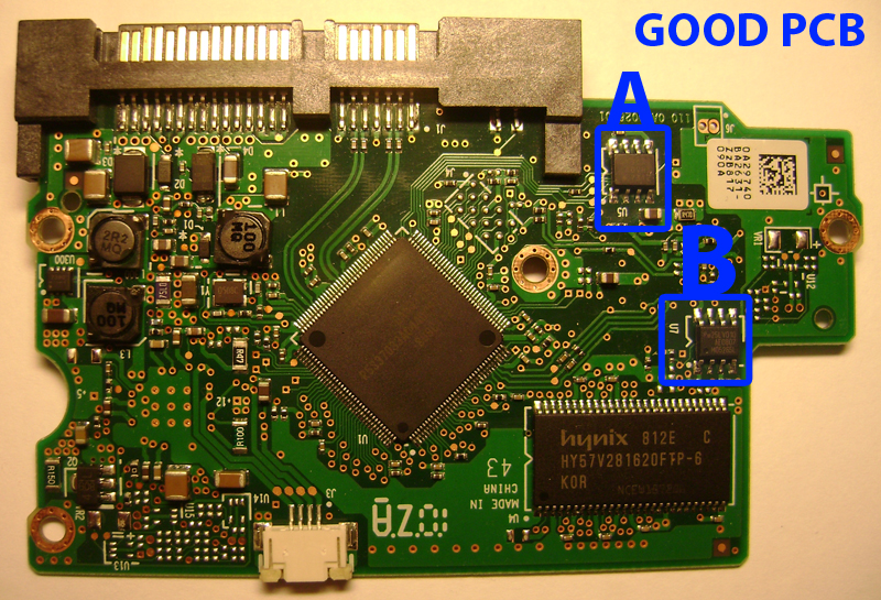

Here is the image of the good PCB:
S93C76
ADVH3
7312
The section that I have labeled as B reads;
Pm25L V010
AE0807
M05265L

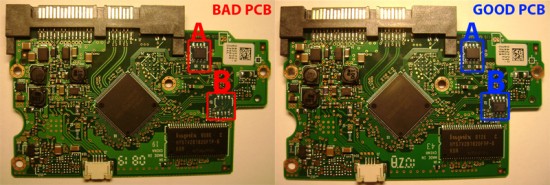

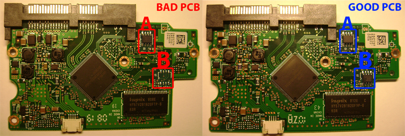

And here is a comparison image of the two;
Why does my bad PCB not have a second chip like the good PCB? Also, do I solder Chip A off of the bad PCB and onto the good PCB? Any help would be GREATLY appreciated. I had a company quote me on how much it would cost for them to recover the data and its way out of my budget.

Yep, switch A and you should be okay. The contents of B exist inside the MCU on your original board.

Without having it in front of me, I would say that A is the NVRAM and B is the ROM, which is sometimes in the MCU.

Hi
First of all, backup all the memories before any try!!!
The missing one is an external rom, wich can be different form the other board, so it can corrupt your NV-RAM as well!
Janos
