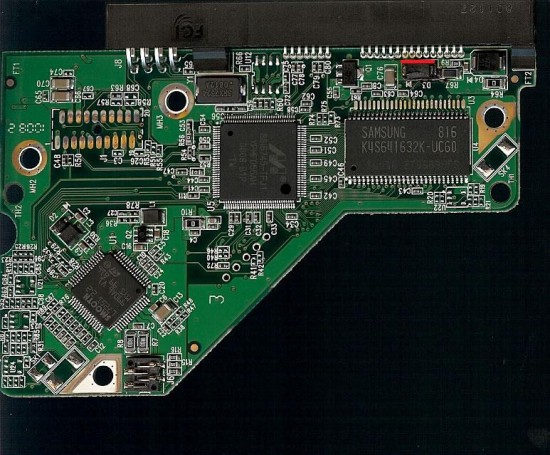

Hi to all HDDGURUS,
I have a WD that the PCB is burned, and dont have same exact macthing number.
What can i do here ?
ZeBong

What's the number on that one? Can't see it on your photo. Also that part may just be a TVS?

PCB NUMBER
2061-701552-G00 10P XT 5009 2326 6 0001440 8 441

 Post subject: Re: MARVEL FAMILY PCB BURN
PostPosted: April 17th, 2009, 11:12
Joined: May 30th, 2005, 17:07
Posts: 546
U can remove/replace Transil D3 (SMAJ5.0A), and replace resistor R67...
Posts: 411
Location: Romania
90% that's a TVS....remove it and power on..
Rgds
PostPosted: April 17th, 2009, 13:59
Posts: 1466
Location: Europe, Hungary
The marked part is a TVS.
Remove it, and poweron alone (without the HDA) and use a FUSE in the 5V circuit.
If you are lucky the marvell mcu still good. 8)
PostPosted: April 18th, 2009, 22:40
Posts: 1729
I think you should replace it ( not remove it ) for your safety
you don't know what will happen again
maybe if you remove it and power on directly that will burn MCU
Good luck
PostPosted: April 19th, 2009, 16:30
Posts: 1466
This is why i sad, use a FUSE in the 5V line....
The TVS is only for transient filtering and overvoltage protection.
Generally it is safe to remove, but not for long use again!
PostPosted: April 20th, 2009, 10:46
Posts: 1421
Location: EUROPE
Thanks to all,
I have remove the TVS and just connect the PCB and always BSY, can not also enter in safe mode.
i will try to look for a PCB donor
