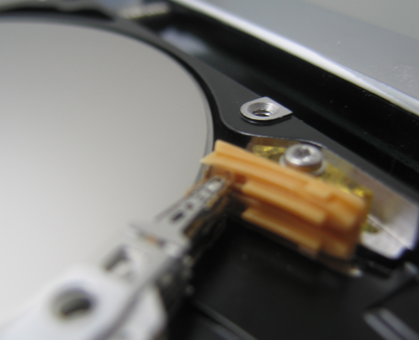

Hi to all hddguru, again, :)
Is possible when a cliente open the disk and touch the heads with the finger when the heads are stuck, them do something in the RAMP that is make a SIGN in the disk att the beggining off the plate like the picture show:
For your experience can anoyne tell-me if can i change the heads or it will be a wast off time and heads too ?

I don't think this is caused by a customer touching the heads; I have gotten a couple of these cases where the top head has magically loaded UNDER the ramp, and gotten stuck there causing platter damage on the very most outer edge as you can see in your picture.
In both of my cases this was not recoverable, but maybe someone else has had a breakthrough.

I have seen at least 6 of these in the last year where the heads are just not loading on the ramp correctly. I've only been able to recover 2 of them, the others were scored.

This is recoverable case... :)

yes the head 3 get loaded under the ramp.
i will try with the heads from the client, maybe i can get something.
First will look the heads at the microscope :)
Thanks to all :)

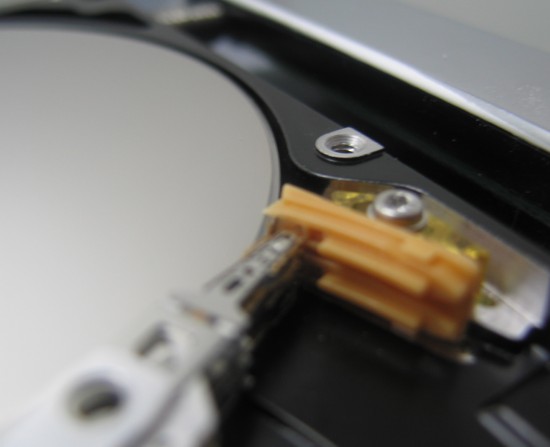

I guess it will be unrecoverable after this procedure

The drives I received seemed recoverable as well, but upon performing a head transplant the drive still would not identify.
The location of the scratch is under the ramp, where there is no data written to anyways. It is still worth a shot to replace heads, and see what happens, but so far I haven't seen good results working on these cases.

It is tough to say; when those cases came in I did not have a micro-scope, but now I do. Maybe next time I will be able to see more damage to the platters. I have very good eyes, but even the best eyes cannot see all damage in these cases

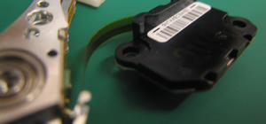

Hi again,
i remove the head and notice that the head 3 was gone.
i have a donor but the heads number are different, i can not see the pre amp chip.
this numbers are :
PATIENT:
5NTAXEC5W50
DONOR:
5DUE1H106P0
Anyone as looked at this numbers and use it as reference to matching heads?
ZeBong
ZeBong
" Россия еще раз"

i had same thing, the disk had not been opened.
wd800ue-scorpio-not-understanding-ramp-head-config-t11574.html
did you see any crap on the platters?
