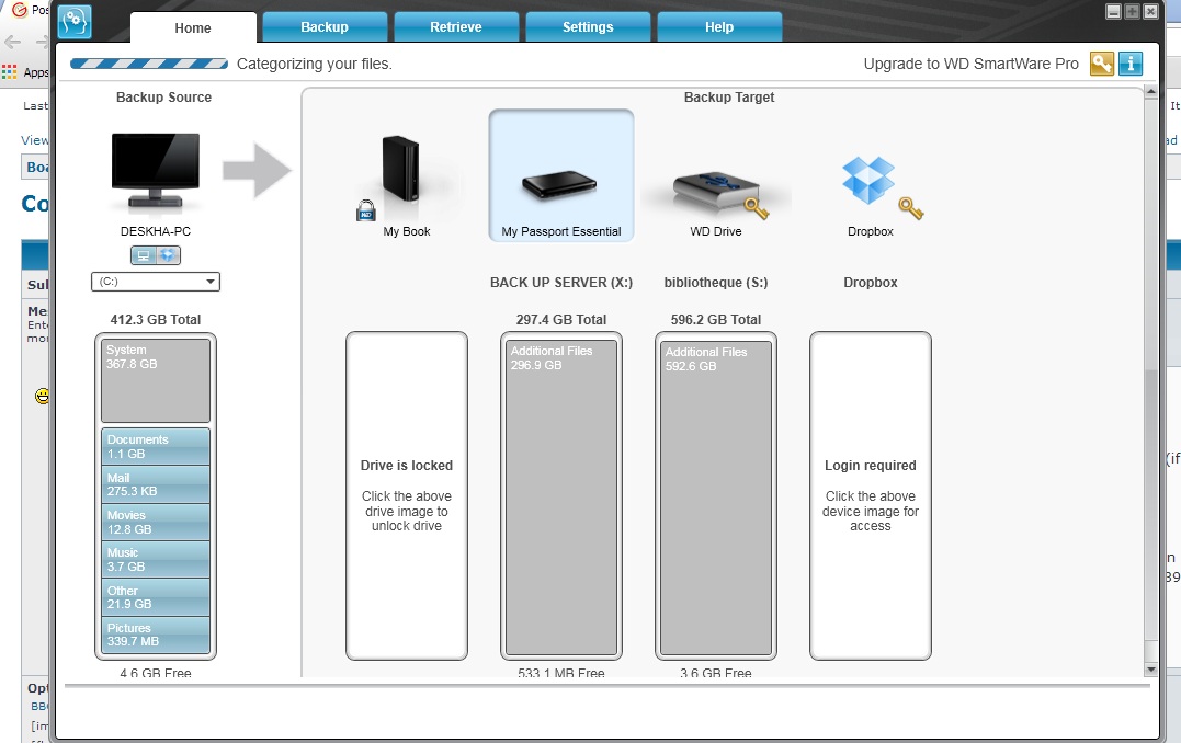

Here's the view on WD Smartware (after the ebay's new board replacement):

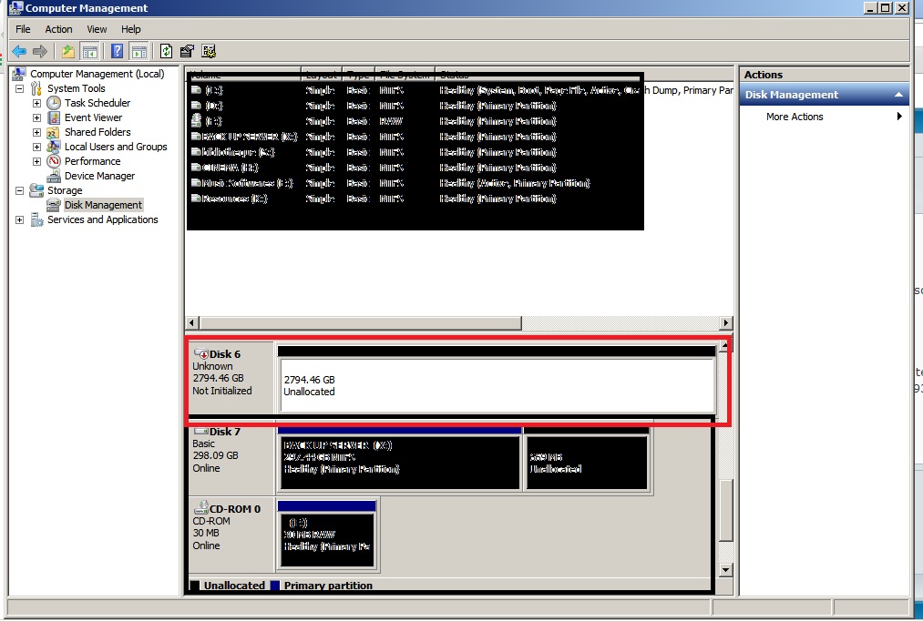

It's locked (due to too many password failed attempt While i never put any password previously

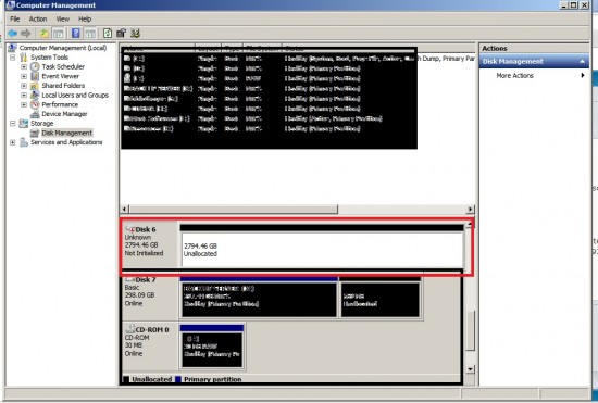

And here's the view of Windows' Disk Management (after the ebay's new board replacement):
(read as raw)

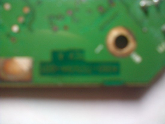

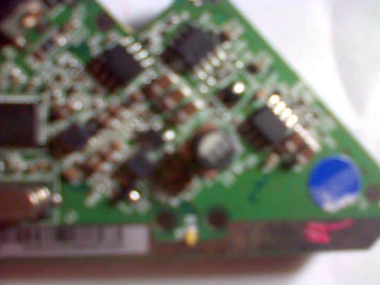

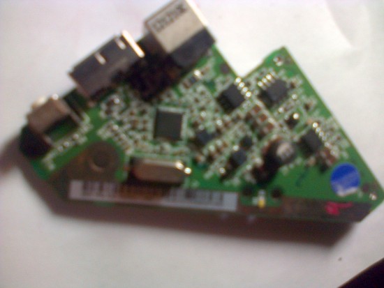

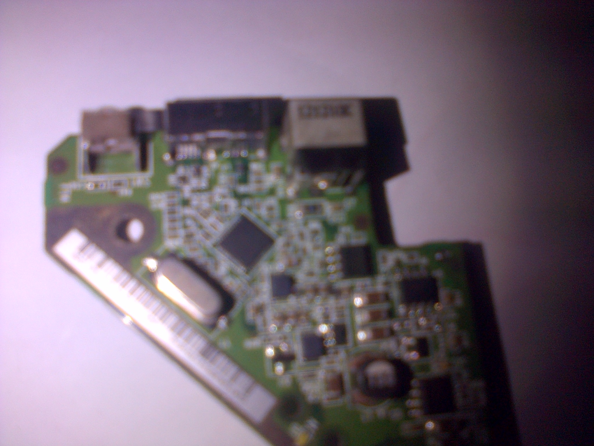

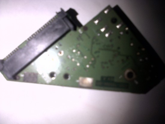

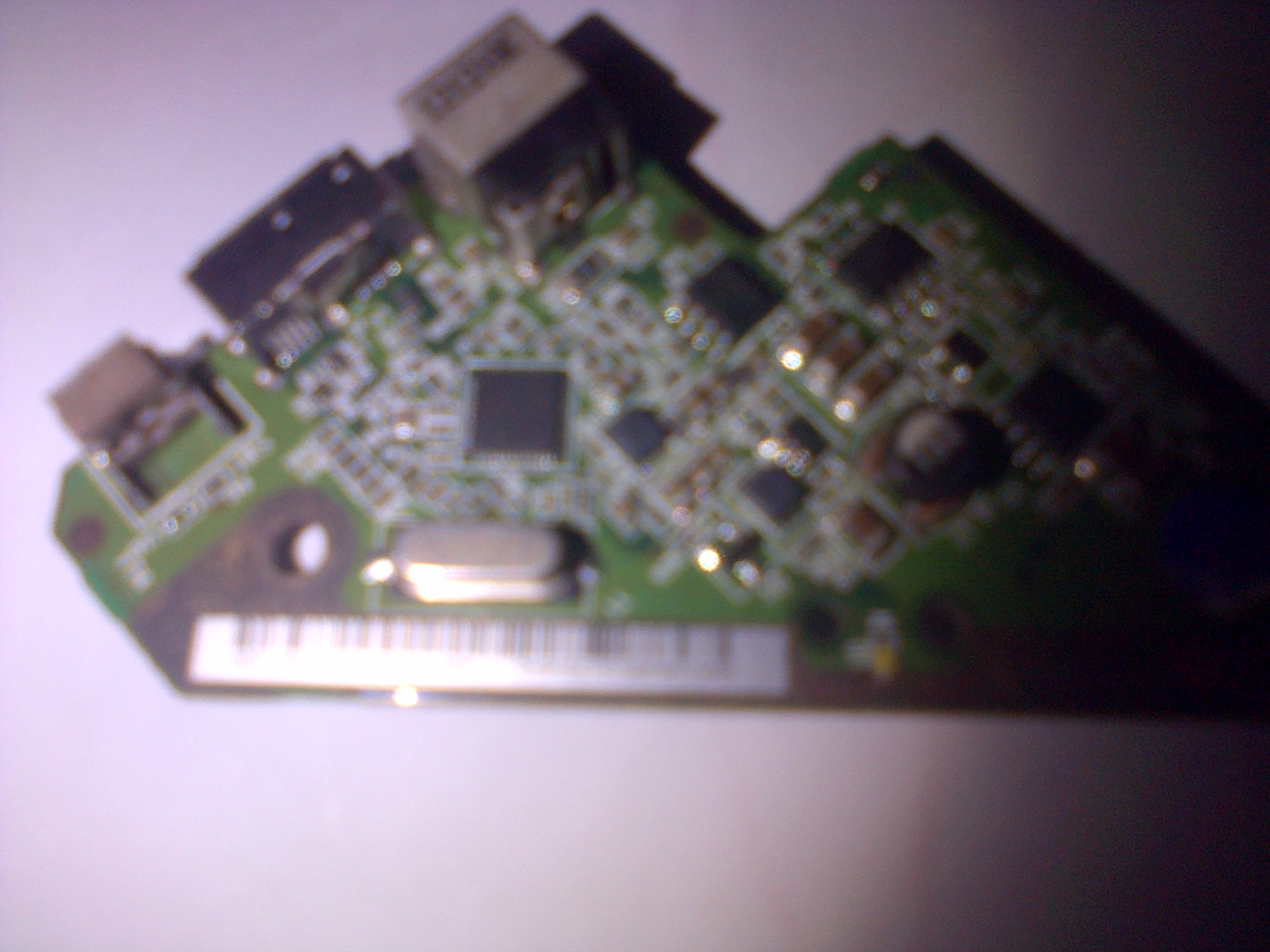

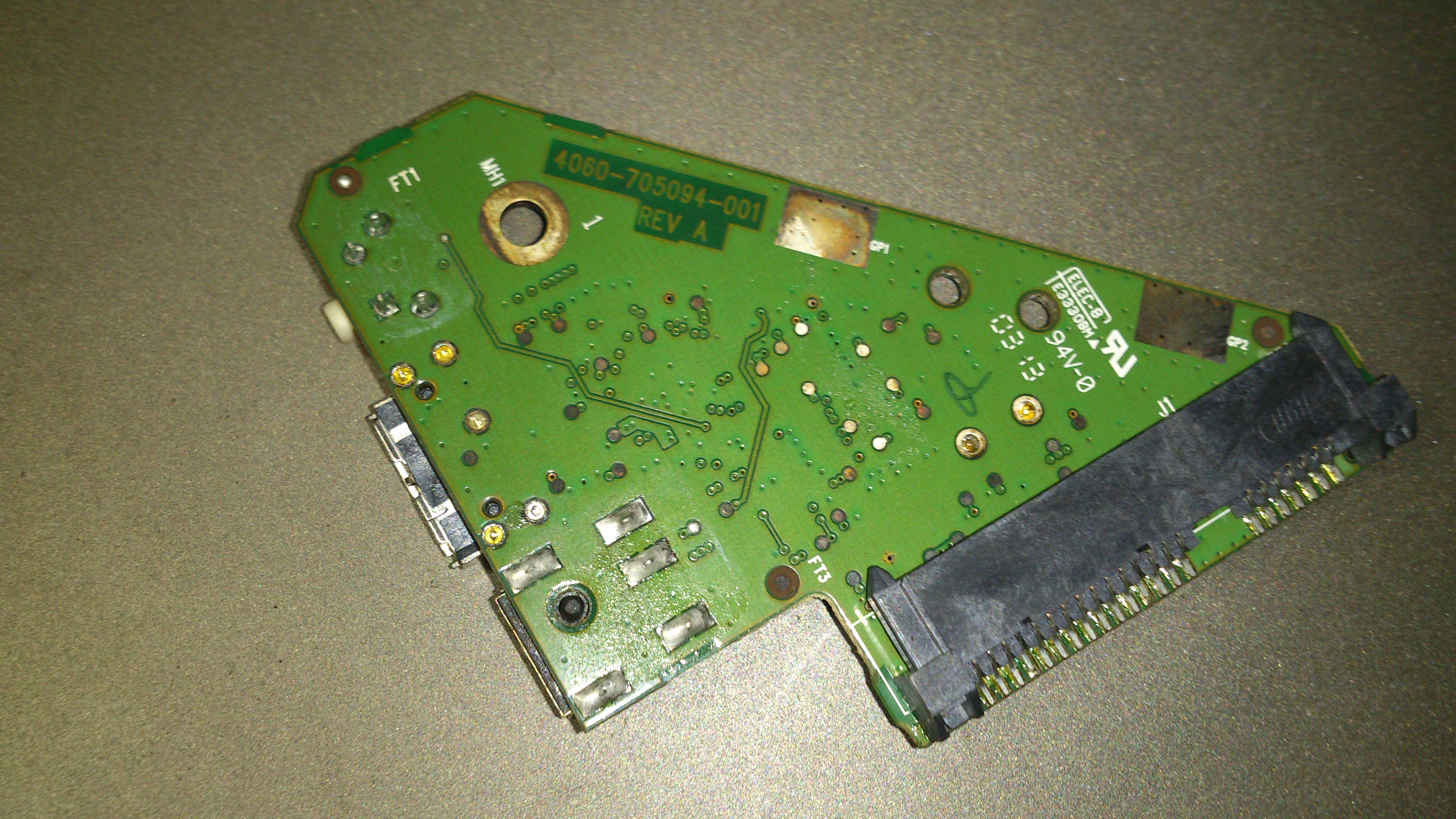

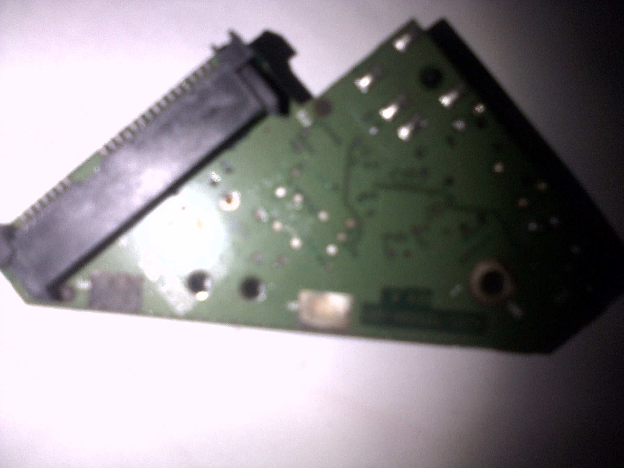

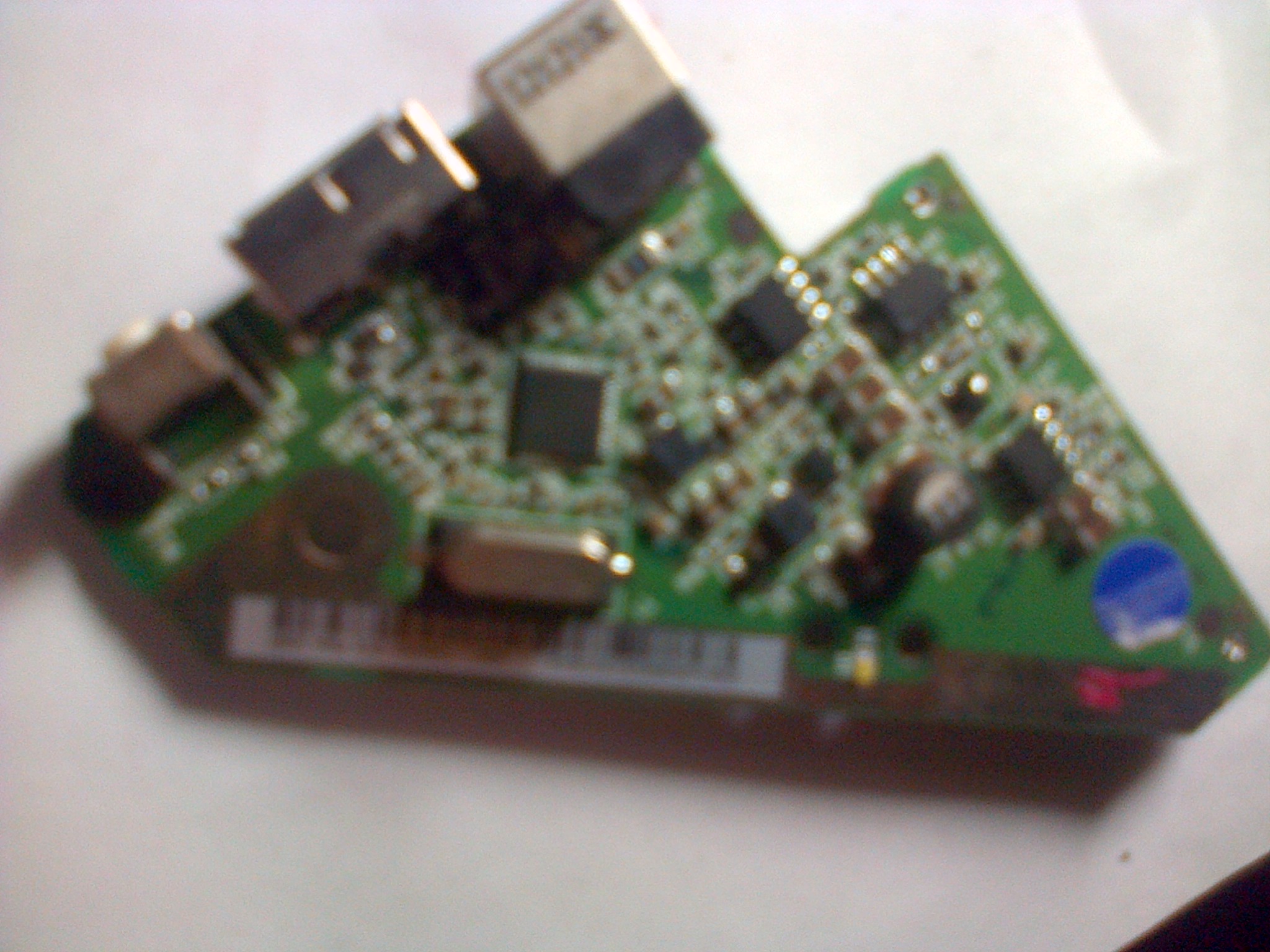

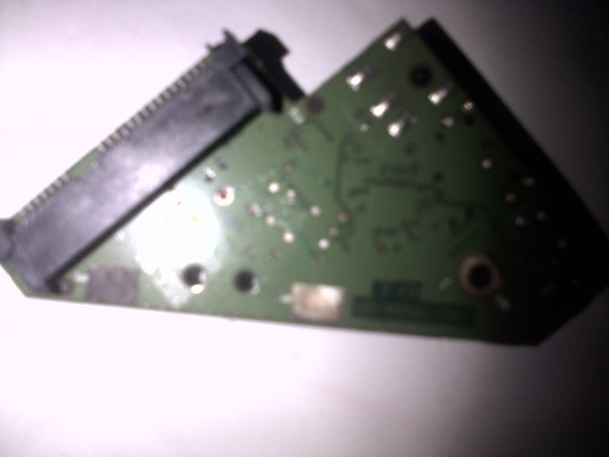

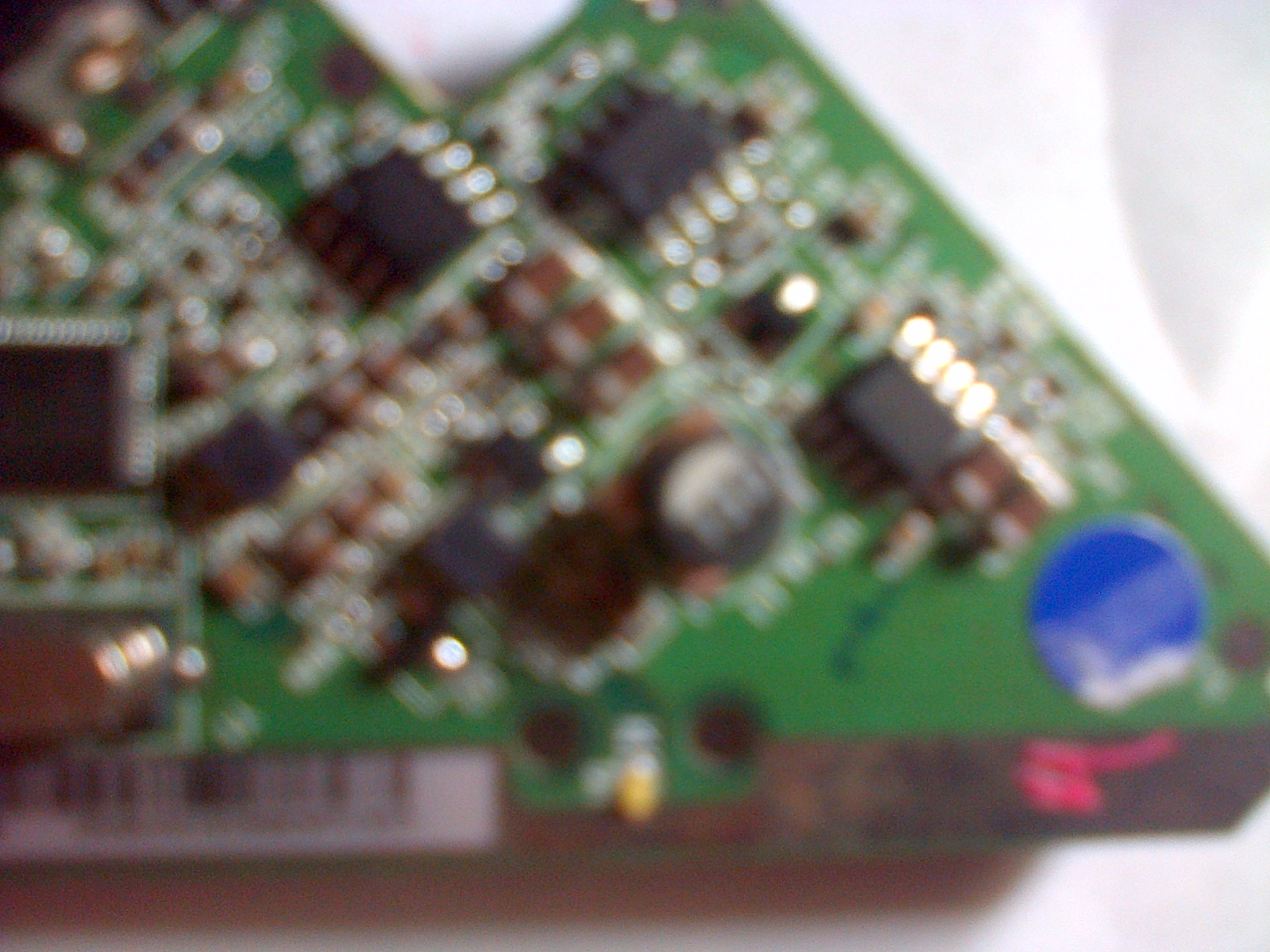

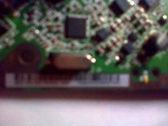

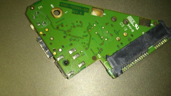

Pictures of the old board [if anyone interested]
Sorry for the quality, it was taken by quite old blackberry camera only
[spoiler=board]
[/spoiler]

I'd like to help you, but your photos are useless.
 Post subject: Re: WDC MyBook 3 Tb Replaced Enclosure Board and Data
PostPosted: October 1st, 2013, 16:33
Joined: July 2nd, 2011, 14:16
Posts: 463
yeah, need better pics, not much we can do, sorry.

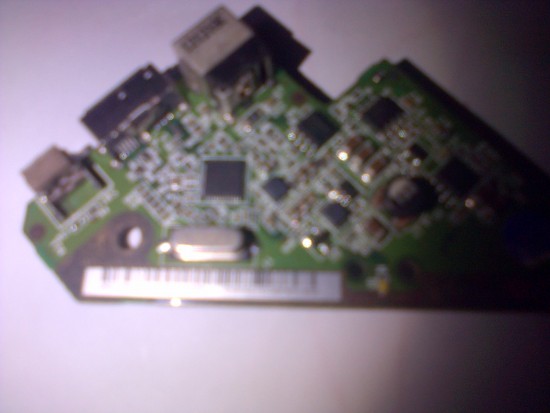

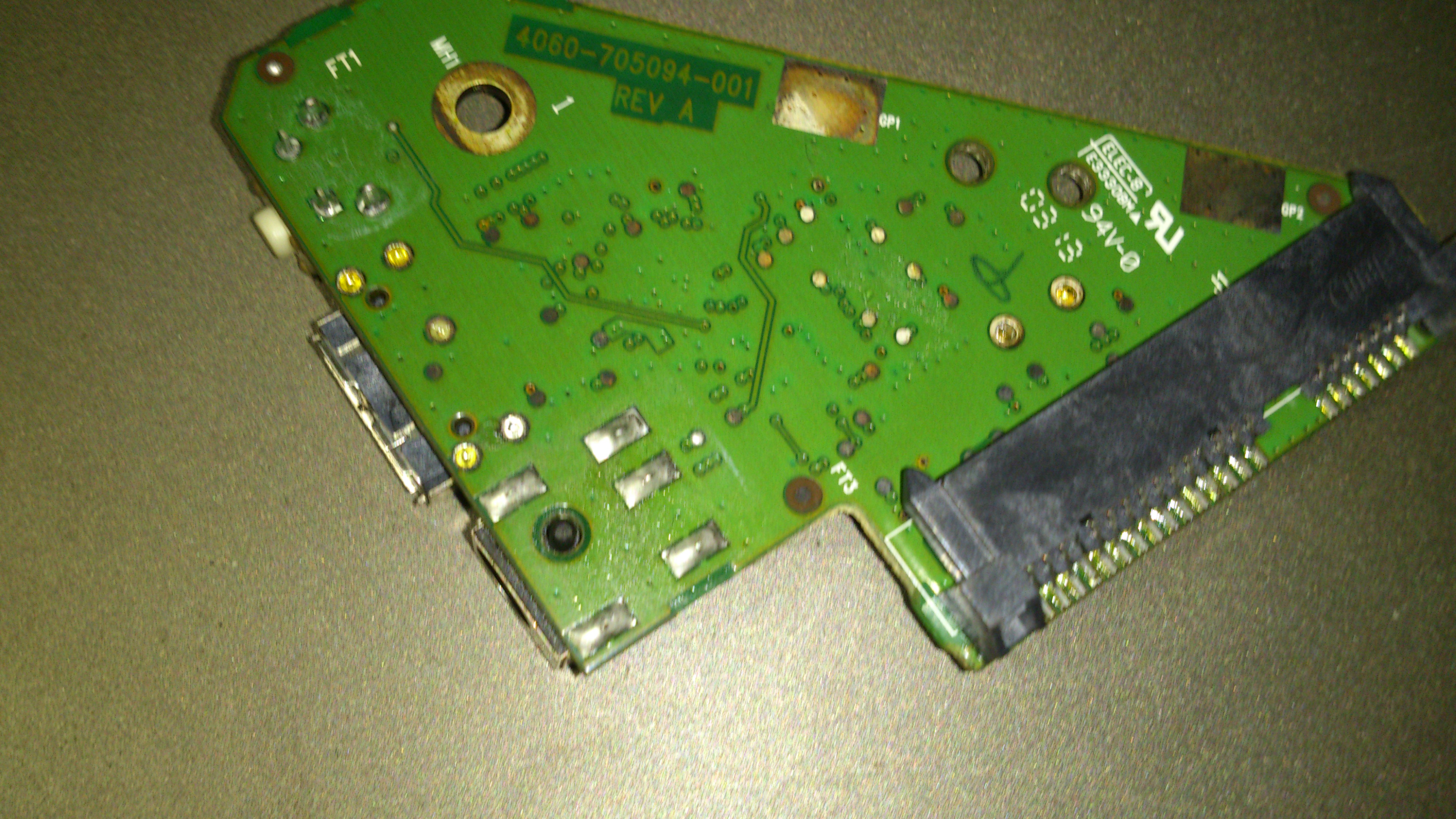

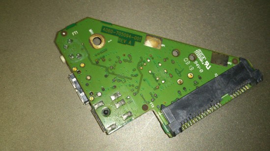

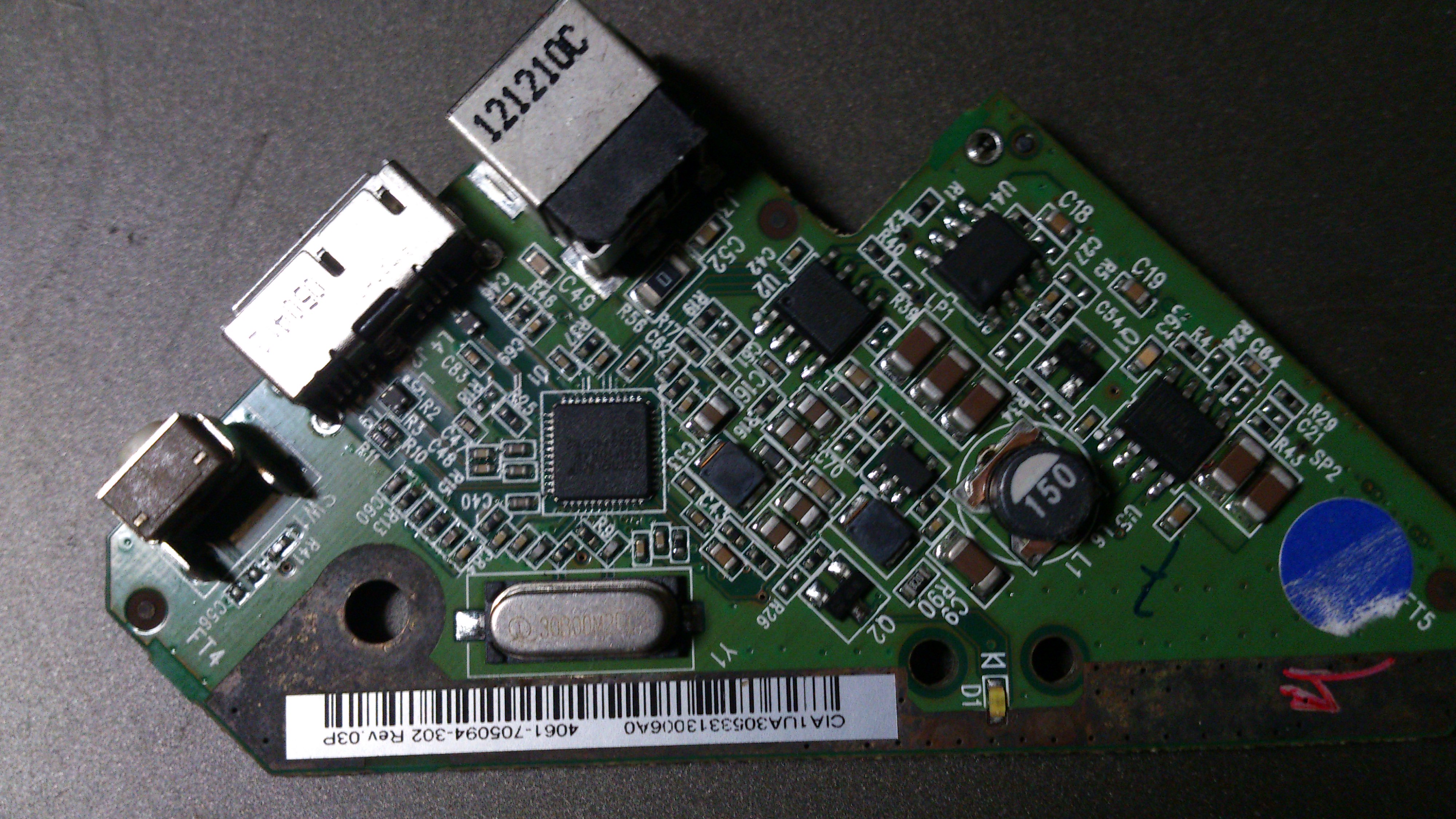

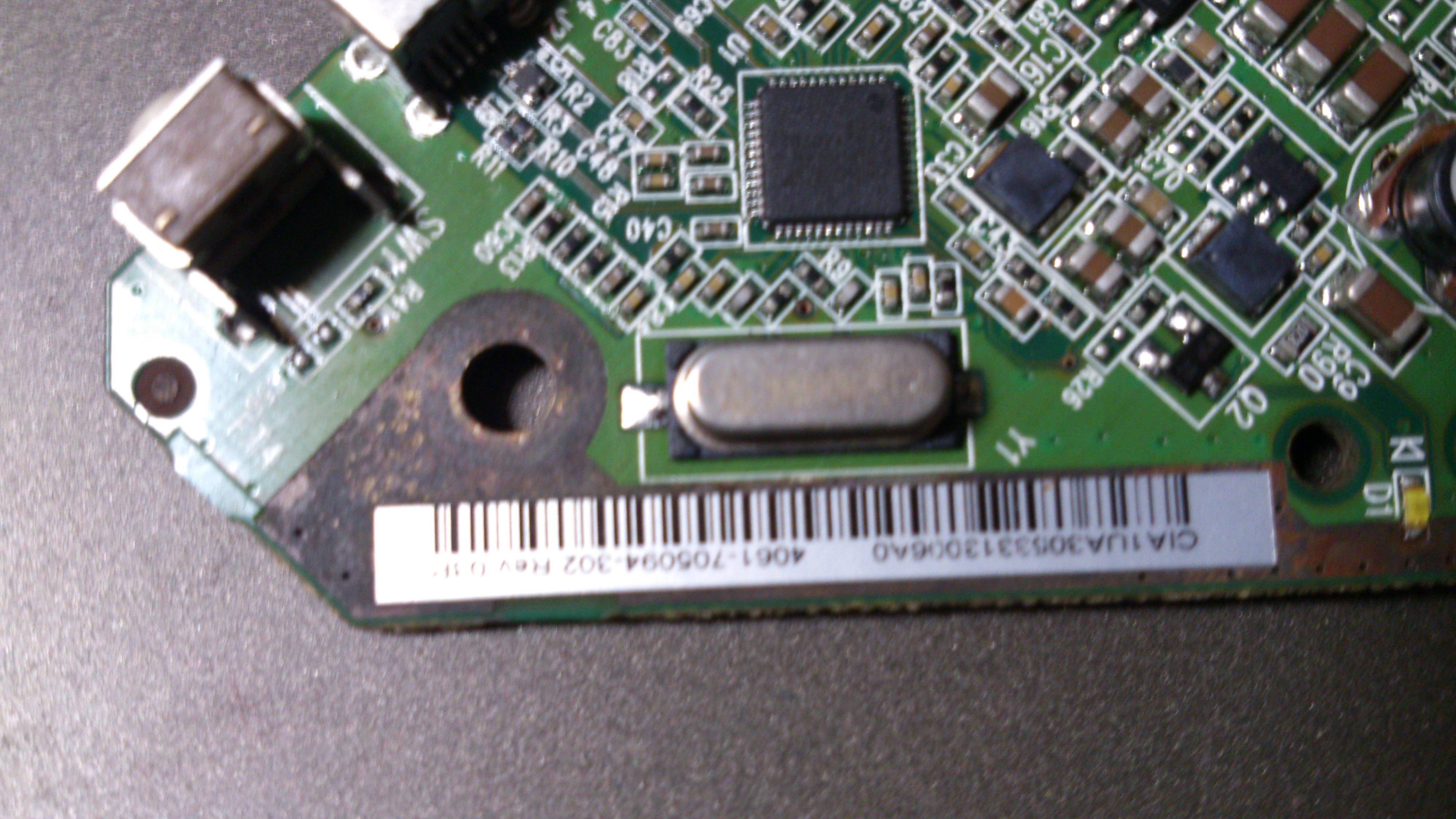

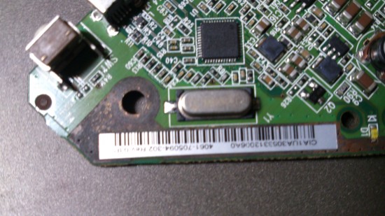

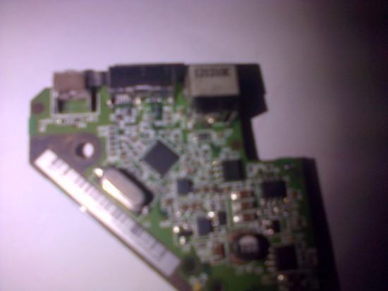

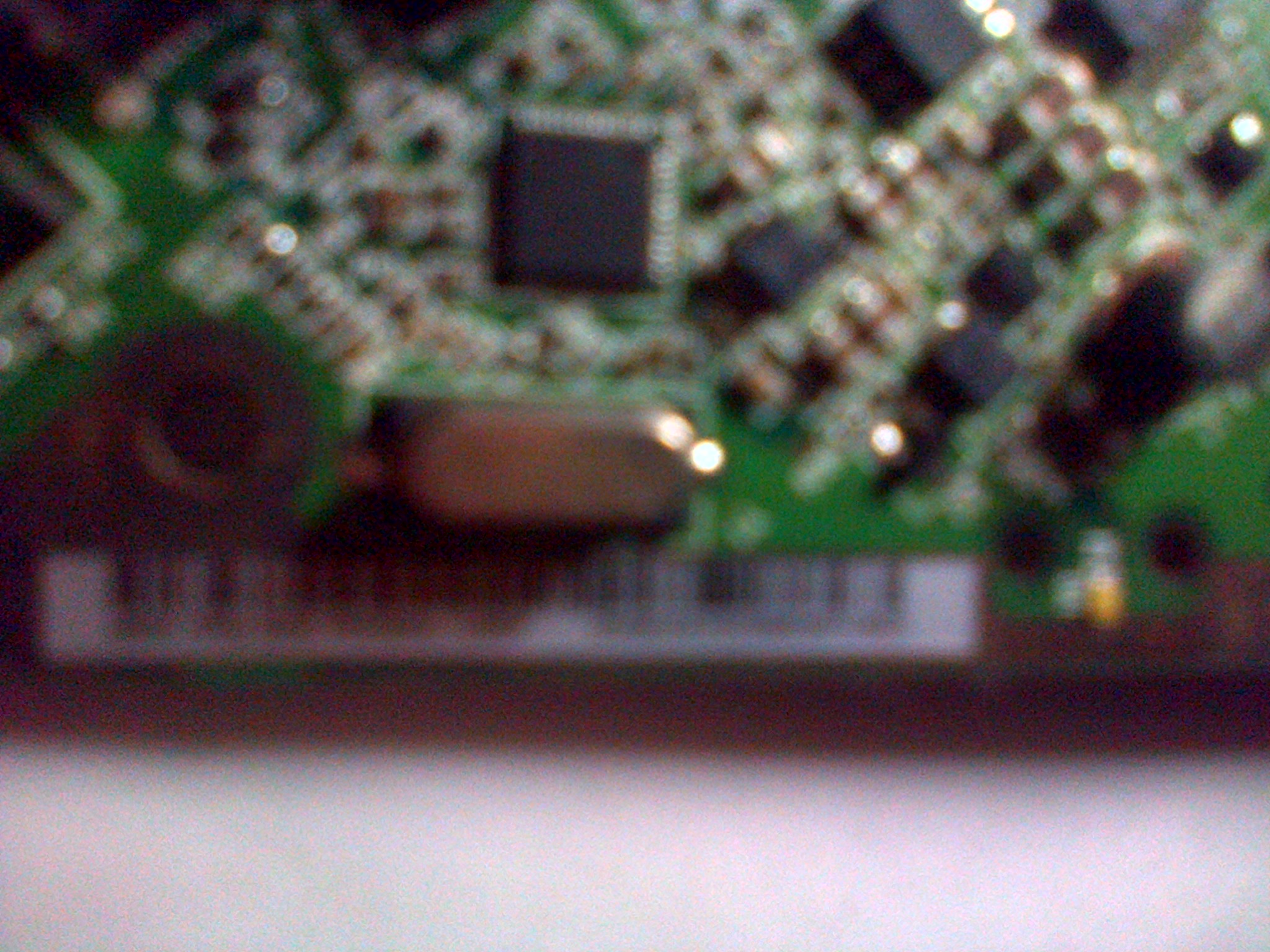

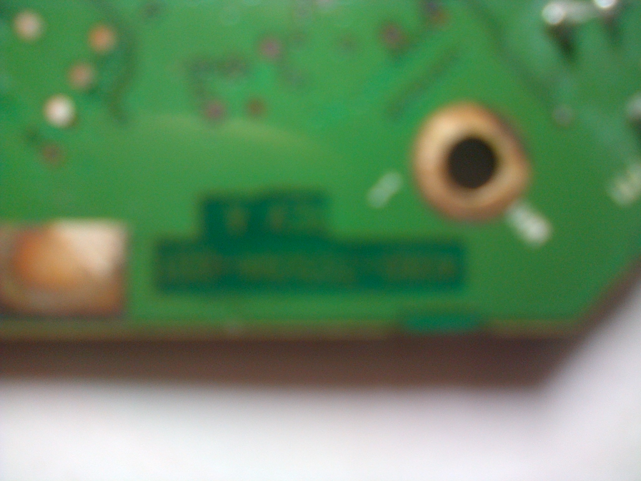

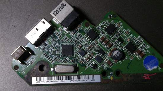

Anyway, here's some picture i took, i hope this one is better
Thank you in advance

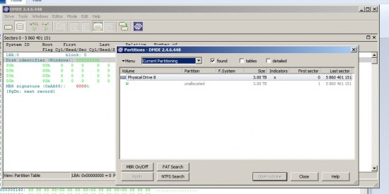

@mamamiaw, your Disk Management screenshot is showing a 3TB drive that is Not Intialised and Unallocated. This is suggesting that sector 0 is readable but may be encrypted.
Before you begin troubleshooting your original board, could you show us the contents of sectors 0 and 1 using the eBay PCB? You could use HxD or DMDE for this purpose. Select Mode -> Hexadecimal.

There are two numbers on the bridge board - one on the white sticker and embossed one at the back. These numbers are not the same. when you are buying the control board make sure that both these numbers match. The number on the back is the part number, so i presume the number on the front is related to the batch with specific encryption.
I had trouble with the bridgeboard of 1TB WD My Book couple of weeks back. I bought the control board over ebay, plonked it on the hard disk and got back every bit of data. Before buying the bridge board, I tried both test disk & photorec - nothing came out. The data is encrypted, but it is there.
' good luck.

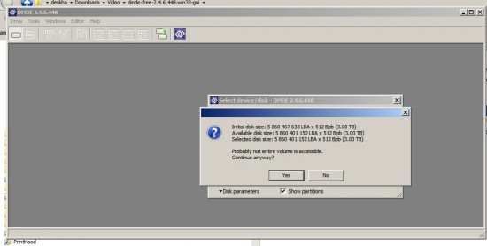

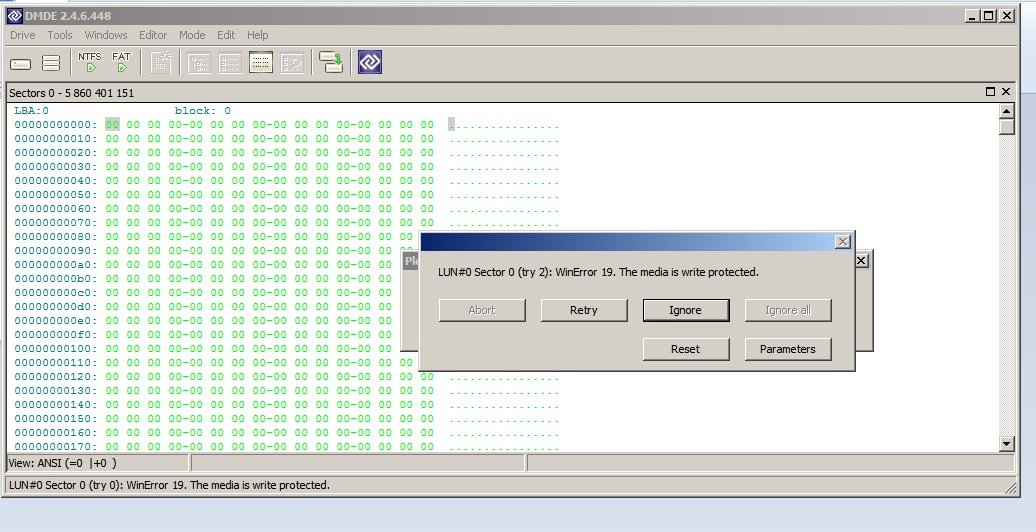

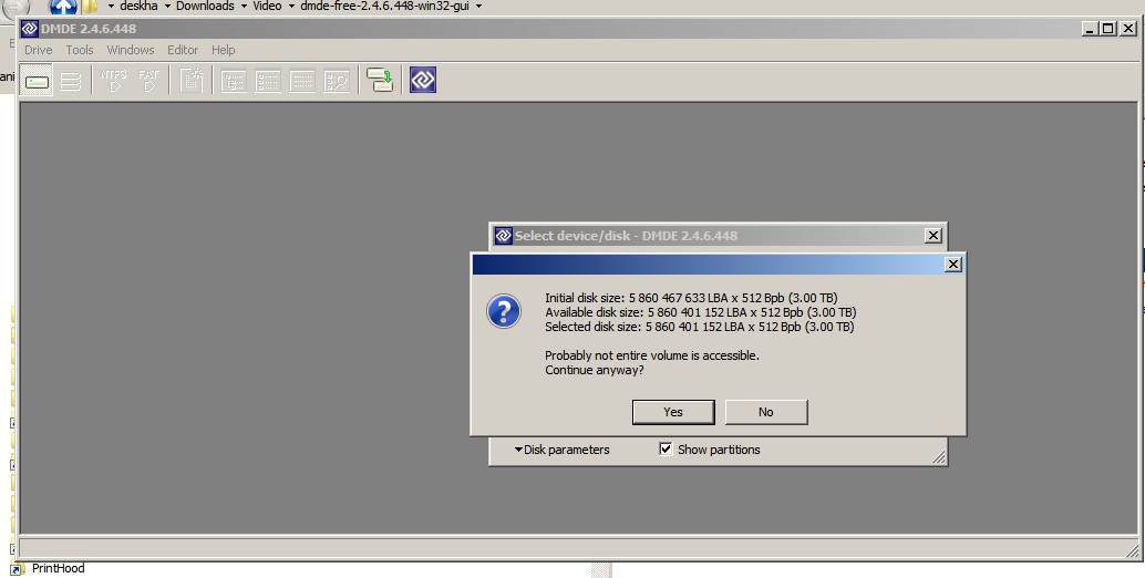

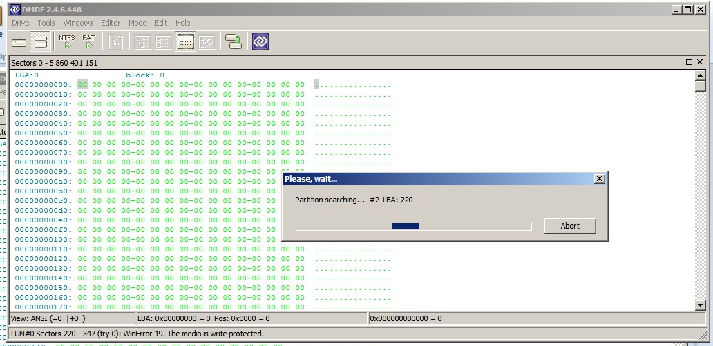

Sorry for the long long delay
I was sick

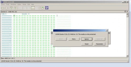

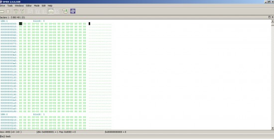

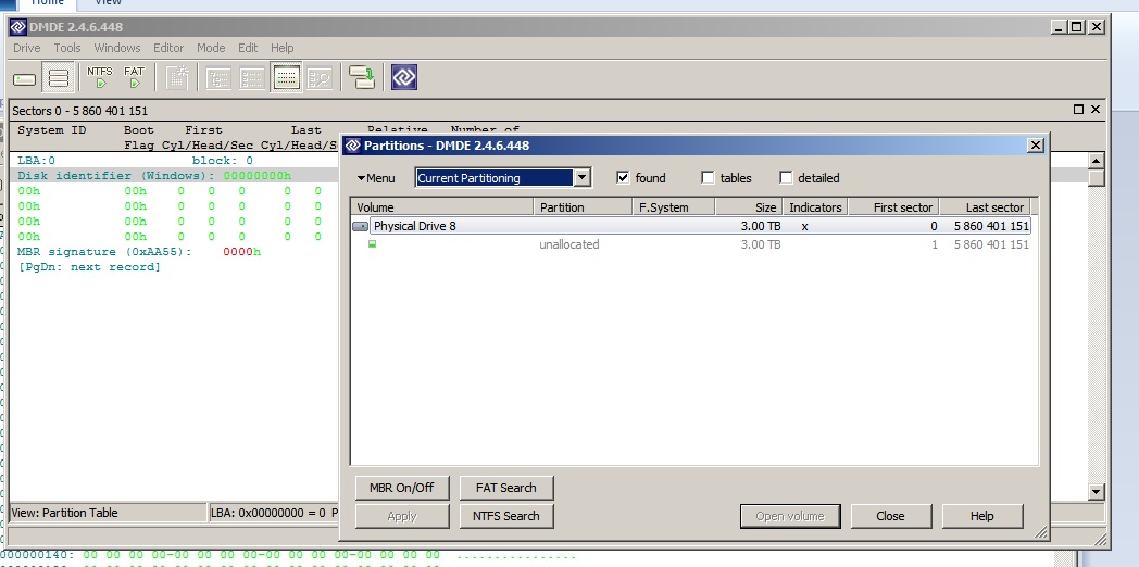

I've tried the DMDE
Here's my screenshot

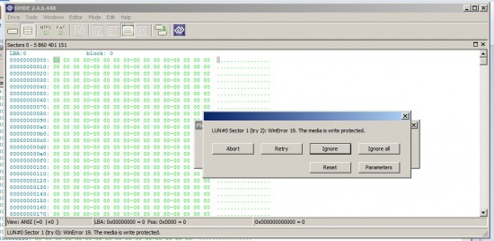

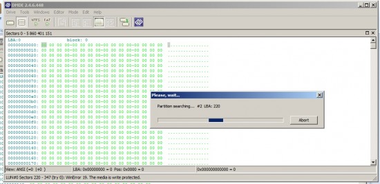

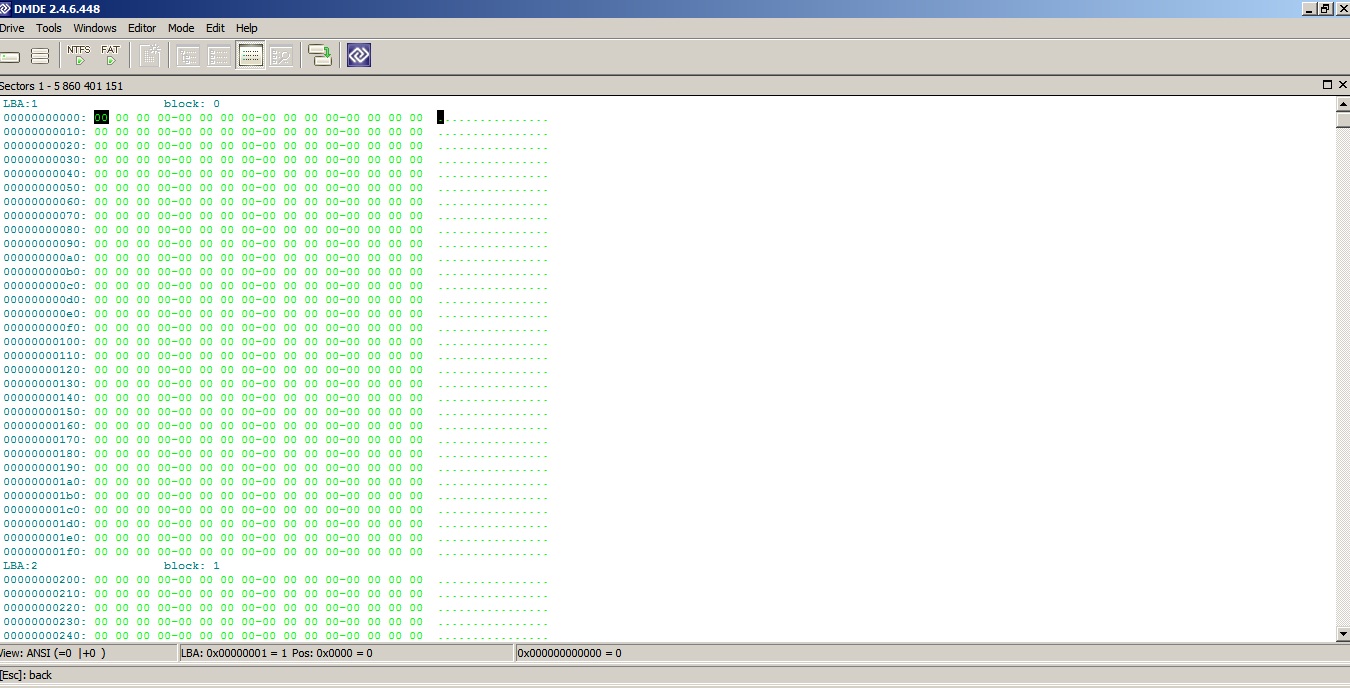

Then i got stuck here

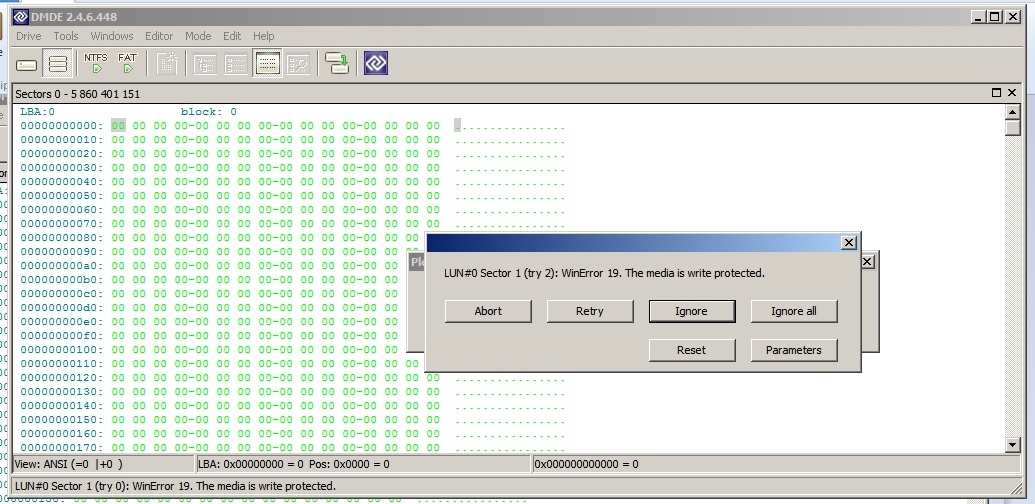

This is after i pressed close

I'm assuming your screenshots were obtained with the drive attached to the eBay bridge board, rather than to a SATA port on your motherboard. I notice that DMDE is reporting 5.8 billion LBAs at 512 bytes per LBA. Bridge boards for 3TB My Books are normally configured with 4KB LBAs, although this can be changed by WD's formatting utility.
I'm wondering whether your eBay bridge board was configured for a 2TB drive or smaller, rather than for a 3TB drive.

Hi mamamiaw,
If HDD is spinning, you can hear a specific noise from it. Do you hear it with faulty PCB, or noise comes only with a new PCB?
What written on power adapter's label? What voltage, current, polarity? You can take a picture of it too.
New PCB you trying to use, do you powering it up with that adapter?
Try to make a really good pictures of your new and faulty board.
Do it with a good camera, use enough light and disable digital zoom.
If your camera unable to take such pictures, then just scan PCBs with any scanner around. (Just place boards to the glass.)
The primary goal is to get a pictures with readable text marks from ICs and other components.
With that data, it will be possible for us to find, which voltage and on which points it should be on a faulty PCB.
For me it looks like PCB without power.
Then, you have to find a multimeter, and you should know, how to measure voltage and resistance with it. I (or somebody else) will try to guide you, on which point and what to measure.
But be careful. Any wrong move with multimeter probes, any short, and you can completely fry your PCB.
Do it on your own risk. If you not shure. And your data so important, maybe better to contact with professionals?

WD's 3TB My Books are intended to be compatible with Windows XP straight out of the box. This means that they need to be set up with an MBR partitioning system rather than GPT. Standard MBR partitions are normally limited to a capacity of 2TiB. However, WD circumvents this problem by increasing the sector size from 512 bytes to 4096 bytes, thus allowing for a maximum MBR partition size of 16TiB.
This means that WD may use 512-byte sectors for their 2TB My Books and 4KB sectors for their 3TB versions. If the bridge boards are otherwise identical (I don't know if they are), then the difference must be stored in firmware, either on the bridge board or on the drive itself. The bridge board has an 8-pin serial flash memory chip, probably at location U2. I suspect that this chip may contain a 512B/4KB "flag". The HDD, OTOH, has a reserved section at the end of the user area (on the platters). Notice that there is a discrepancy between the number of sectors reported by DMDE and the full native capacity of the drive. This area would be reserved for SmartWare.
FYI, this is the [Data Destructive] "Quick Formatter" tool that WD supplies for its external drives:
Using WD Quick Formatter to format external drives (Windows 8, 7, Vista, XP) or Mac OSX (Leopard, Snow Leopard, Lion or Mt. Lion):
http://wdc.custhelp.com/app/answers/det ... -vista,-xp)-or
The instructions are dumbed down, so they don't explicitly mention the sector sizes. Instead the user is given a choice of "XP Compatible" (4KB) or "Factory Default" (512B). IMO these descriptions are somewhat ambiguous, since 4KB is the default for 3TB My Books. (Why does WD think that all their users are dumb?)
As for voltage measurements, carefully measure the voltages at each of the pins of U4 (the dual MOSFET). Also measure the voltage on the pins of the coil marked "150" (5V DC-DC converter). Use a screw hole as the Ground reference.
