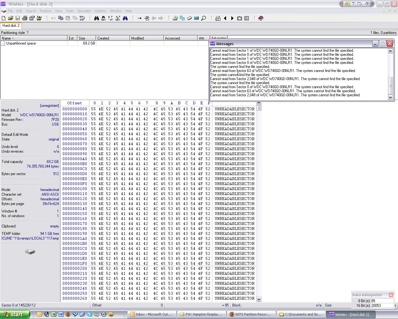

I did try winhex.... i am able to see the drive but everything reads as bab sector.
I have also tried GParted which notes that I must run chkdsk /f ...which when I try to run say "cannot open volume for direct access"

And that means.... absolute toast?

 Post subject: Re: HDD Shown as Local Drive - RAW 0 Bytes
PostPosted: May 21st, 2009, 23:05
Posts: 1517
Location: Mexico
Im think the first should be identified the problem, u can use MHDD or another ATA terminal software, to get the ATA registers, check passport if its identified Model, Serial Number Size, and send the read sectors comamands, then u get a guide about u problem
