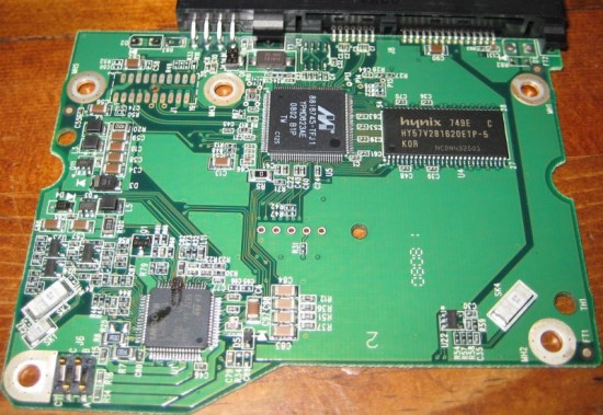

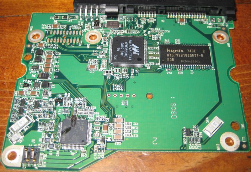

Hello All-
This is chapter one of my epic and disastrous HDD adventure. A crappy Antec power supply simultaneously roasted 3.5 TB across 4 drives in my media server, and now here I am. This first chapter deals with the following 1 TB Western Digital drive:
THE DEARLY DEPARTED
MDL: WD10EACS-00ZJB0
DATE: 17 APR 2008
DCM: HBRCHV2AAB
PCB: 2061-701474-600 01P XC 4H09 8CTQ M 0005380 8385
The chip labeled "smooth" (the spindle driver?) is burned. And also plugging the drive in and turning the (new) P/S on releases more magic smoke. So I bought a (so I thought) identical drive:
THE DONOR
(Recertified)
DATE: 04-SEP-2008
DCM: HARCNV2AA
PCB: 2061-701474-600 01P XC 4H09 4PLN M 0002360 8362
I swapped the logic boards, and plugged it in. The drive spins up but the bios does *not* see the drive, then after a few moments the drive spins down. The new board in the new drive works fine.
What should I do now? Maybe swap the old firmware chip to the new board? I know this is risky, so I just wanted some encouragement before I broke out the soldering iron. Are the PCB numbers close enough for this to work? Which numbers are "significant"? And I just screwed? If I am not mistaken, the dead drive has firmware "AAB" and the new drive has firmware "AA", so it's not surprising that it doesn't work.
Thanks for all your help in advance. Also feel free to make fun of me for not backing up. Doubling up 3.5 TB is expensive, but I have found that not backing up is emotionally worse.

Unfortunately without special tools there is not much you can do. The ROM is located in the MCU and contains adaptive information unique to that drive. You would need much more equipment than a soldering iron to move the MCU. Contact a professional if your data has value.

I guess the ROM being stored in the MCU is a change compared to slightly older drives? After reading some more internet and looking at pictures of other WD logic boards I just now re-examined my board and realized that there is no U12 to replace. Why have they done this?
I see that the MCU is a Smooth LL6284, just one number off from this one: http://i108.photobucket.com/albums/n24/klutzon/hds3.jpg
I don't mean to sound incredulous, it's just hard to give up so early.
And I guess that by specialized equipment you mean something expensive that can somehow read the control track information off the drive and re-create the unique control parameters?
EDIT: I see that the Smooth chip (burned) is the VCD, not the MCC. So is there still a chance?

MCU is a chip with a large M on it.
L6284 is a motor controller chip.

If was burned only the spindle controller, could be possible to solder another from same family and model of course without experience impossible , at some families on WD, the MCU was damaged too and even some times that damaged pass into the HDA directly to the preamplifier causing burned too so u need to check that or send to a DR Company

I have moved these MCU with only a soldering iron....as long as they are SOIC chips its not a problem. BGA is a different story.
Mini wave tip is your friend!
