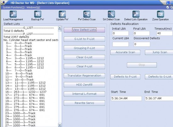

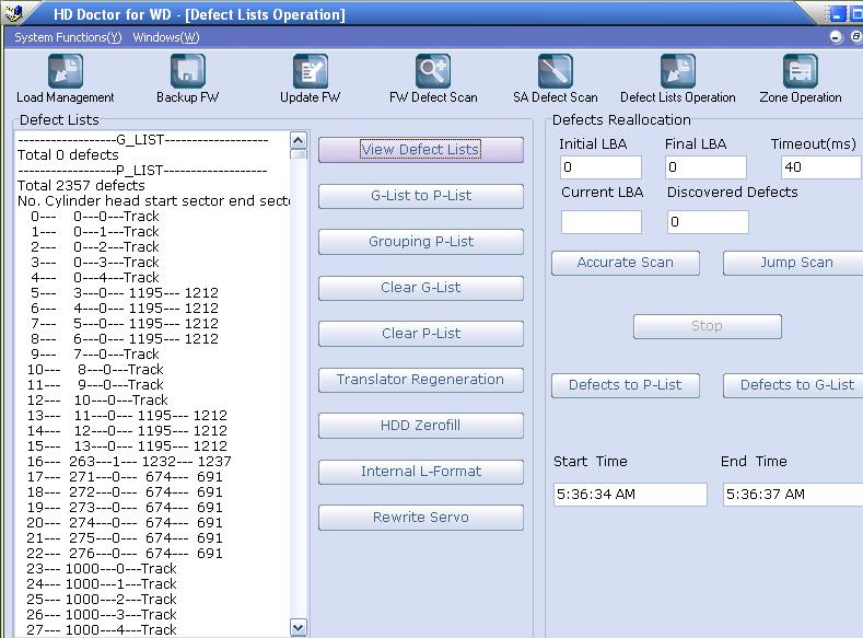

Hi Gurus!!!
Firmware Request (Salvation) for the WD4000AAJS-00YFA0 12.01C02.
FW scan showed Mod 032 (RBBLIST) read failed.
The drive's read/write test passed. Tried Regen but failed. I can read both G & P list but G list seems to be empty.
Thanks!!

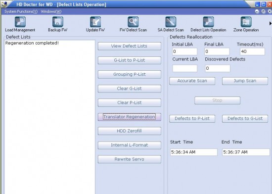

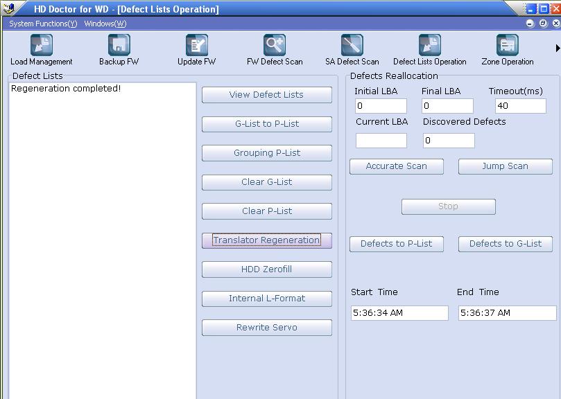

 Post subject: Re: FW Request!!! WD4000AAJS-00YFA0 12.01C02
PostPosted: May 16th, 2009, 7:53
Posts: 269
Location: behind the platter
When I tried to regenarate the translator, every 2 or 3 times, I'll get successfull message like attached, but still can't get to the userdata....
