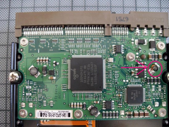

Have here one HDD ST3300620A (Seagate Barracuda 7200.10) PATA 300GB.
Attached and applied power.
Spins up and does irregular "whip-clunk".
HDD not detected.
Perusal of HDD shows damage on PCD, probably physical.
See image attached.
What part is this ? Is this a passive element (coil) ?
Can it be fixed by replacing or soldering.
Drive is only to spin for imaging and will be scrapped afterwards.
Thanks in advance, /pipedevnull
File comment: Damaged section marked with circle/arrow.

The PCB is fine , only some top part of the ferrite coil is cracked. Your problem is most likely heads or physical damage INSIDE. Call a pro.

Part number of Ferrite Coil is unknown, no ST3300620A to salvage at the moment.
Is this an actual ferrite or just an air coil in enclosure ?
If it is a ferrite coil, the main section of the housing is still available.
So soldering should probably fix this, the housing itself appears to be commonly employed plastic/ceramic with no significant electrical properties.
CF: "internal damage" ... The drive was _NOT_ dropped, jarred, jostled etc.
The damage very probably results from a second drive's screw scraping over the element.
NO internal damage to be expected.
Any suggestions to potential problems related to specifically this PCB-component ?
/pipedevnull

You are wasting time. If the coil was damaged or not working, the drive won't spin at all. Internal damage can happen anytime anyway.

Again: coil appears intact, the solder connection is ruptured.
What's the part number ?
What coil ferrite or air-coil ?
/pipedevnull

These coils cannot be bought easily; you should take one from another Seagate.
Its a ferrite coil, not air-coil.

Haha. - Open Drive.
Yes, indeed. If it need be, I'll open the drive in the Clean-Box I happen to have here.
Probably just by accident it appeared at some time in the past.
I somehow cannot remember - maybe I was abducted by aliens, you know :D
I happen to have repaired quite a few things in my life ... not only harddisks,
but that is of no interest.
Coming back to the drive.
Coil reconnected, drive spins beautifully and is accessible via a Tableau eSata Bridge.
Addressing sectors etc. is no problem.
Data delivered is reproducible.
Next Question:
What actual function does this coil (cf. image at beginning of post) have circuit-wise ?
Does anyone have reliable information about the characteristics of this coil in operation ?
Any pointers to addtl. documentation, circuit-diagrams or the like are greatly appreciated.

I guess this coil is part of the power supply for preamp
PS: You got really lucky
