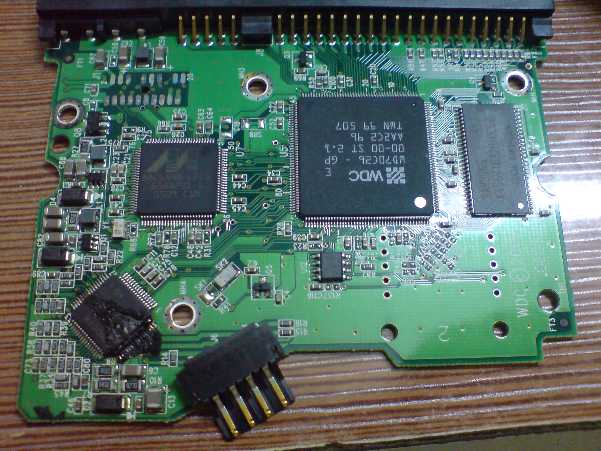

hi.
i have a
model: wd2500jb-98gvco
dcm: dsbhctjah
pcb no: 2060-701265-001 rev a the board is burnt...
i have donor drive
model:wd2500jb-oogvco
dcm: dscactjah
i have salvation docotor and comass.
i copied the rom file from the good drive and wrote it to the deffective drive. it is spinning but clicking. it is not coming to ready. any idea? i need the data on the drive.

I don't think I've ever seen a physically burned ROM, although it's certainly possible.
Are you sure we are talking about the ROM and not the motor IC? A photo would help . . .
Adaptives on the donor may be different, e.g. the head map might not match, which would cause clicking.
OTOH, anything that would destroy a ROM chip almost certainly would have killed the preamp circuit as well. If so, this would not be an easy recovery . . .

Post a photo of the component side of the PCB.

this is the board...

Thats the smooth chip that is burnt, not the rom.
By overwriting the rom you just destroyed your chances for a successfull recovery.

Q5 also seems k.o. . If Rom overwritten - and don't know why - only with very special skill will be possible to recover data. Also, in this scenario, I suspect some preamp problems too... Tough case. Just curious, why work with the ROM?
