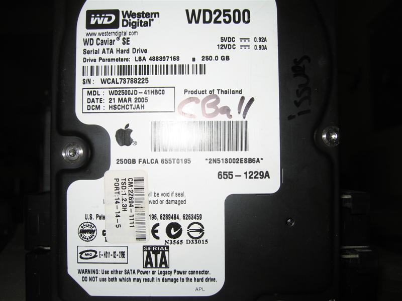

 Post subject: WD Eangle 200JD-55HBB0 FW in NEED

Isn't that Falcon?

It's Eagle. I think Falcon has not been released
Please provide FW revision
I have a handful of Falcon drives in the basement... As I recall most if not all of them are Apple branded.

It's Eagle.
And the right model is WD200JD-55HBB0
F/W 08.02d

Kyrios,
I think you mean WD2000JD . . .
I'm wondering how do you distinguish Falcons of Eagles
Don't tell me "Acelab said take two letters from the model and use our fancy table" 'cause they wrong
 Post subject: Re: WD Eangle 200JD-55HBB0 FW in NEED
PostPosted: May 20th, 2009, 22:56
Joined: June 8th, 2006, 19:44
Posts: 3144
Location: Atlanta, GA
I've seen the model name embedded in FW modules. That ought to settle it, if you can view it . . .

Well, I stand corrected. Apple branded drives typically also carry an abbreviation of the family name with an A or S at the end (i.e. HAWKA, MERCA, etc.) These particular drives are labeled FALCA but I guess Apple just labeled them incorrectly, as the firmware reveals they are indeed Eagle. I've never seen it be incorrect before, so that's what I was going off of. I've also seen a few websites describing xxHBxx drives as Falcon, so I wonder where they all got the wrong info from?
