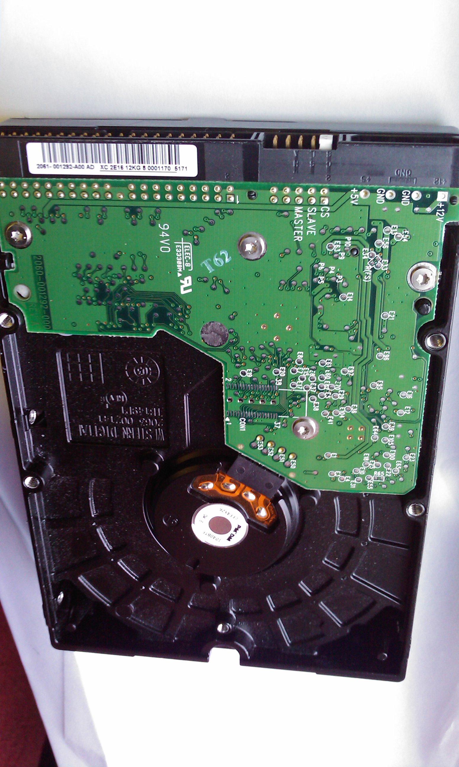

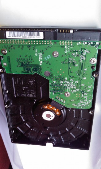

hi guys,
all help gratefully recieved here,i'm impressed with this forum!
attached is a pic of my pcb.
b.

 Post subject: Re: western digital reverse powered. help!
PostPosted: March 13th, 2009, 10:17
Posts: 1852
Location: Belgium
In the upperleft of the picture you see a number engraved in the pcb.
Try to buy a pcb with same number and change the 8-pin eeprom with the original one.
If you drive is clicking then, then 99% sure heads or preamp is damaged.

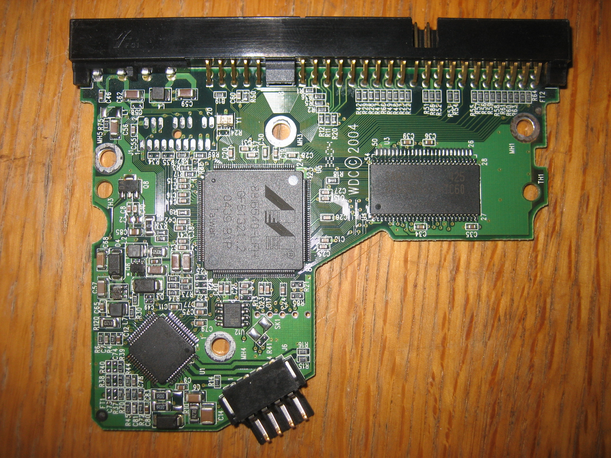

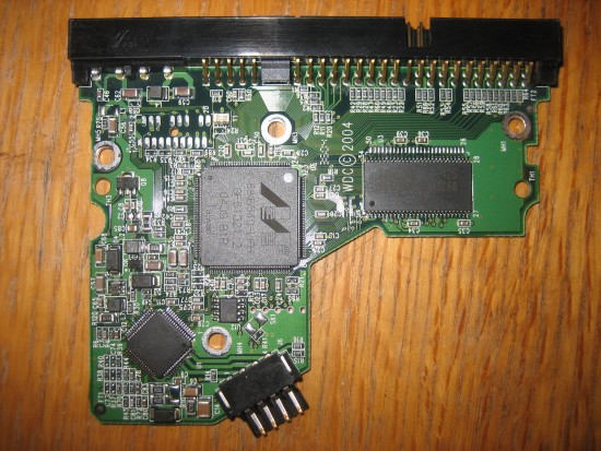

PostPosted: May 14th, 2009, 15:10
Joined: March 11th, 2009, 10:17
Posts: 6
Location: england
dear all,
component side of defunct pcb as requested.
PostPosted: May 14th, 2009, 16:45
Posts: 1466
Location: Europe, Hungary
You need to check the D3, D4.
If not short any of these, the problem is more bigger.

Location: england
d3 fine .
d4 no continuity!
can i just bridge it?
also is everything ok with the six pin component just below d4?it looks "crispy".
PostPosted: May 27th, 2009, 5:51
Posts: 1852
Location: Belgium
They should give NO continuity; if they do, something is wrong (or they could be connected to an inductor in parrallel).
These are diodes. If you hesitate, thake them out of the circuit to check.
In any case, never bridge them, since they are part of the power-supply.
In any case, i think this is way over your possibilities. I would suggest a pro.
If you do continue on your own, you are things could go terribly wrong. :?
PostPosted: May 27th, 2009, 6:49
Posts: 6
Location: england
ah sorry, pardon my ignorance.i thought they were thermal varistors-as that is what the previous posts were relating too.
in which case d4 is fine but d3 is showing continuity.
i'm not going pro as the data is not important enough to spend the money on.
its true i am attempting something above my current ability,but how else will i learn?im ok with a soldering iron and have a good multimeter,and it doesnt matter if it all goes terribly wrong.all i need is good advice.
any help received with thanks.
PostPosted: May 27th, 2009, 7:20
Posts: 927
Location: uk
Looking at the photo the component (with 6 pins?) located between c57 and d3 either looks fused or is it covered with a bit of sponge insulation?
