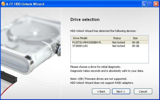

Joined: October 4th, 2008, 2:59
You can try below product. I guess license is per usage. If you wish to unlock with erase, it is free by one of their tool.
Your model is listed as supported in their website. Hope this helps. http://www.hddunlock.com/drives/fujitsu/

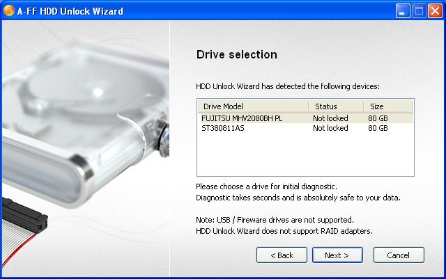

Joined: July 15th, 2008, 1:50
Posts: 95
Tried Hddunlock wizard , but since disk is not initilized in windows , wizard is unable to find it.
It is connected to native SATA por on Asus A8N SLI deluxe motherboard is well getting detected in BIOS & Disk Management but wizard is unable to locate it.
Now what to do? Can someone from AFF or HDDunlock help?

PostPosted: June 2nd, 2009, 7:59
I am afraid it may due to sata controller issue. Why don't you try intel chipset mother board instead of Nvidia? And it has to be connected as master. i have done it before. Refer to attached screenshot for same model.
Hari
