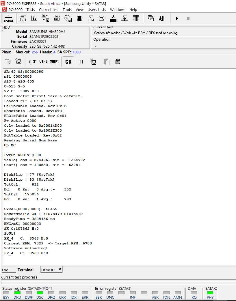

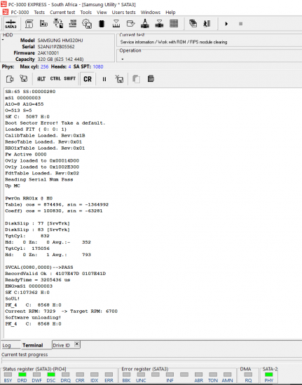

 Post subject: Re: Samsung HM320HJ BSY, no spin
PostPosted: November 3rd, 2020, 4:46
Posts: 1038
Location: South Africa
Thanks guys, FIPS issue indeed. Seems PC3K can resolve the issue and then saves a *fixed* version of the ROM. I wrote that back to the PCB and it's sorted. First time for everything. Gracias.
